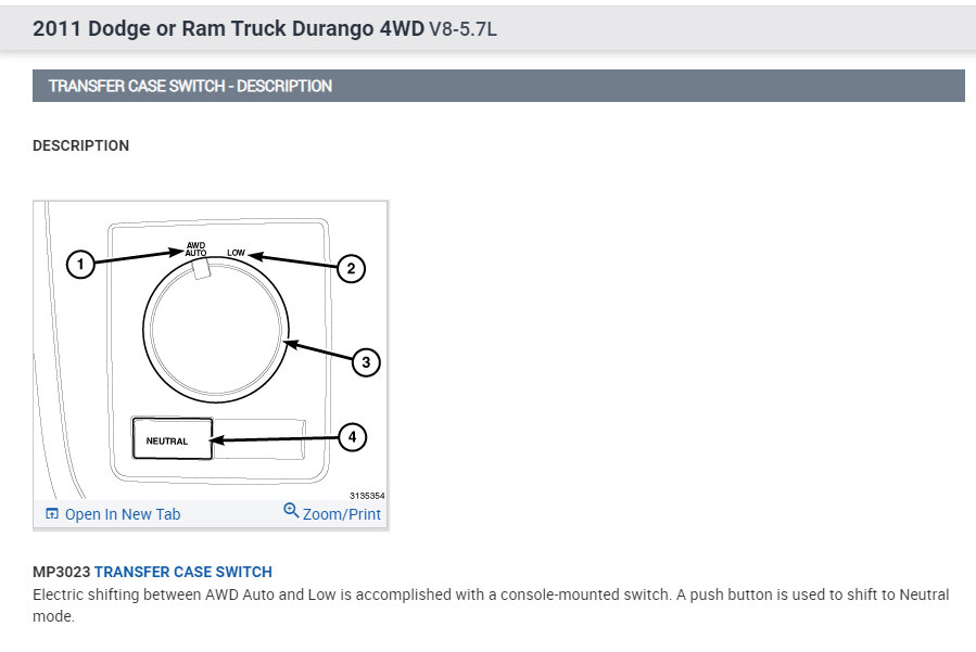

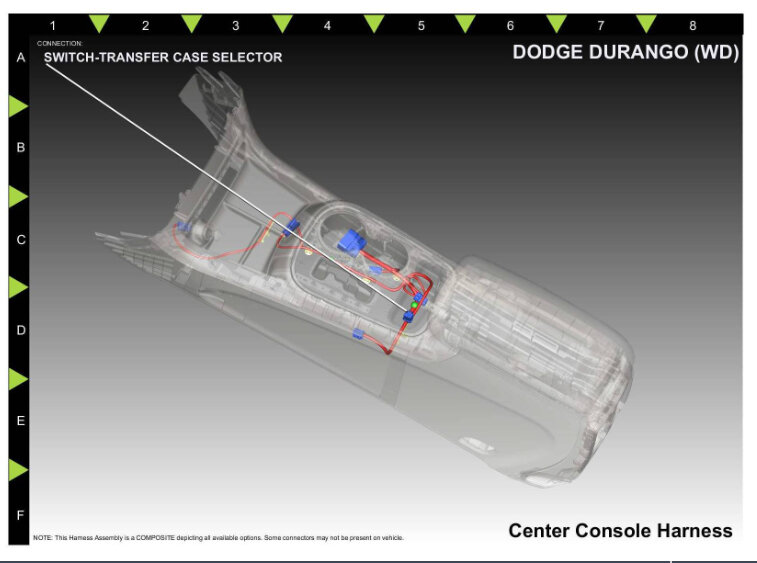

If the switch got wet, it may have shorted. Especially because of positioning, a drink could have damaged the switch.
What I would recommend is to first remove the switch and make sure everything is dry. You should be able to use a flat screwdriver to gently pry up on the switch panel to remove it. When you do this, make sure you use a rag or something to prevent damaging the vehicle.
I attached pics below. Let me know if that is where your switch is located. There were two different designs.

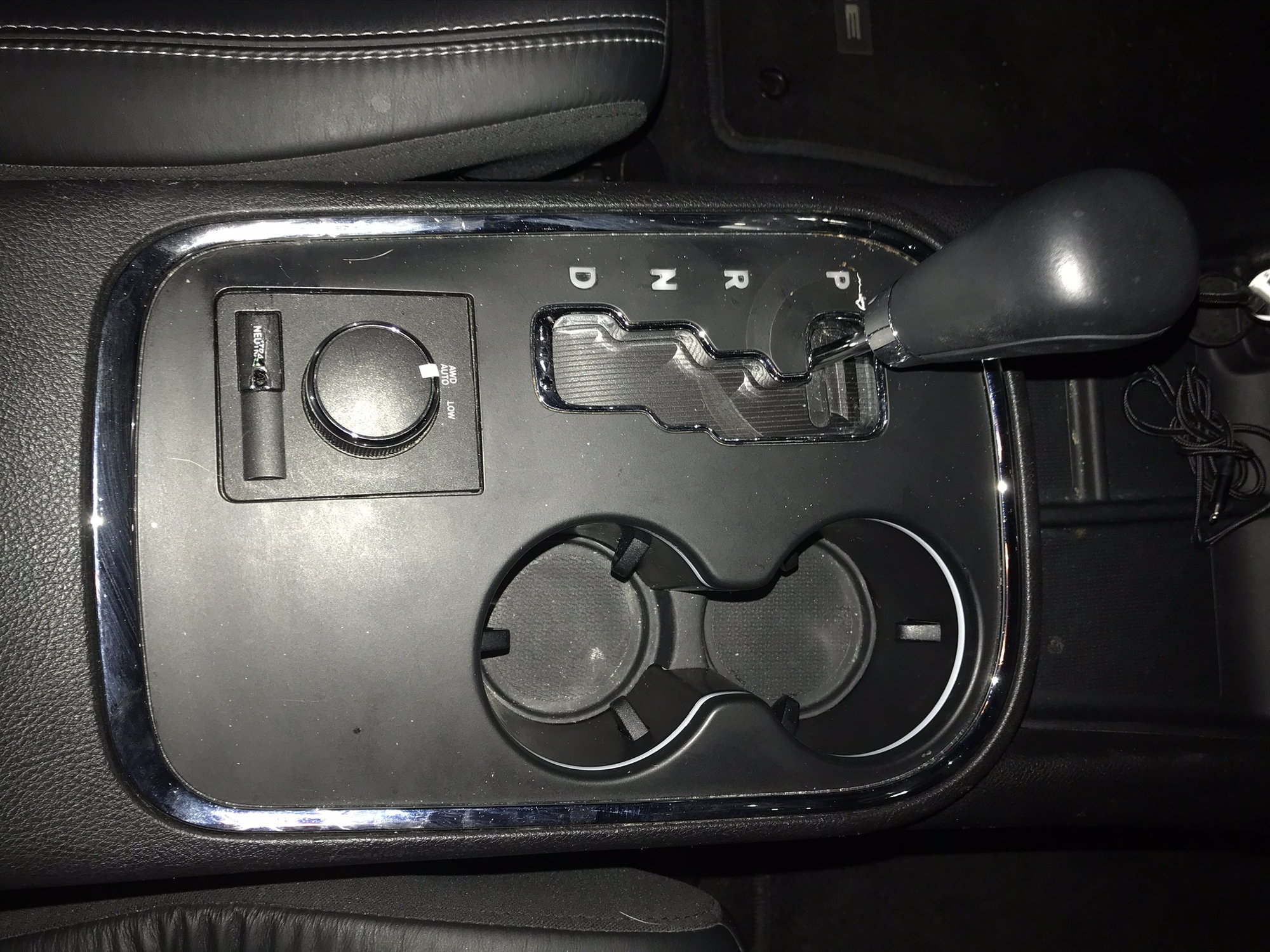

Thanks so much for replying to my question. I really appreciate it. So here is a pic of where my transfer case switch is located.
Jun 2, 2023 at 2:38 PM
  • 110,244 POSTS
You are very welcome. Remove the switch and check the connector to make sure nothing is wet. Let me know what you find.
