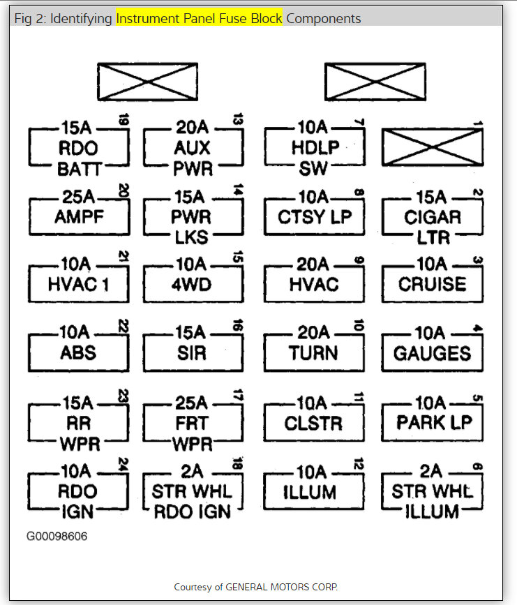

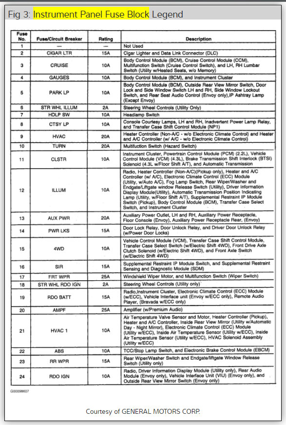

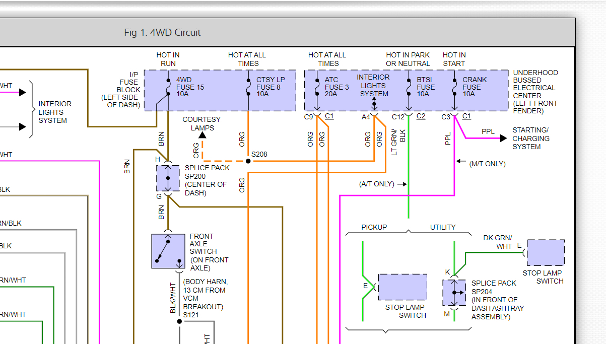

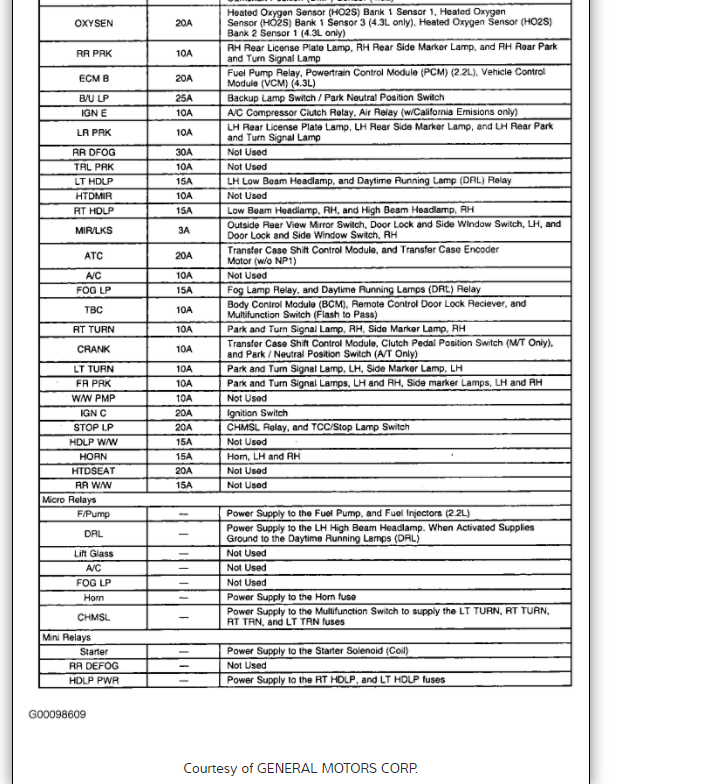

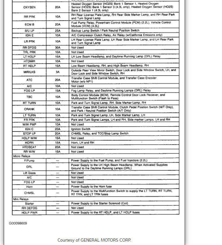

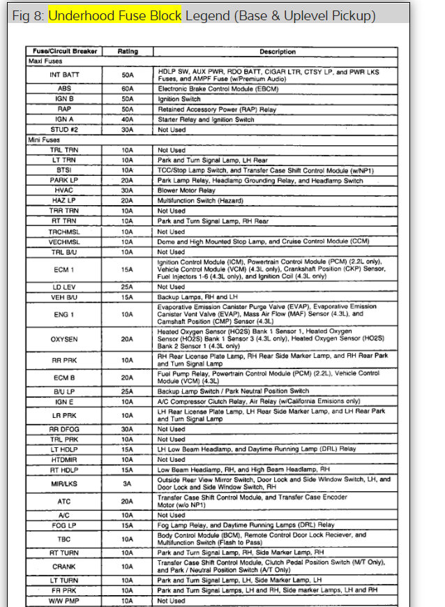

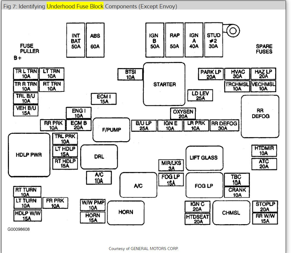

The first thing we need to do is check the fuses.
here is a guide to help and the fuse locations as well:
Here are the fuses that run the 4wd system. Check out the images (below). Please let us know what happens.
Dec 20, 2022 at 2:28 AM
