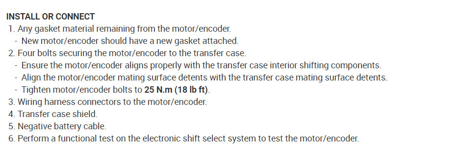

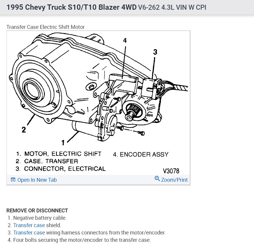

Just bought a 95 s-10. The first time I put it in Lo 2, it got stuck. I finally got it back to neutral and Hi 2 and Hi4 shift okay. I am afraid to put it back into low to. Any suggestions?
Jul 6, 2009 at 11:52 PM
RACEFAN966
  • 5,029 POSTS
Ok tell me what do you mean got stuck. Did the stick get stuck in 4 low or when shifted out of low it wouldn't change settings. If not manually shifted the transfer case actuator is bad and needs to be replaced here is the location so you can check it out. Check out the images (Below). Please let us know what happens.
