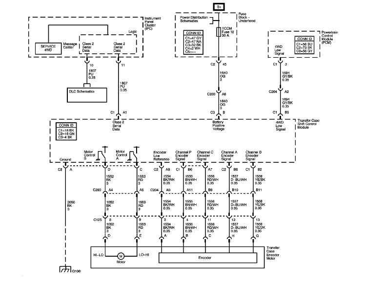

i checked the shifting motor it is working fine. i was told it might be the shifting fork, if so how do i get it out?
Jan 5, 2019 at 12:42 PM
Good morning,
How did you check the shifting motor?
does it work when you command 2 or 4 wheel drive?
Did you verify power to the motor with commands from the switch?
found this TSB for the fork
In order to replace it, the case must be removed and disassembled to access the fork.

Replace the damaged mode fork. Refer to Transfer Case Disassemble and Assemble in Service Information (SI).
- H2 - Replace with P/N 19180821.
- H3 - Replace with P/N 19180438.
