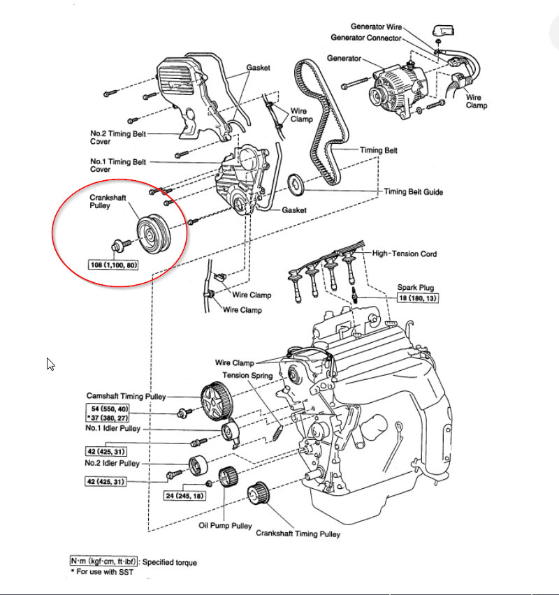

Have tried and tried for weeks to get the bolt off but still am having no luck! Any ideas?
Please!
Jan 1, 2021 at 12:37 AM

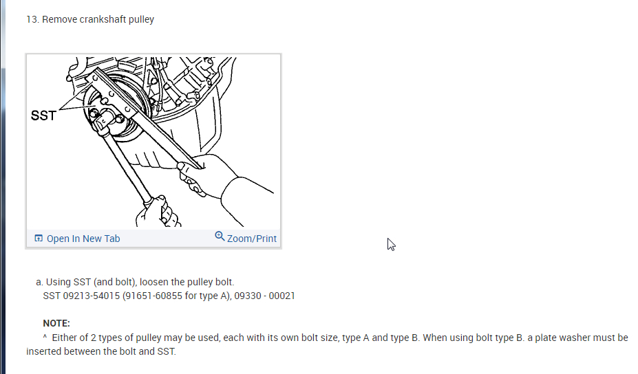

Are you using an impact air gun or trying to remove by hand? If you are removing it by hand, I attached below the instructions needed to remove it. You will need to use a holding tool of some sort just to hold it in place when trying to take it out.
If you are using an impact gun then make sure you are using a 1/2 inch tool because 3/8 or 1/4 is probably not strong enough.
Take a look at this material and let us know what you have tried so far and we can go from there. Thanks
