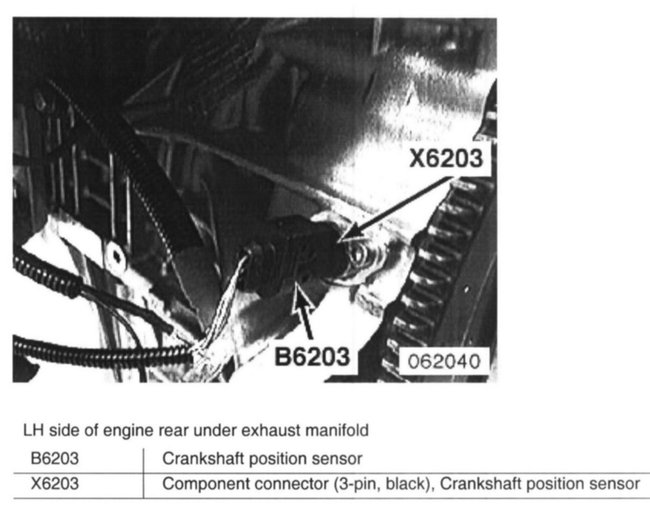

Can’t find crankshaft position sensor.

The sensor is on the left side rear of the engine under the exhaust manifold. Take a look at picture 1.
Let me know if that helps.
