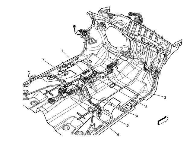

Where is the shift interlock Solenoid located?
180,456 MILES • 2.0L • 4 CYL • AUTOMATIC
MSELLIE7650
How do I remove and replace it? The car listed above is an LS model.
Dec 30, 2022 at 8:39 AM
  • 55,816 POSTS

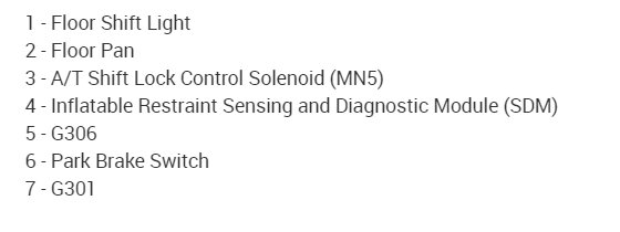

The shift interlock solenoid is down by the shifter near the shift gate. Check out the diagrams below to see what I am talking about. Check out the images (below). Please let us know if you need anything else to get the problem fixed.
