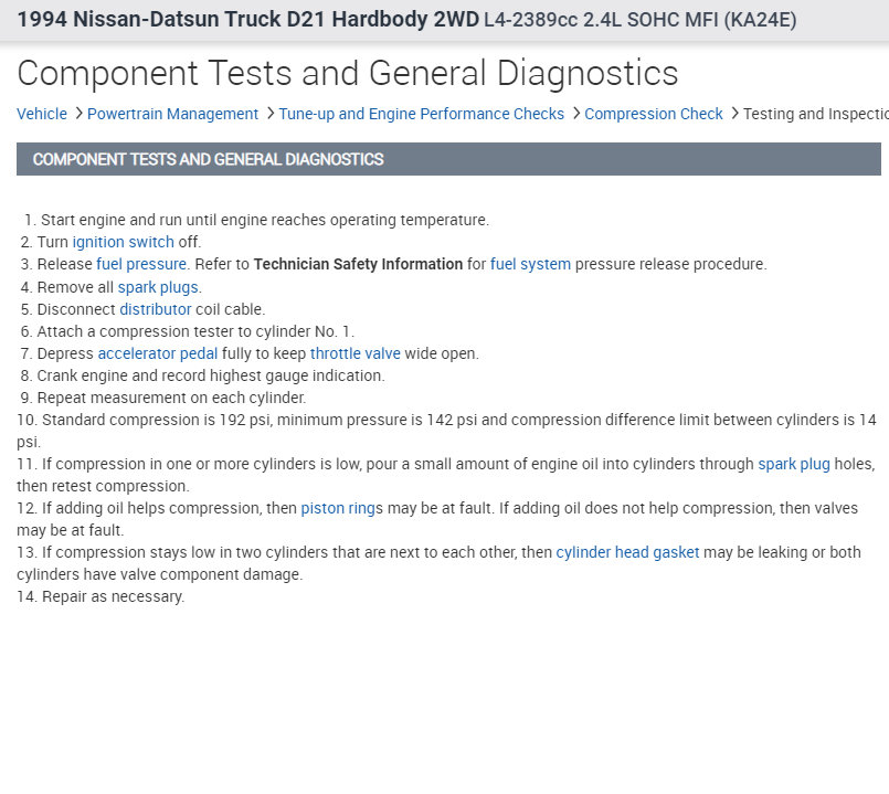

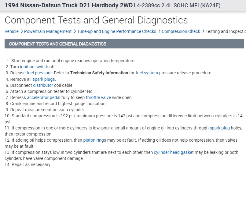

Generally speaking, an engine will need spark, fuel and compression to start. Let me know what you find out on the compression test.
The standard compression for this engine is 192 PSI. The minimum is 142 PSI. The maximum difference between the highest and lowest cylinder should not be more than 14 PSI.
