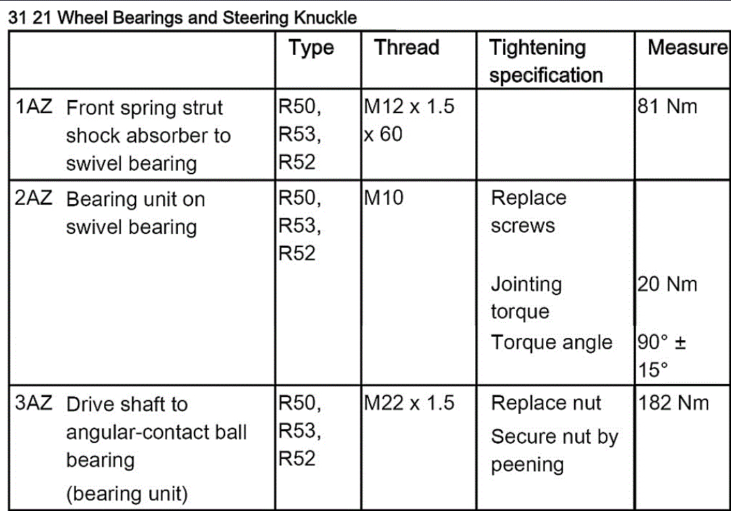

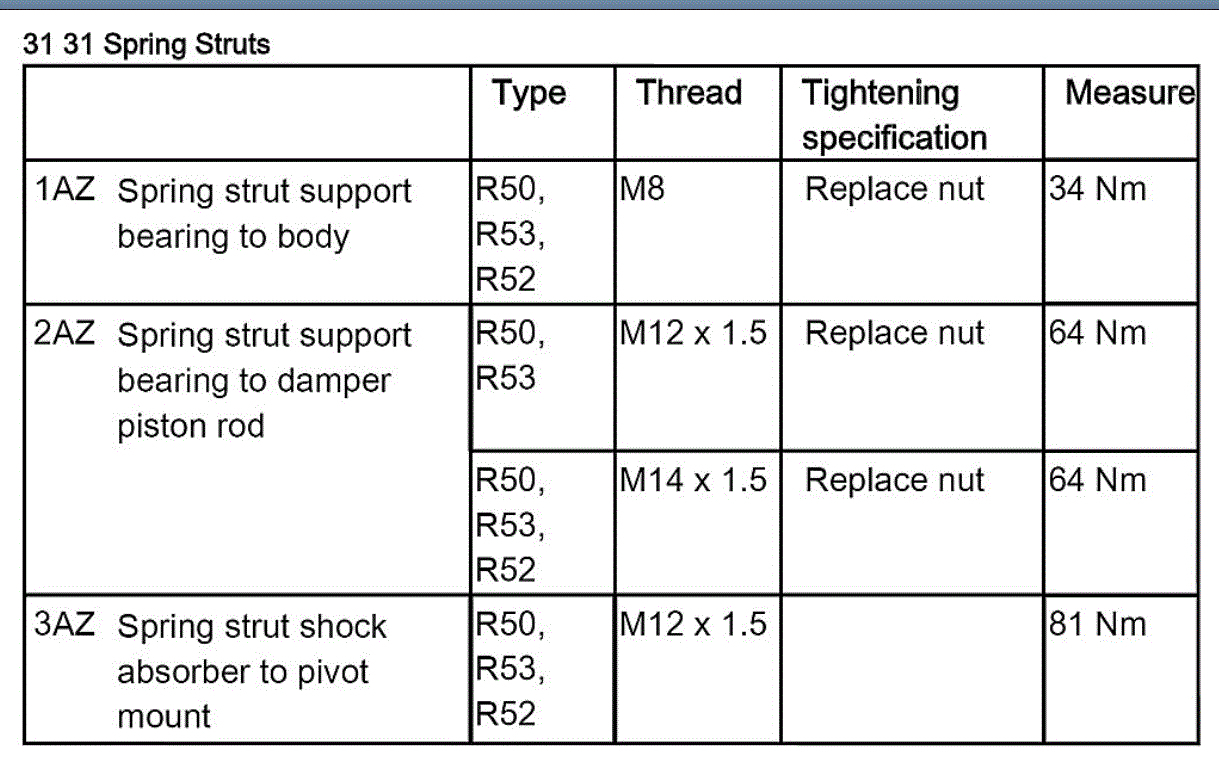

I put a driver side front strut on the passenger side not realizing until to late. Can I leave it there? I got the brake line attached okay even though the mounting tab was backwards. My first time installing and it was kinda hard for me.

Honestly, I would recommend installing the correct one. I believe the angling of the mounts are different which can cause alignment issues and failure. Also, there is a chance that the differences can allow the tire to rub the coil spring. I have to be honest, I'm impressed you got it together.
_______________________________

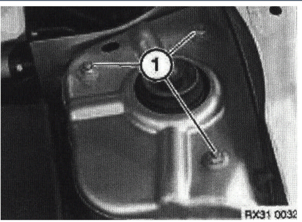

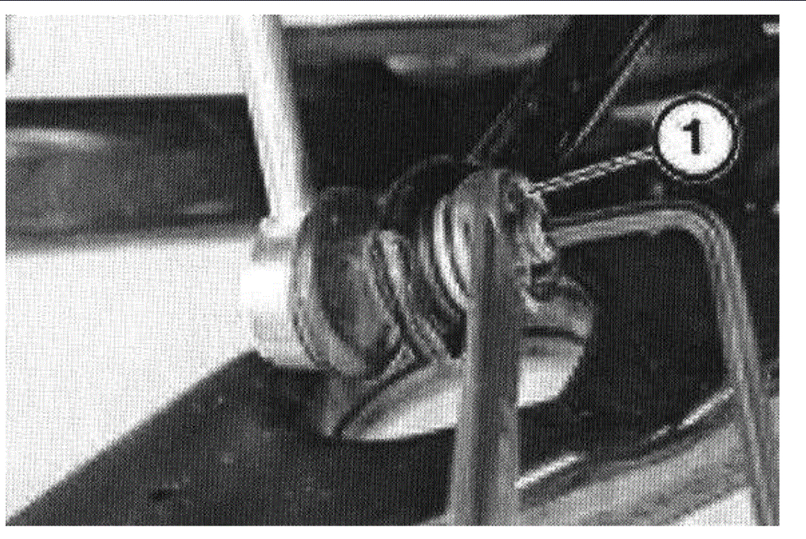

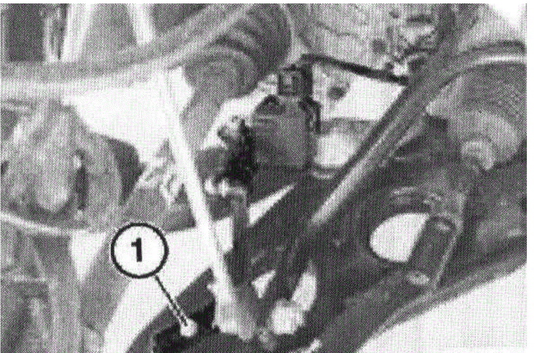

Here are the directions specific to removal and replacement. I'm adding them since you indicated this is the first time doing it. Check through to make sure nothing was missed. The attached pictures correlate with the directions.

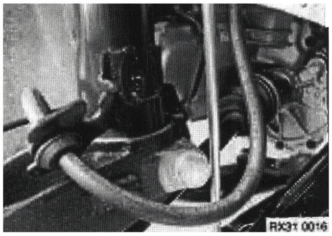

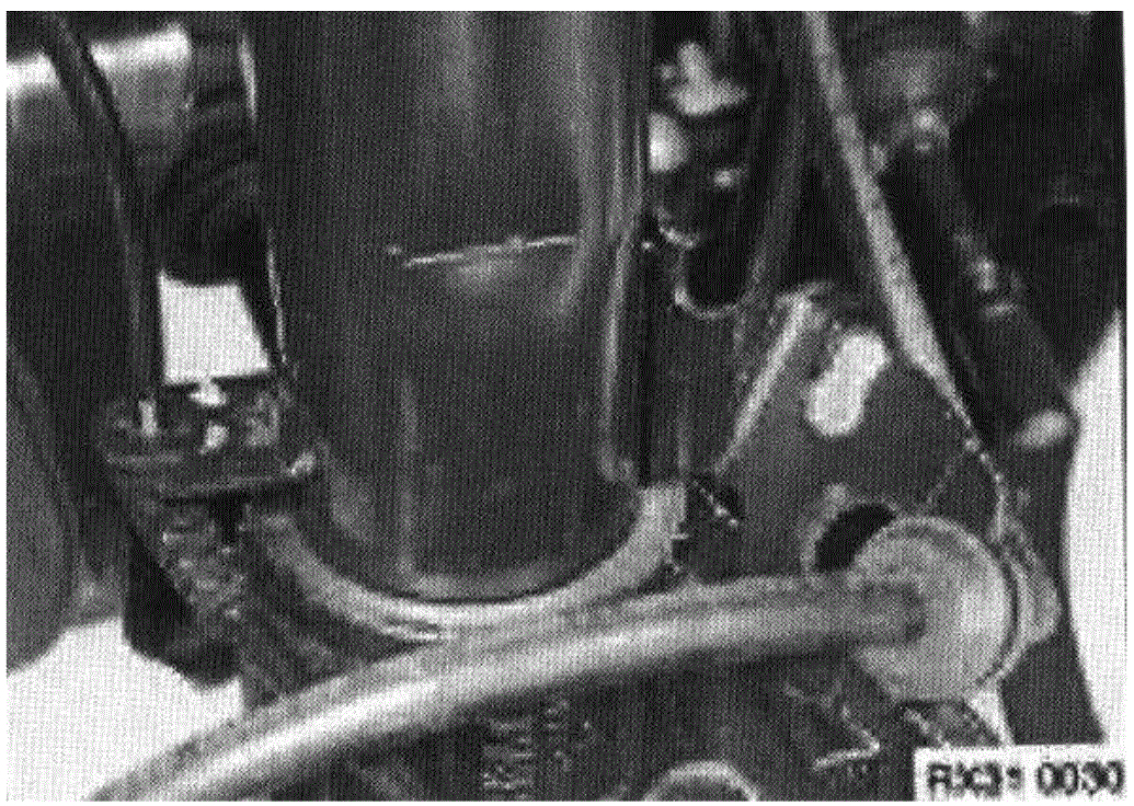

pic 1
Release wheel speed sensor and brake hose from the holders.

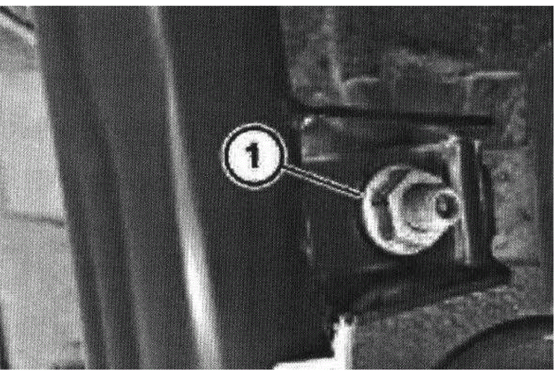

Vehicles with automatic headlight beam throw adjustment:
pic 2
Release screw (1) and remove bracket.
Installation Note:
- It must be ensured that the bracket is re-installed in the correct position.
Vehicles Up to 03/2002:
pic 3
Release nut (1) using a hexagon socket wrench or open-end spanner for counter support.
Installation Note:
- Replace self-locking nut.

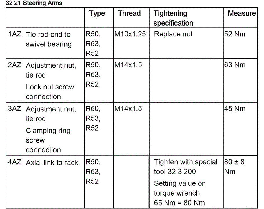

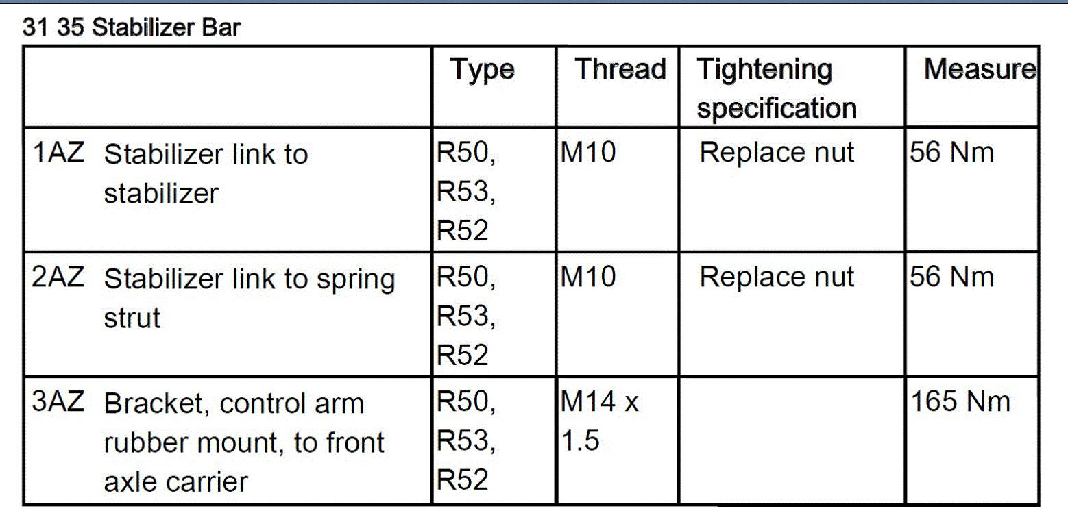

pic 4
- Tightening Torque, 31 35 1AZ.

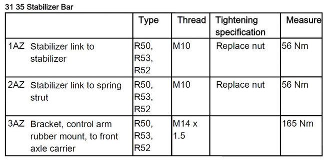

pic 5
Installation Note:
pic 6
- Tightening Torque, 31 35 2AZ.

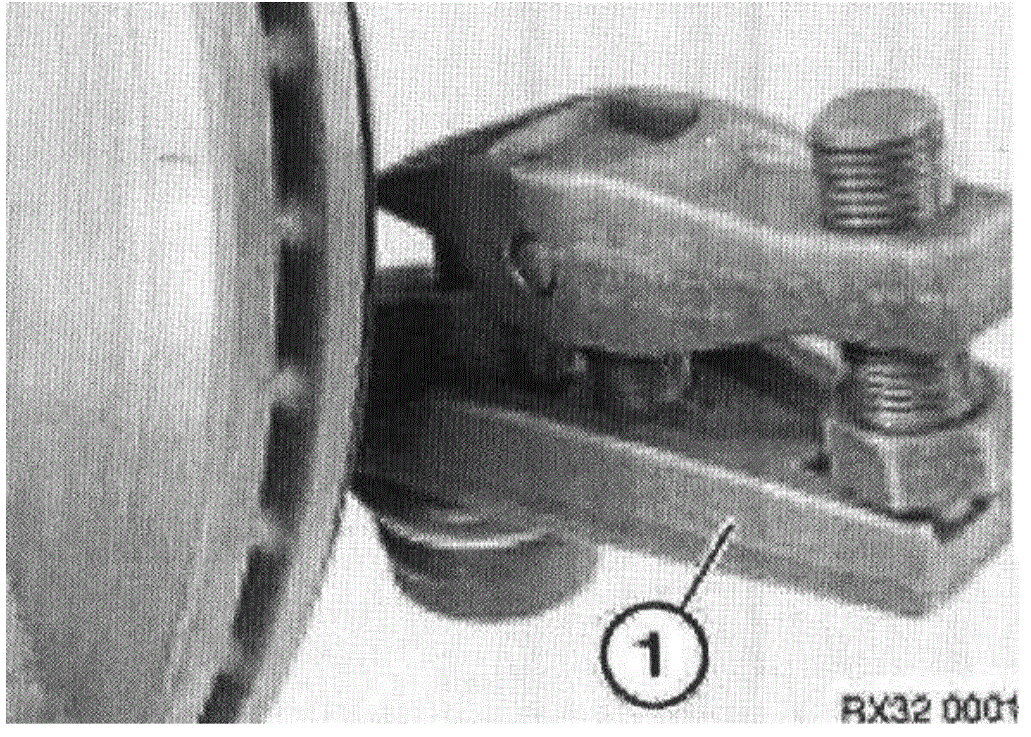

pic 7
Release nut and press out track rod from the steering stub with special tool 32 3 090 (1).
Installation Note:
pic 8
- Tightening Torque, 32 21 1AZ.

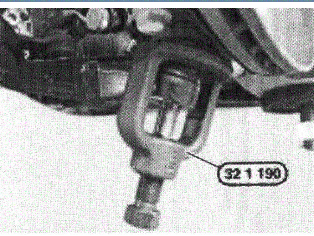

pic 9
Release nut and press out wishbone from the steering stub with special tool 32 1 190.
Installation Note:

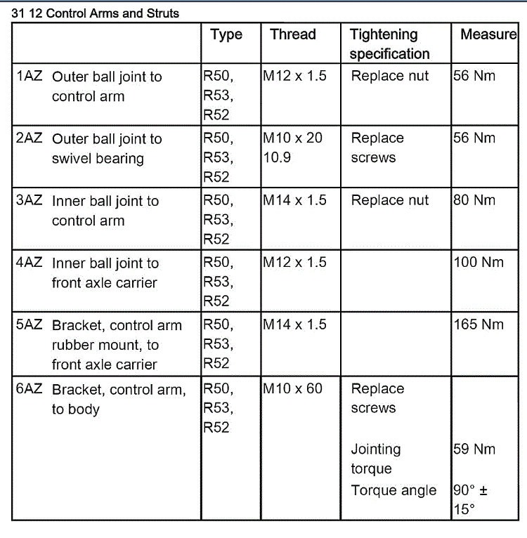

pic 10
- Tightening torque, 31 12 1AZ.

- Tightening Torque 31 21 1AZ.

Release nut (1) while supporting the spring strut and then remove the spring strut.
Installation Note:
- Replace self-locking nuts.
pic 14
- Tightening Torque, 31 31 1AZ.

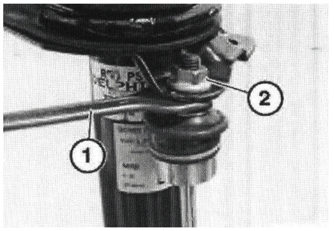

pic 15
Release nut (2) using an open-end spanner (1) as counter support.
Remove anti-roll bar link from the spring strut.
Installation Note:

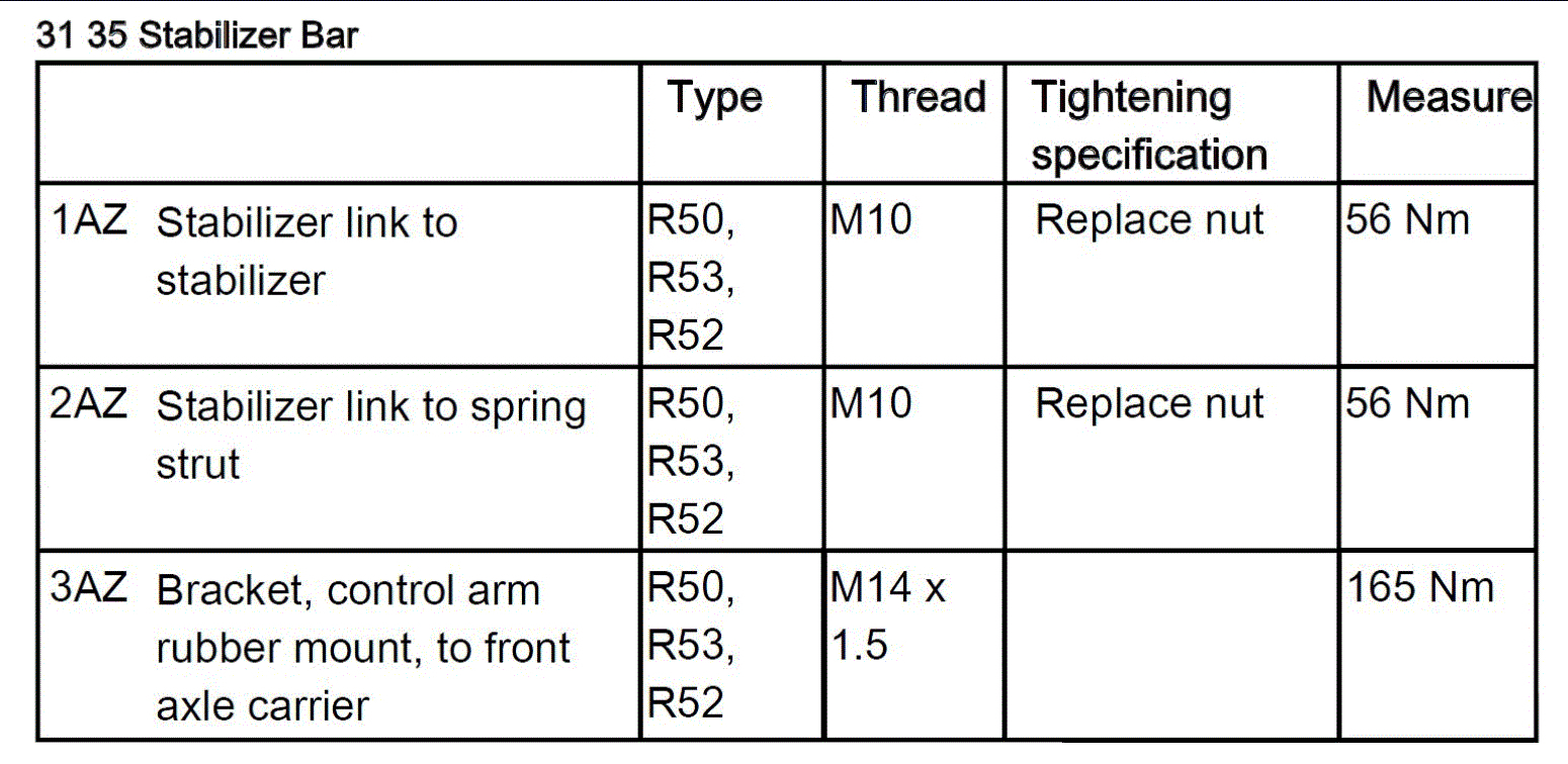

pic 16
