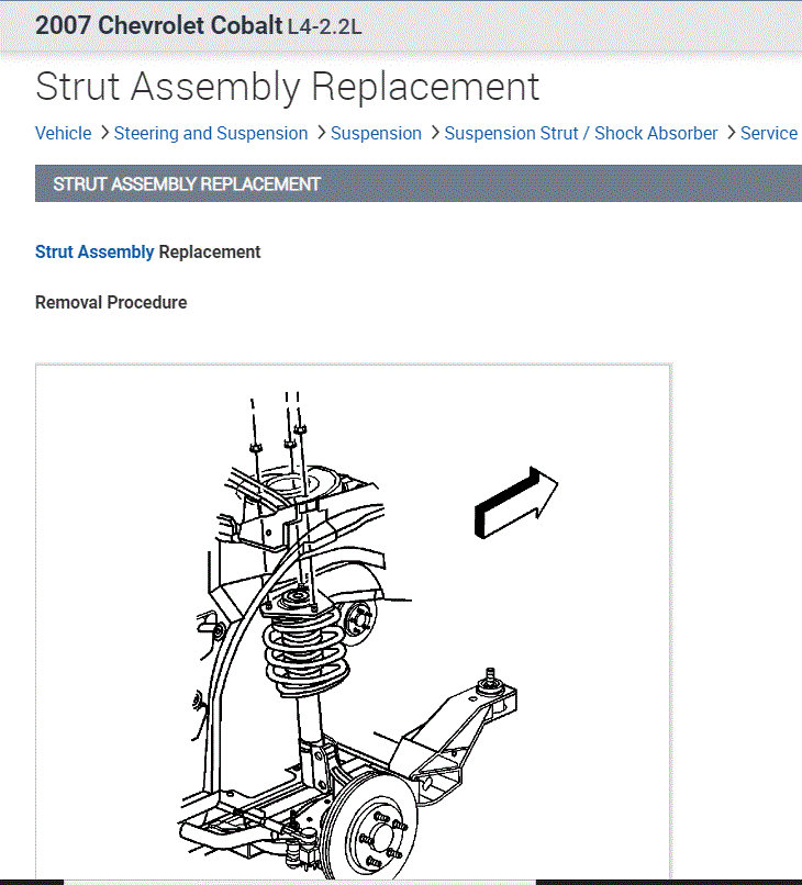

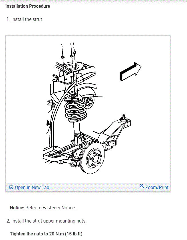

What should the nuts and bolts be torqued to on front struts? (Top and bottom)
Jun 7, 2022 at 1:44 AM
  • 110,240 POSTS
To get you started, here is a link that explains in general how to replace the strut assembly. You may find it helpful.
https://www.2carpros.com/articles/how-to-replace-a-suspension-strut-and-spring

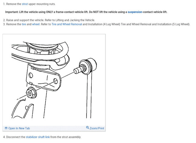

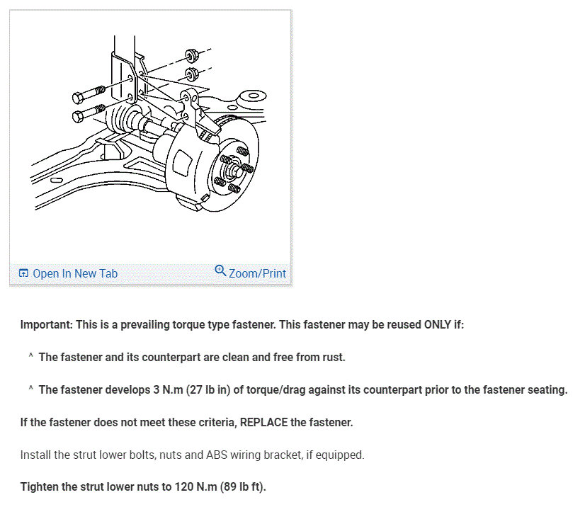

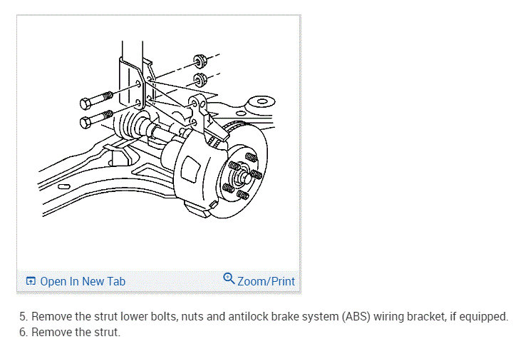

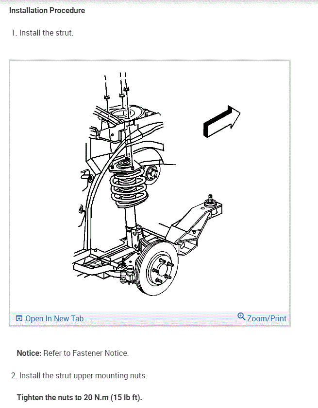

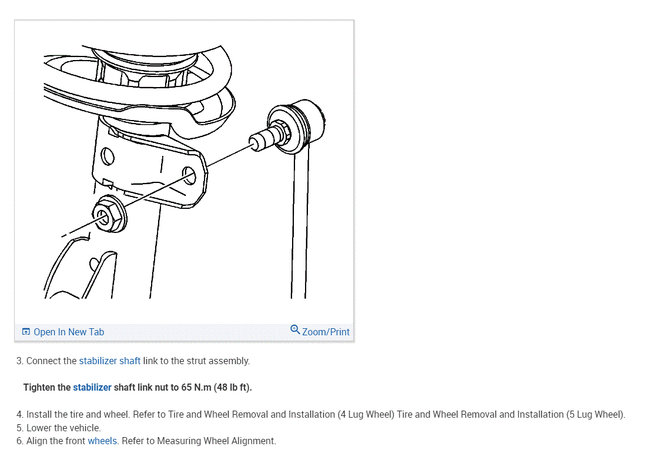

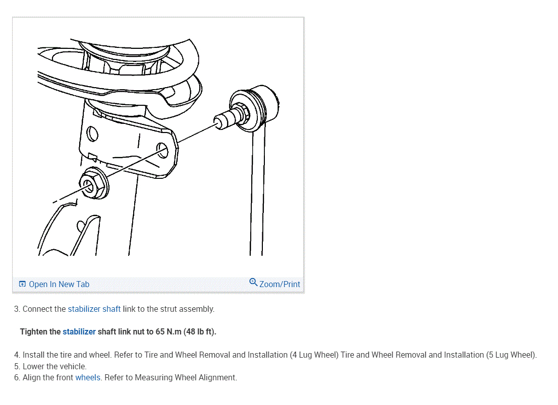

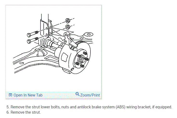

If you look at the attachments below, I included the directions specific to this vehicle for front strut removal and installation. The torque specs are included in the directions.
Note: The vehicle should be aligned after strut replacement.
Let me know if this helps.
