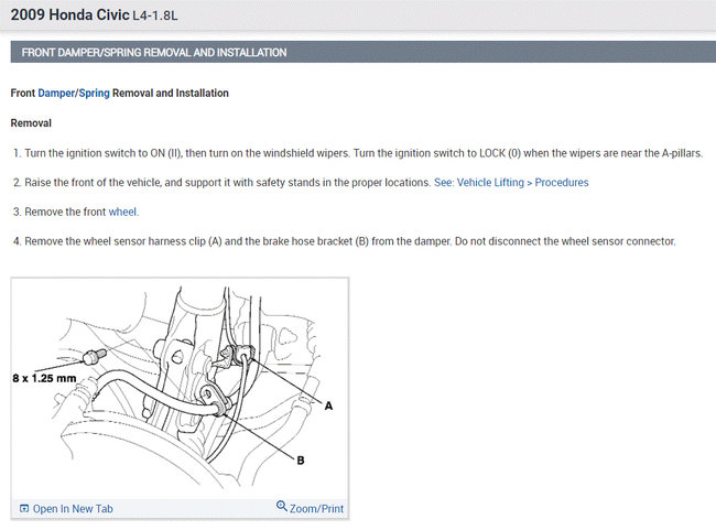

After replacing the front struts there is a clicking noise
2009 HONDA CIVIC
120,000 MILES • 1.4L • 4 CYL • 2WD • AUTOMATIC
TOM.V.TRAN2002
So I replaced my front struts and when I stop at a light I hear a tiny click but once I start to move again I hear a big click. It’s only starting and stopping it doesn’t click at all while I drive.

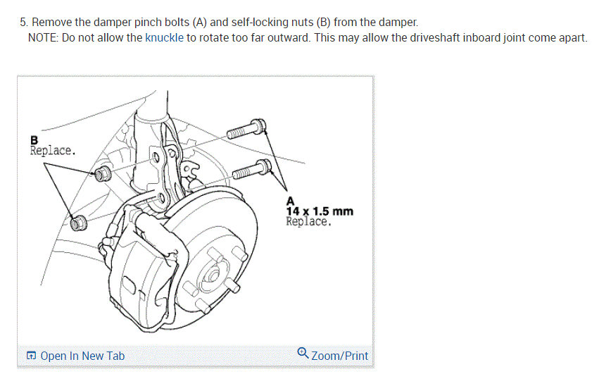

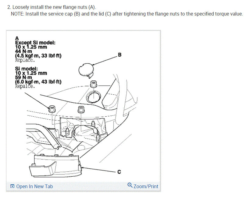

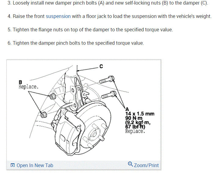

Is the sound loud enough for you to record and upload for me to hear? Also, have you had the vehicle realigned? Are you certain everything is tight as far as the pinch bolts and flange bolts at the top? One last question. Did you install a new strut full assembly or did you take yours apart and rebuild them?

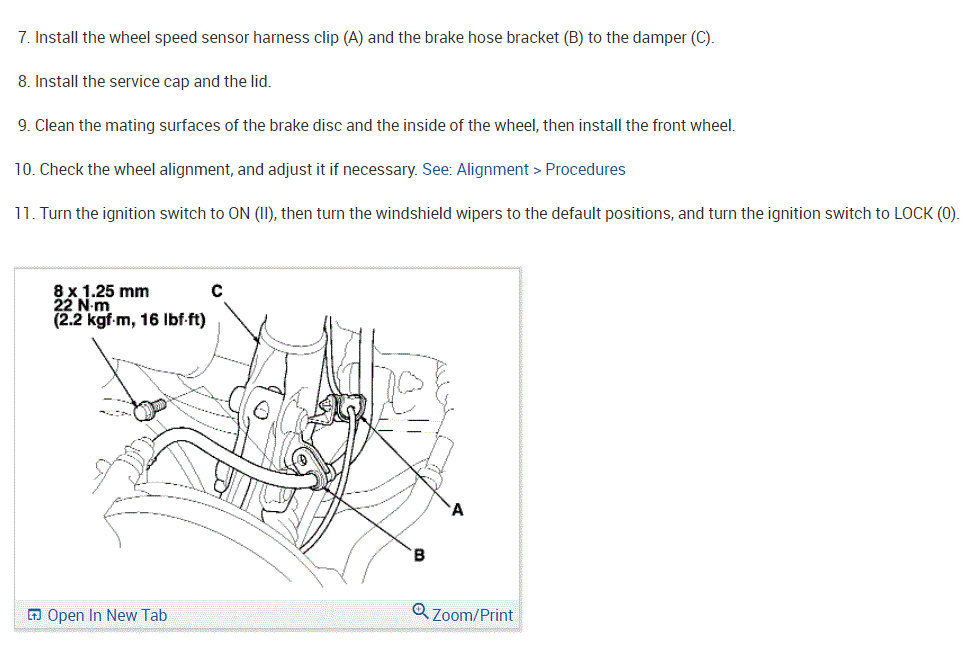

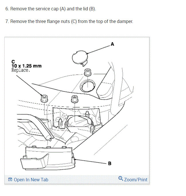

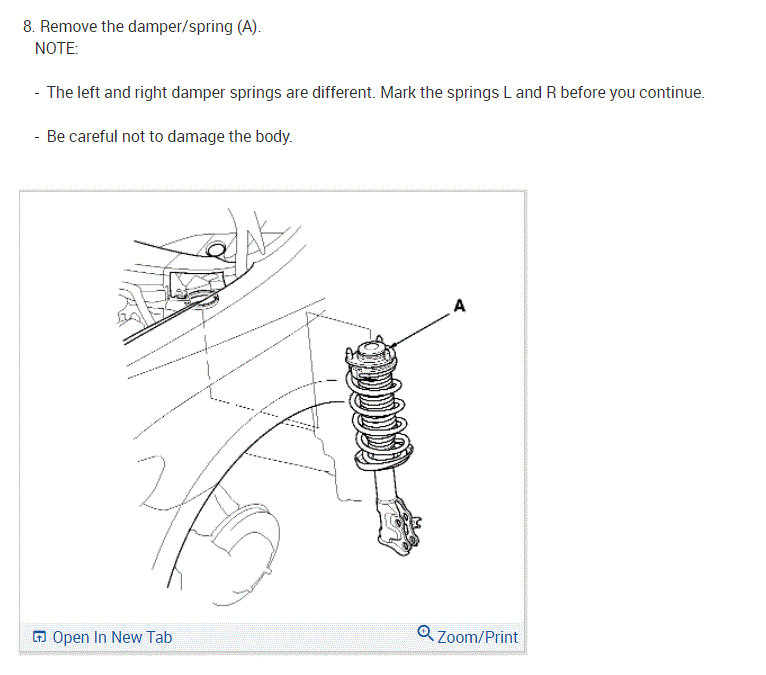

I attached the directions for the removal and installation procedures. Take a look through them to make sure nothing was missed.
Jul 23, 2021 at 12:57 PM
