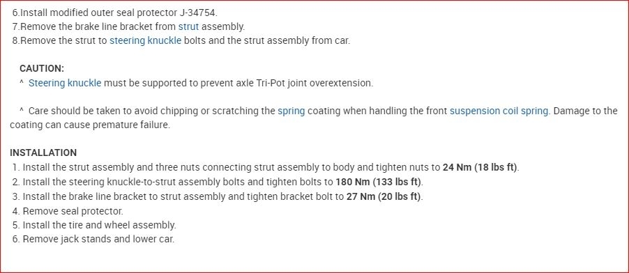

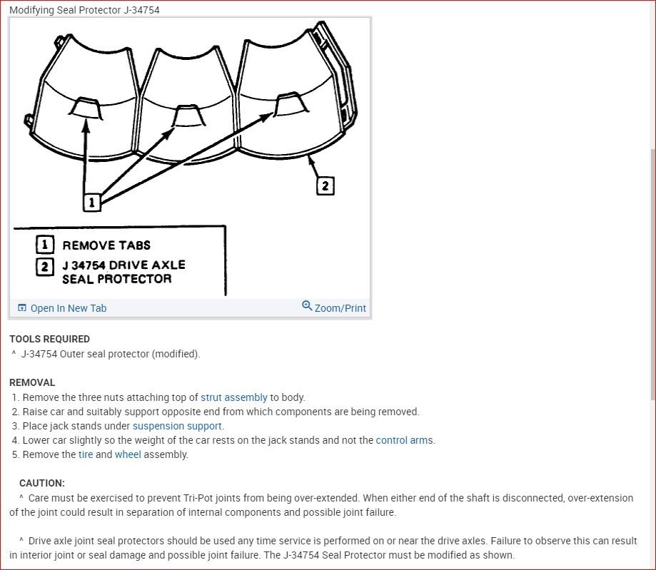

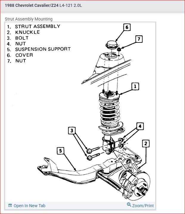

Hi, I have the vehicle listed above wagon. I’m doing my front struts in a few days and I was just wondering what the torque specs are for the bolts and if there are diagrams for it if possible? Thanks!
May 30, 2019 at 2:13 PM
I attached the process for removing and installing the struts. It includes torque specs. Please tell me if you need any thing else. Check out the diagrams (Below). Please let us know if you need anything else to get the problem fixed.
Thanks for using 2CarPros.
