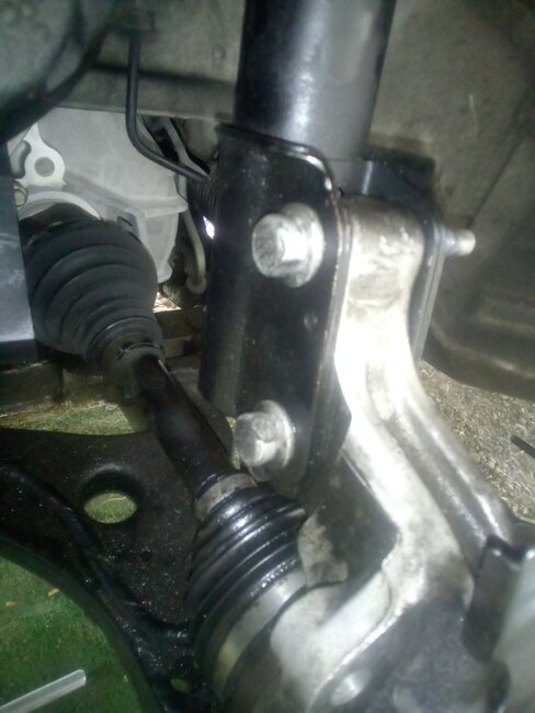

I have to replace my wheel hub assembly because the speed sensor wire got ripped out.
I have followed this video as a guide. https://youtu.be/8CeiGG2lgZY?si=OatbtCTn-X3IJlke
It all goes fine except removing the 2 bolts that attach the knuckle to the spring. Got the nuts off but bolts won't budge. I've tried jacking up the lower wheel support to maybe take the tension off the bolts and no go. This video is easy. What could I do to get these bolts to break loose? Also why aren't the regular hex head bolts instead of this 2 flat side the rest rounded so can't put a socket on it? Anyways here is pic of the 2 stuck bolts.

If I understand right, you're replacing the bearing assembly. If so, the knuckle doesn't get removed. There's three bolts on the backside of the knuckle to remove, then pull or bang the bearing off. Remove the axle nut too. With the new bearing installed, be sure to not place any vehicle weight on it until the axle nut is tightened to specs. Some people set the tire on the ground to keep the axle from spinning while they tighten that nut. By that time the damage has been done. The new bearing will be noisy and make a buzzing noise. It's easy to just stick a screwdriver into one of the cooling slots in the rotor to hold it from spinning, then tighten that nut. The torque spec for that axle nut is 155 foot-pounds unless specified differently in the instructions that come with the new bearing.
For the two large strut bolts, those have just two flats because they can't rotate. There's splines under the head. To remove them, loosen the nut most of the way, then pound on that to drive the bolt out. Once you get past the splines, you can remove the nut all the way, then pound directly on the bolt without damaging the threads. GM designed it this way thinking their cars would never need to be aligned. (Fat chance). When "camber" needs to be readjusted, those splined bolts get replaced with Chrysler-style cam bolts with offset heads. A standard bolt goes in the top hole. That offset bolt goes in the bottom hole and creates the adjustment as it is rotated.

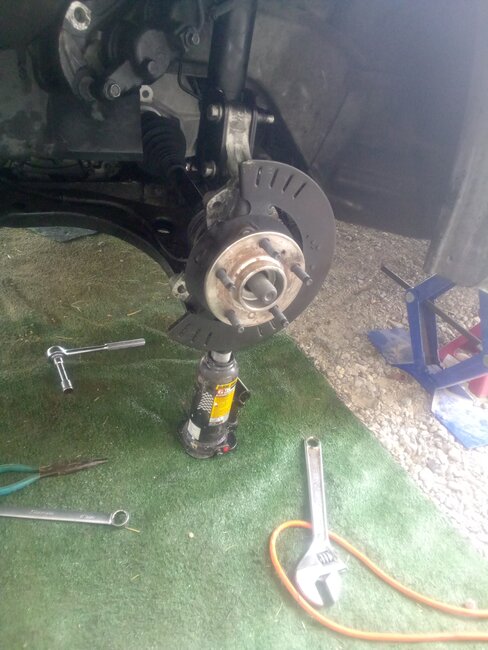

Thanks for the info. I know the steering knuckle normally wouldn't get removed for the wheel hub assembly but the top bolt above the CV boot is rounded. So, need to use a backing out drill bit or one that grinds the existing bolt out without hitting the threads. I have the tools at least. Do you see any other way to get at the top bolt without removing the whole knuckle? It's a tight fit so any type of drill rotating might damage the CV boot.
When I take the 2 bolts holding the knuckle to the spring it should be hanging like on a lift no additional pressure except its own weight?
Once knuckle is only held on by the lower tie rod at the ball joint would you think I'd have enough clearance to get the CV axle out of the way without having to pull cotter pin and remove nut?
Thanks again I've been trying to get those damn bolts to unscrew like the video. I like the pound them out way method at this point seems stress relieving.

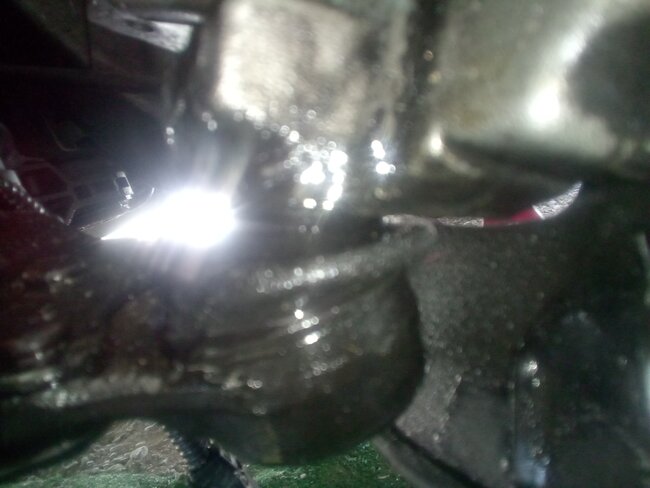

I have to replace the wheel hub assembly, but the top bolt is rounded so I can't get it out. So, I am trying to remove the whole steering knuckle so I can drill out old bolt and replace wheel hub assembly.
I have everything disconnected and unbolted. I can't get the knuckle to release. The top 18mm nut and cotter pin are removed and I've banged the shit out it, but it won't release. I've watched YouTube videos and usually they tap with a hammer, and it pops off. What am I missing?

Sorry for the delay. I understand the problem. Hadn't considered the rounded head. If that's the stud on the lower ball joint you're fighting with, banging on the knuckle usually shocks the stud loose. You can also try a "pickle fork". That has a pair of teeth on the end of a shaft that you can pound in to wedge the parts apart. The problem with those is they usually damage the rubber boot on the ball joint.

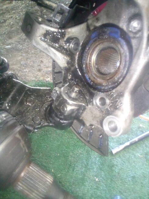

Thanks man. So, I don't have a acetylene torch or pickle fork but do have a spring compressor that has a little wedge fork thing I've tried banging on no luck. I'm trying not to have to replace the ball joint where the knuckle is stuck. However, I have started to drill out the center of the hub bolt thinking same idea as cutting top off. I don't have a grinder that will fit (Dremel not strong enough) in the space and have enough power to cut through it. Anyways replacing the wheel hub assembly so if bolt stuck in it not worried and already have a bolt to replace it. So, keep the knuckle attached to the ball joint, drill out the bolt head and in theory the hub should slide out. This sound like I'm on the right path? Thanks again.

Yup. That bolt will want to fight sliding out, so you may want to run the other two in part way to have all three to pound on. That way the bearing will come out straight. If it feels like you're going to damage the two good bolts because too much force is needed, you may have better luck going right behind the bearing's mounting surface on the knuckle and driving in a sharp flat chisel. Do that in a number of spots around the bearing to start it coming out. Some come out rather easily. Some will fight you.

Thanks. So, all of the above didn't work lol. Being on ground jacks really limits your swing space. So here is how I did it and maybe this might be helpful. I cut one of the wheel mounting stud posts off and knocked it out. The post holes almost perfectly line up with exposed bolt end. Line up the hole with said bolt end. Take a drill through hole and start to drill end of bolt. Start with a bit about 1/2 the size of the bolt end (may need a pilot hole so bit doesn't slip). The drill bit spinning clockwise twists the bolt counterclockwise in turn loosening the bolt. If not, can drill the little bit of bolt out if worse comes to worse. My situation it took about a 1/4" of drilling and bolt backed itself out. I don't know if that might be helpful at any time but there it is. Thanks for the help, it really did help get me thinking different ways to solve this problem. Limited tools not good. This site doesn't! Is there somewhere I can leave a review?
