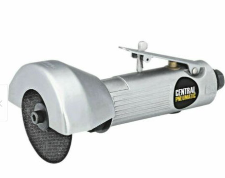

Also, what type of extractor was used? Is there enough access to the bolt to cut the stripped portion off? I've used a whizzer wheel to cut as much of a bolt off and then a chisel to cut anything remaining. Once that is off, you can remove the alternator. The threaded portion will still be in the alternator, but you are replacing it, so that wouldn't matter. You could simply replace the bolt.
I attached a pic below of the type of wheel I used in the past.
Let me know if this helps.
