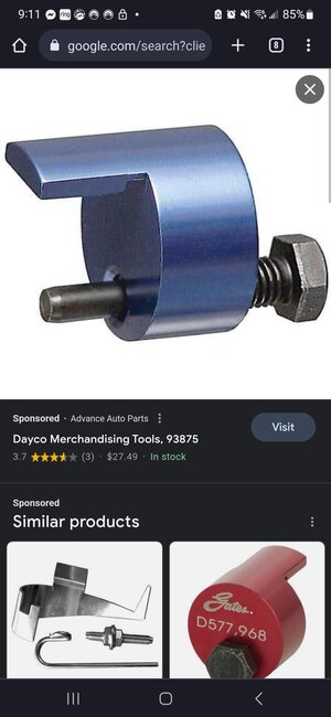

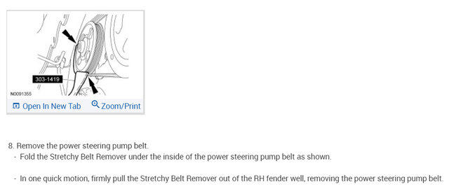

I'm needing to replace the stretch belt on my car listed above SEL. I have not been successful at putting it on. I even rented a small tool to be able to put it on easily. Does it lock up? I've looked at videos with the tool being used and it looks easy. I'm wondering if it can lock up somehow or is there something else that is preventing me from being able to put it on. I attached a photo of the tool I rented to make it easy to put on.
Aug 29, 2023 at 12:16 AM
  • 55,673 POSTS

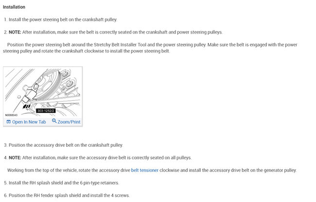

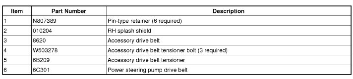

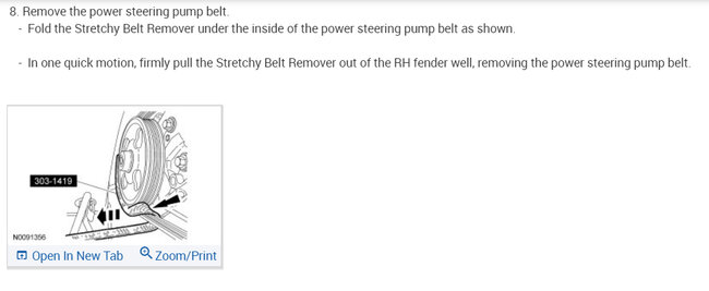

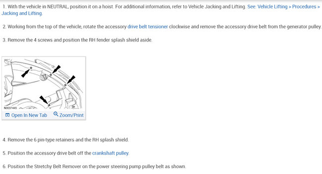

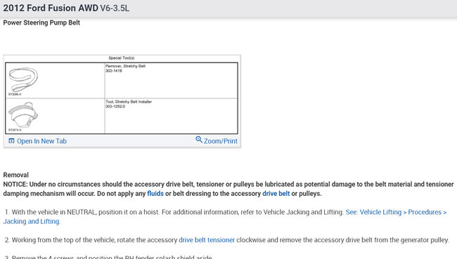

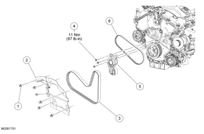

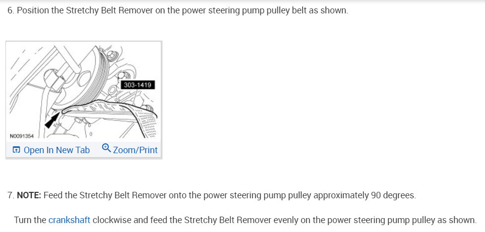

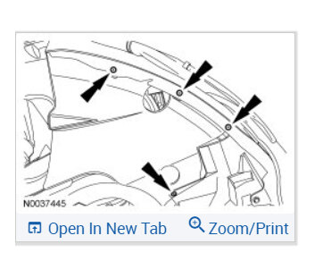

Yep, that looks like the correct tool, here are the instructions on how to install the belt. Check out the images (below). Let us know what happens and please upload pictures or videos of the problem so we can see what's going on.

I have tried replacing it and it has ripped twice. Both news belts have ripped while trying to put them on. I bought them at AutoZone. Idk if I'm being given the wrong one or not.
Aug 30, 2023 at 12:32 PM
  • 55,673 POSTS
The belt size is important on this application. Did you match the old belt to the new one? If so, you might want to try a Motorcraft belt.
