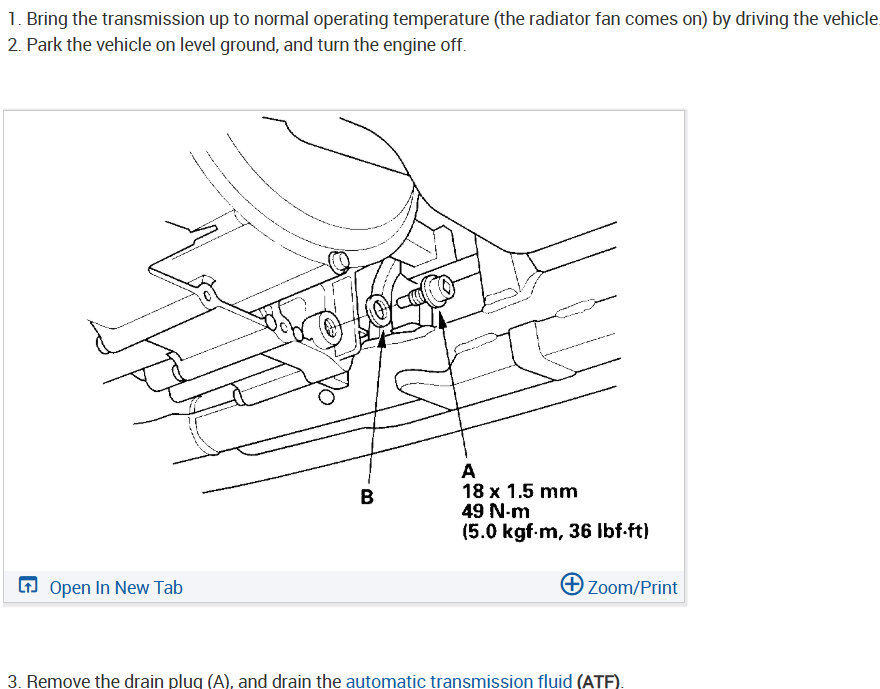

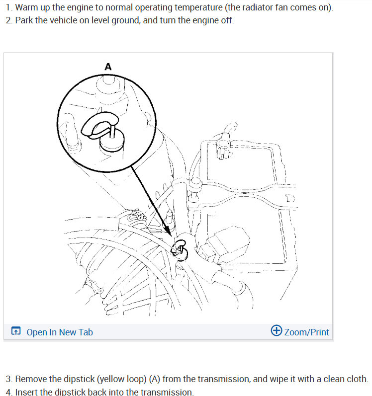

How are you doing? Yes, the CV axle might cause this, but I would service the transmission and rotate the tires front to rear. Usually when the CV axles go bad, they will cause a vibration when accelerating only. The shutter sounds like the TCC is not holding like it should so fluid dump and fill should help it.
Here is a guide to help:
Here is how the job is done for your car. Always use Honda ATF DW-1 (ATF-Z1 has been replaced with ATF DW-1, Honda Service News Nov 2010) Automatic Transmission Fluid (ATF). Using a non-Honda ATF can affect shift. Check out the images (below). Let us know how it goes.

Thank you. So, this transmission has no filter. Simple drain and refill. In the photo what is bolt B just out of curiosity?

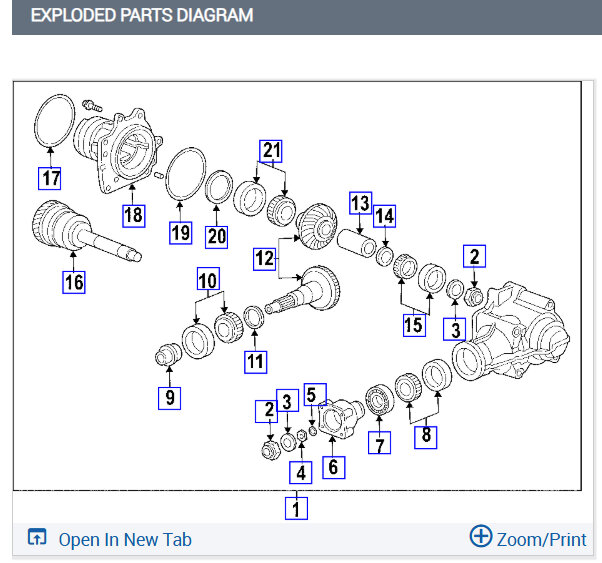

It can be the transfer case that is having an issue. Check out the images (below). Please let us know what happens.

I disconnected the driveshaft, and the same vibration occurred at 50mph ,2k rpms, except it was worse. Rechecked rear end. Minimal movement in transfer case mount. At a complete loss?
