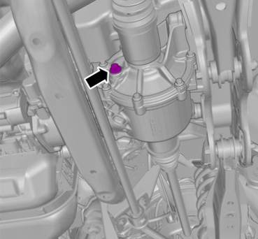

I have seen the rear differential fluid cause this issue, it wears out and causes the clutches to stick together causing the shudder. I don't see a drain port so you may need to suck the fluid out.
SAE 75W-90 Full Synthetic Gear Oil
Check out the images (below). Let us know how it goes

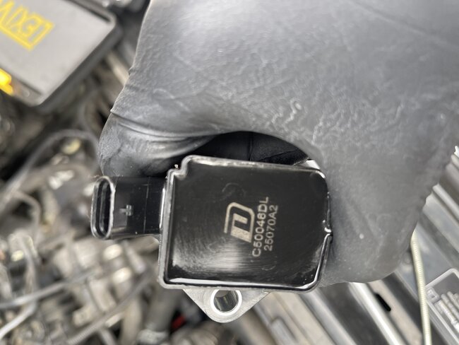

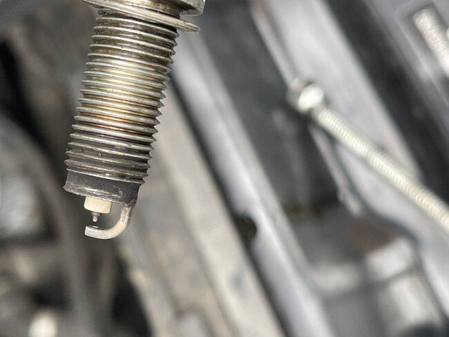

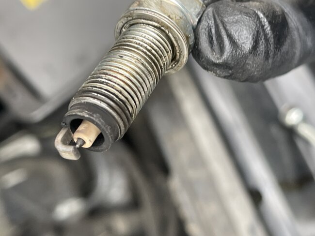

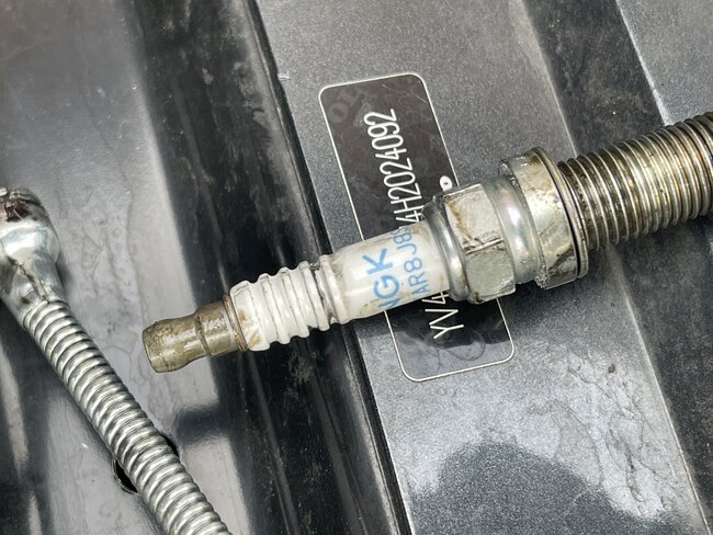

Checked one of the plugs i think it looks fine. Never heard of this brand coil not sure if oem ir has been changed before, but the too of them all looks new but maybe cause the cover is on top of them

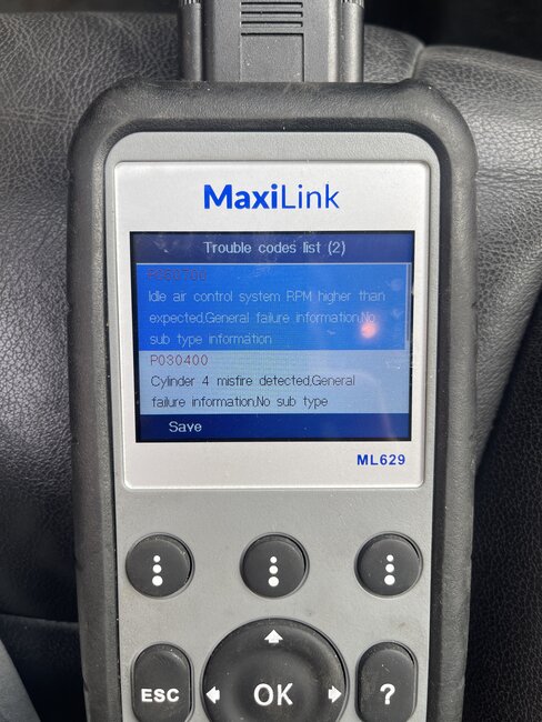

You kind of have to cheaot the scanner to get into afanning some of these. I was in somewhere to check codes and it gave me this,even though if u scan it with a regular obd probably wont show a thing and check engine light is not on. I found these. Even though the picture at auction was for p0301. There is a fluctuation in rpm when say you in a drive through, similar to a vac leak, otherwise stable, but i think it gets it from either a plug, ignition or dirty injectors. I put in some ethanol fleaner and driving it to see

Yep, I have not heard of the coil as well, I would replace it with an main brand part and change the spark plug just in case, clear the codes and try driving it again. With the first code P0607 idle high tan normal can mean a vacuum leak, this video can show you how to find it.
