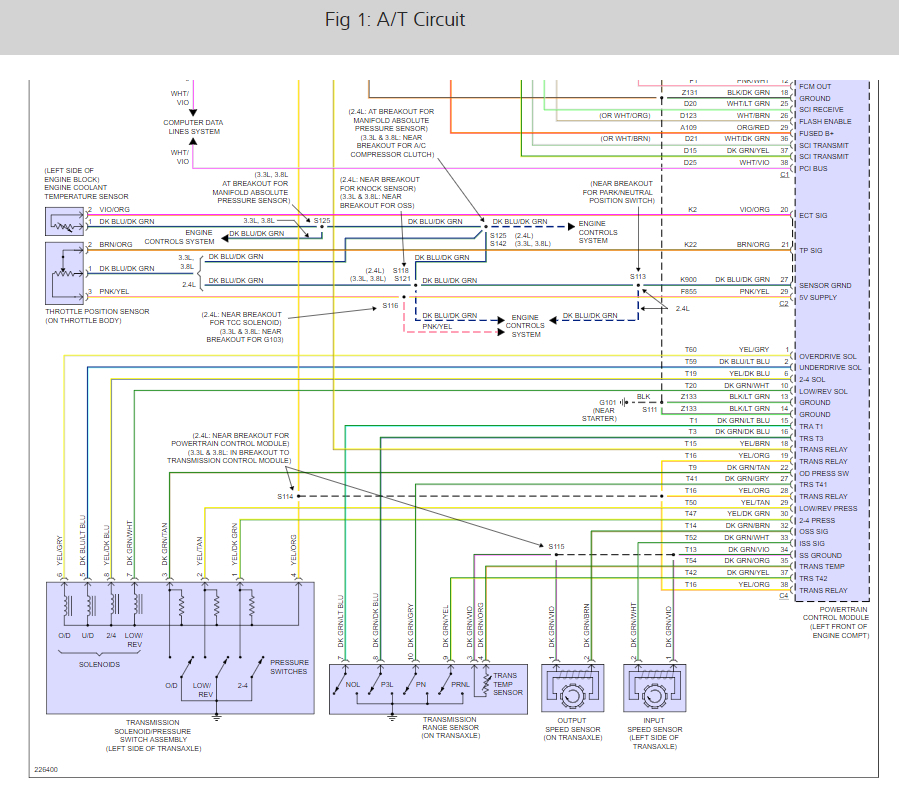

Sometimes when I turn the key to the run position with engine off the battery light comes on, airbag light comes on, anti-theft light blinks. Also, I do not hear the fuel pump prime and the coolant temperature gauge stays in cold position even if the engine is hot. Sometimes when those symptoms occur I start the car let it run for few minutes turn it off turn the key to run position engine off all symptoms are gone and i can hear the fuel pump prime. When the symptoms occur and when I start the car put it in gear it goes to limp mode. Usually there are two codes p0882 and p0218. I checked the temperature of the transmission is not overheating.

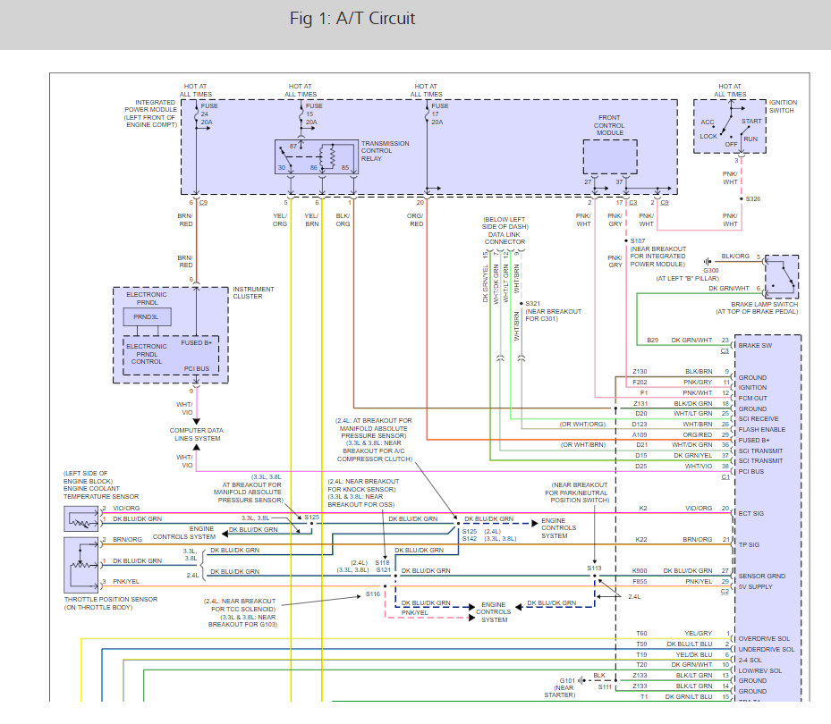

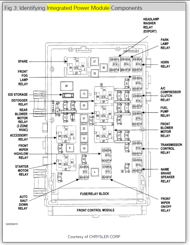

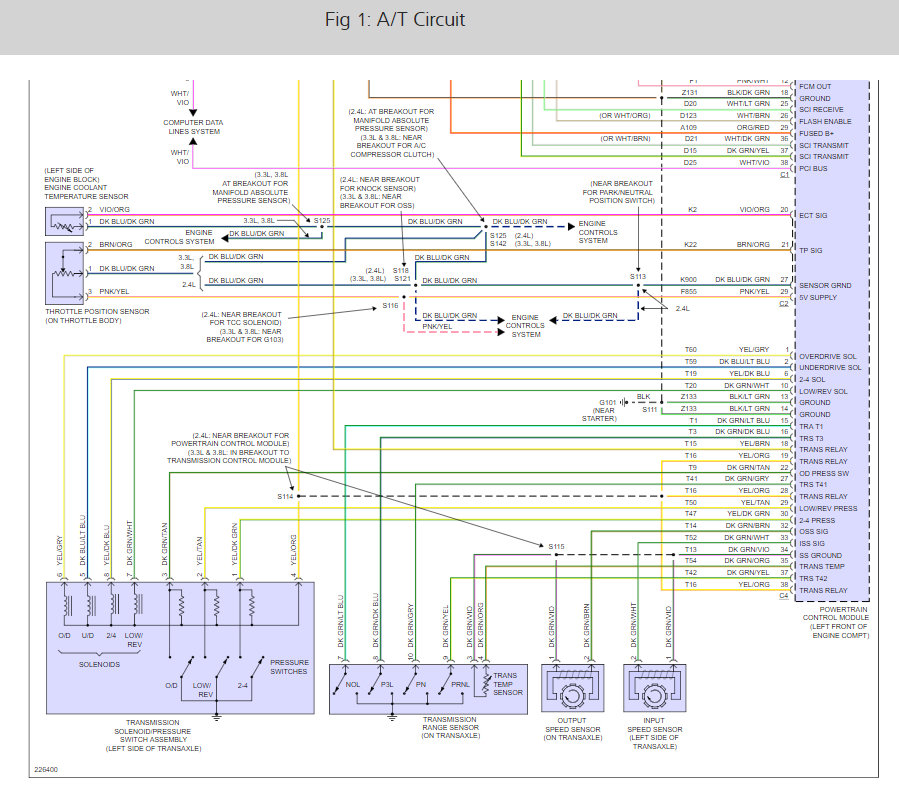

If I can throw in my two cents, I have seen where the transmission control relay goes out which can cause this issue. Here is a guide to help check the relay and the location of the relay as well with the ring diagrams so you can see how the system works:
Sep 24, 2018 at 4:58 AM
JR9261018
  • 49 POSTS
I will did just I forget to tell you the car acts up same as I unplug the PCM c1 connector? It is like there is no power and ground going through c1 connector. However, when I back probe the wires there is power and ground even when the car acting up.

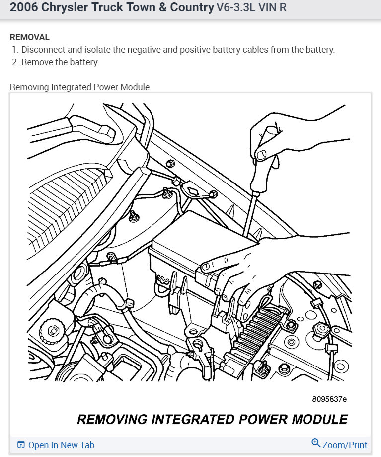

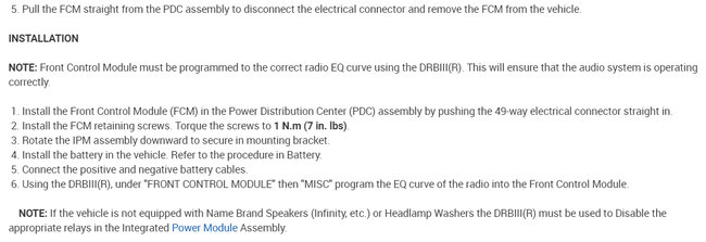

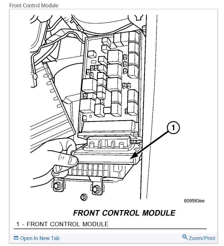

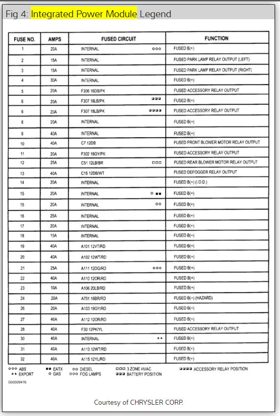

Okay, I would go to the fuse block or the TIPM module under the hood. Check all the connectors for any corrosion or burns.
Sep 28, 2018 at 7:33 AM
  • 55,432 POSTS

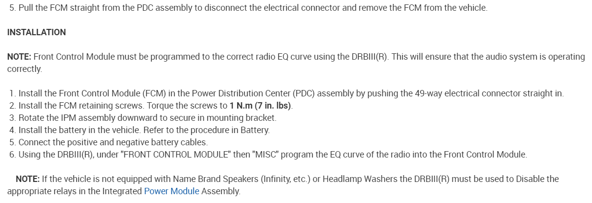

The TIPM go out all the time in these cars you can replaced it without programming it BTW. Check out the diagrams (below). Let us know what happens and please upload pictures or videos of the problem. Cheers, Ken

Okay, I will upload the problem. Also I checked all the connectors of the TIPM no corrosion or burnt terminals.
Sep 30, 2018 at 9:34 AM
Then most likely the TIPM is the issue.
Ken gave you the instructions on how to replace it.

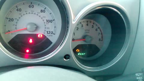

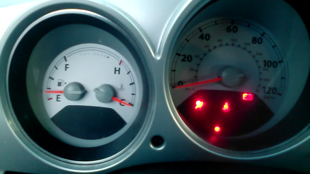

Ken, this is the video. Thank you
Oct 1, 2018 at 11:12 AM
JR9261018
  • 49 POSTS
Sorry forget to tell you key is on run position engine off. When the car does what you see in the video it will not shift limp mode. However, when all the lights are off at the run position engine off the car will shift normally.
Oct 1, 2018 at 11:14 AM
  • 55,432 POSTS
Thanks for the video it does look like the TIPM is out. This is what they act like, sometimes they sometimes they do not. It would be my next step.

I have heard of the instrument cluster causing weird problem from guys in the shop FYI. To me it sounds like a wiring issue can we go over the wiring harness to check for open or grounded circuits? Here is a guide to use with the wiring diagrams above:
Let me know

Just let you know the car did not act up for few days now also no codes p0882 p0218. The difference is the outdoor temperature on those days the temperature is about 32 at night and 60 days. What could be related to temperature?
Oct 18, 2018 at 12:53 PM
  • 55,432 POSTS

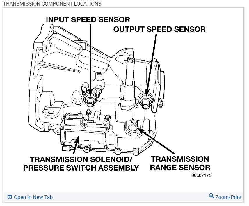

It sounds like the sonilond pack which has the fluid temperature sensor in it needs to be replaced. Here is a diagram of what I am talking about. Let me know what happens.
Oct 19, 2018 at 4:14 AM
JR9261018
  • 49 POSTS
I thought the temperature sensor is part of TRS. Also, when the car acting up and put it in reverse the white back up light is not on.
Oct 19, 2018 at 12:31 PM
  • 55,432 POSTS
That could be shorted gear range sensor, let's use the wiring diagrams I gave to test through the sensor it could be causing the issue.
Oct 20, 2018 at 3:41 AM
JR9261018
  • 49 POSTS
I measured the voltages of the TRS wires and compared to what Alldata specification.
When the car acting up or when the car is not acting up the value of the trs are:
T43T41 T3 T1
P CL CL OP CL
R CL OP OP CL
N CL CL CL CL
D OP OP CL CL
3 OP OP OP CL
1 CL OP CL CL
Alldata specification for the TRS are:
T43T41 T3 T1
P CL CL CL OP
R CL OP OP OP
N CL CL OP CL
D OP OP OP CL
3 OP OP CL OP
1 CL OP CL CL
Oct 21, 2018 at 11:25 AM
  • 55,432 POSTS
The top line of testing is a concern on T3 supposed to be closed and it open, looks like the sensor is bad.
