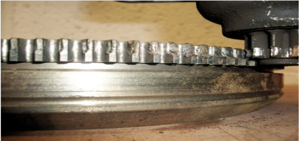

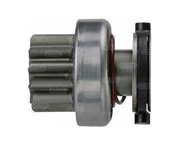

There's a quick scrape sound that always happens after starting up for the first time, and after I pick up a little bit of speed. The sound comes from under the car on the driver's side, but it only happens the first time after starting up. Even if I stop at a red light or park the car (but leave it running), the sound won't happen. But if I turn the car off, and back on again, it will make noise after picking up speed.
Mar 19, 2023 at 7:10 AM
BORIS K
  • 836 POSTS
From what you describe the noise could be a starter Bendix gear staying engaged.
See images below of Bendix gear and ring gear.
