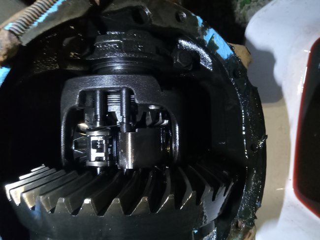

YOITSJUSTME
  • 34 POSTS
Okay, so, no, the truck is not lifted. I have pulled both driveshafts and checked the u joints and they all seem fine so I'm going to remove the cover on the rear end and check that today. I'll update as soon as I get cover off.

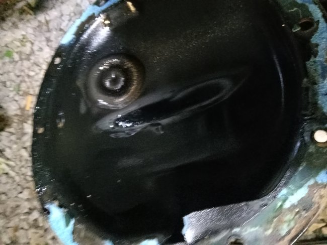

YOITSJUSTME
  • 34 POSTS
Well differential looks good so that's out of the equation.
Sep 5, 2022 at 6:49 PM
  • 54,832 POSTS
yep, it looks okay, refill with new fluid and take it for a drive to see if that helps. While you are at it inspect the underside to see if anything is obviously wrong.

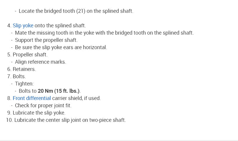

  • 54,832 POSTS

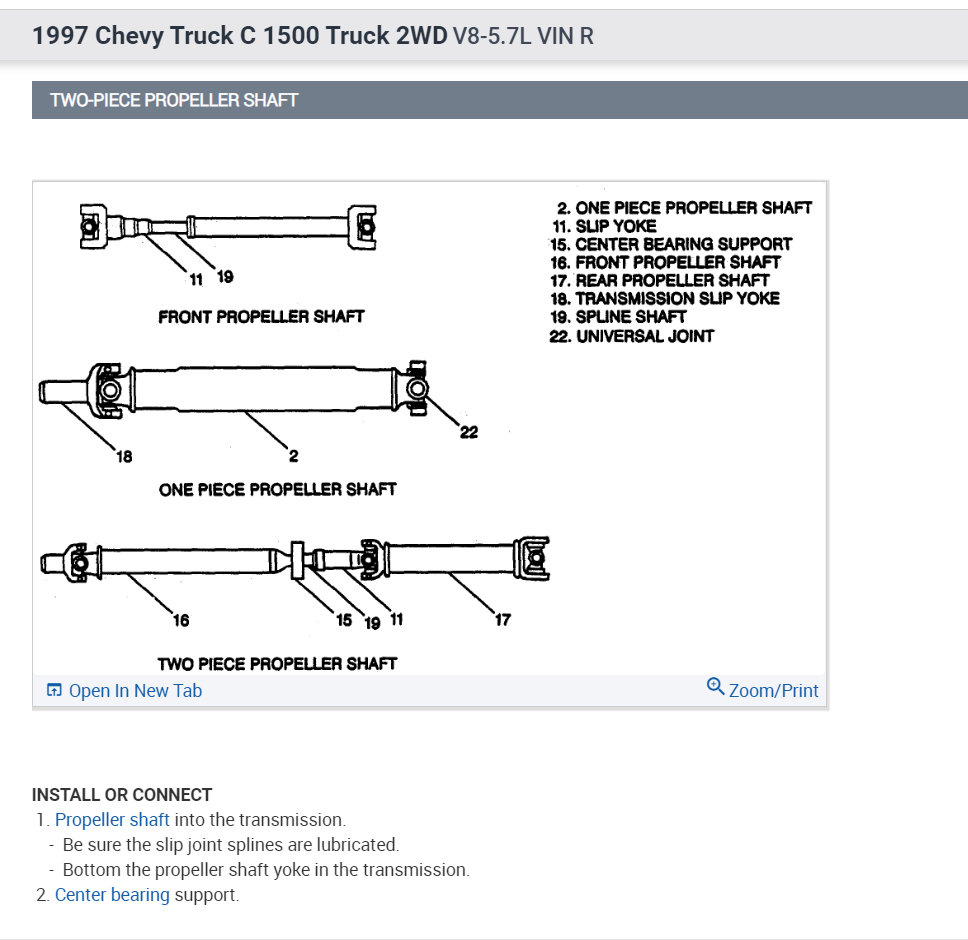

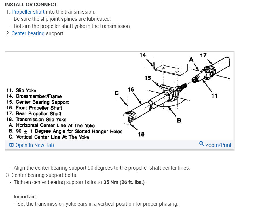

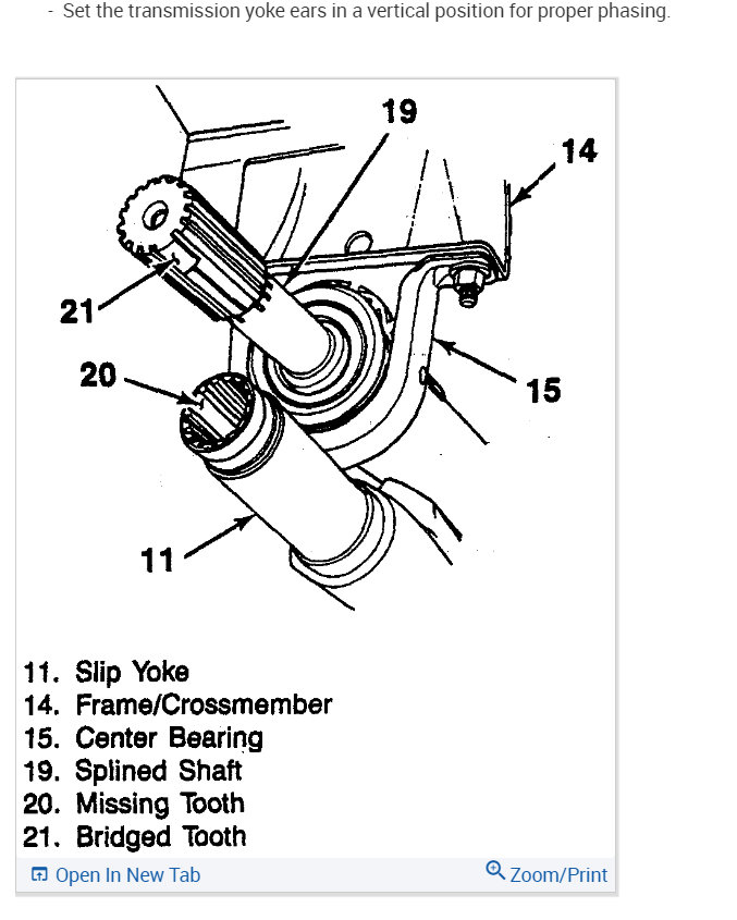

Oh boy, yep it looks like the driveshaft carrier bearing is out, thanks for the videos they helped. Here is how you can change the bearing out, start by removing the driveshaft. If you don't want to do the bearing an automotive machine shop will do the job for you. Check out the images (below). Please let us know if you need anything else to get the problem fixed.
