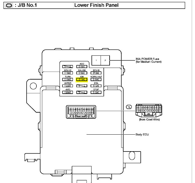

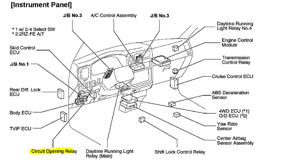

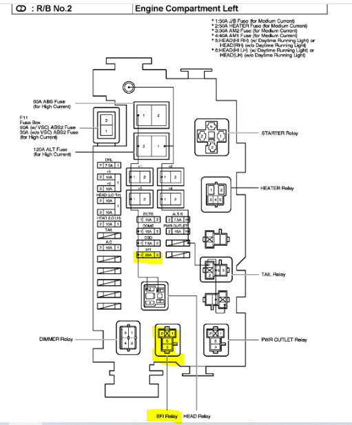

Next, there is a chance we aren't getting power to the pump. There is a fuel pump relay (circuit open relay) that may be faulty. It is located in the vehicle (lower left side of the dash). Also, there is an EFI relay and fuse and an ignition fuse that may be causing issues. The injector fuse/relay is under the hood in the relay box and the ignition fuse is under the dash.
Check these things. Here are two links you may find helpful:

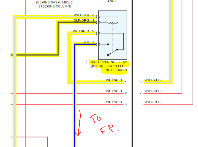

No problem whatsoever. I feel bad it isn't fixed. LOL Have you checked the circuit open relay to confirm if it has the power it needs? If the fuel pump still isn't running, we need to check if there is actually power to it. You may have a faulty pump.
See pic below.
Mar 10, 2024 at 8:25 PM

Thanks, how would I go about checking for power, all I have multimeter, I don’t have test light or scan tool?.
Mar 10, 2024 at 9:24 PM
  • 110,194 POSTS
You could use the multimeter. Set it to voltage, connect the negative connector to a known good ground location, and then use the positive side to probe for power.
Also, here is a link that explains how to test a relay and its circuit:
Let me know if this helps.
