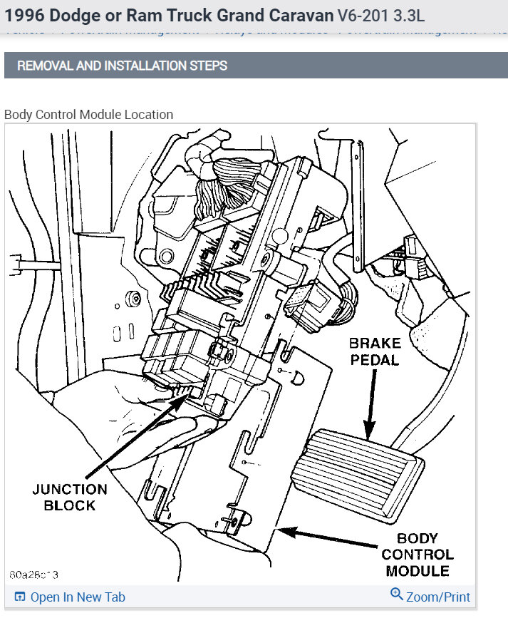

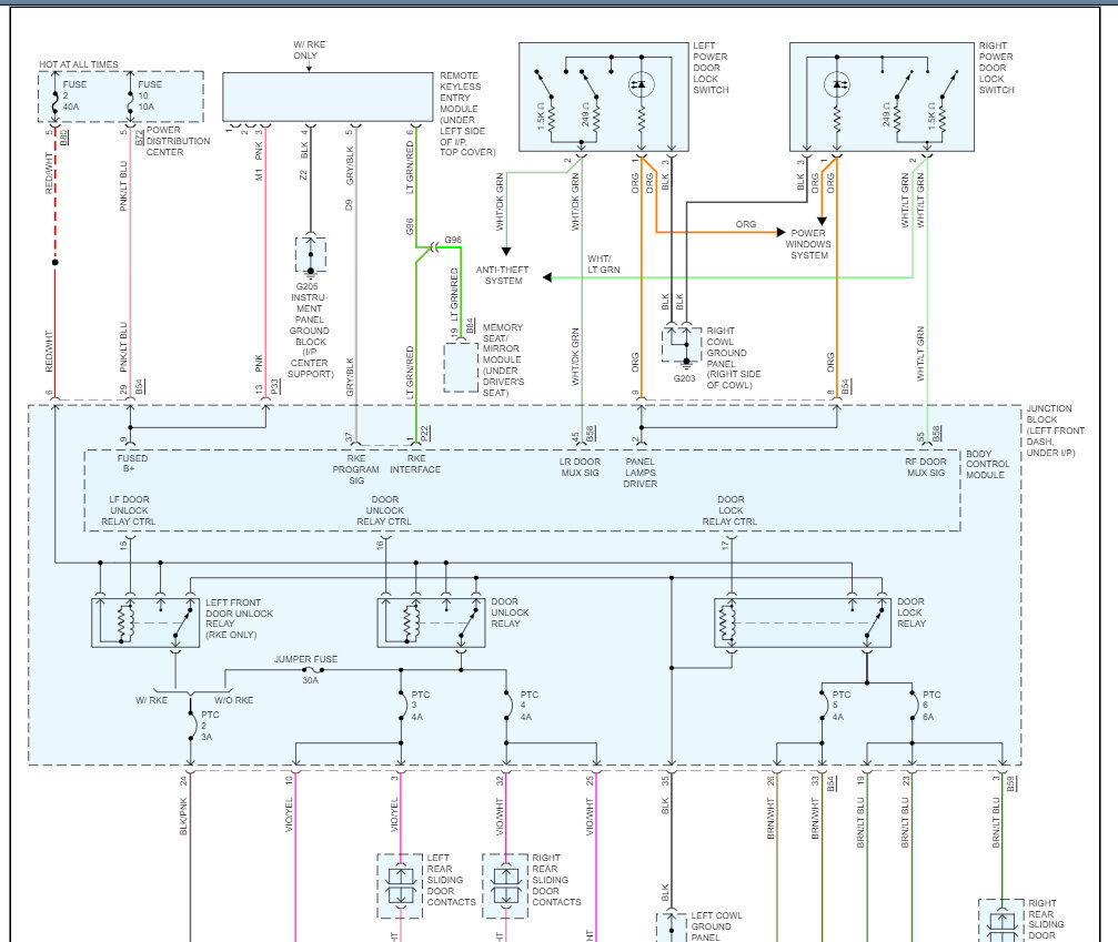

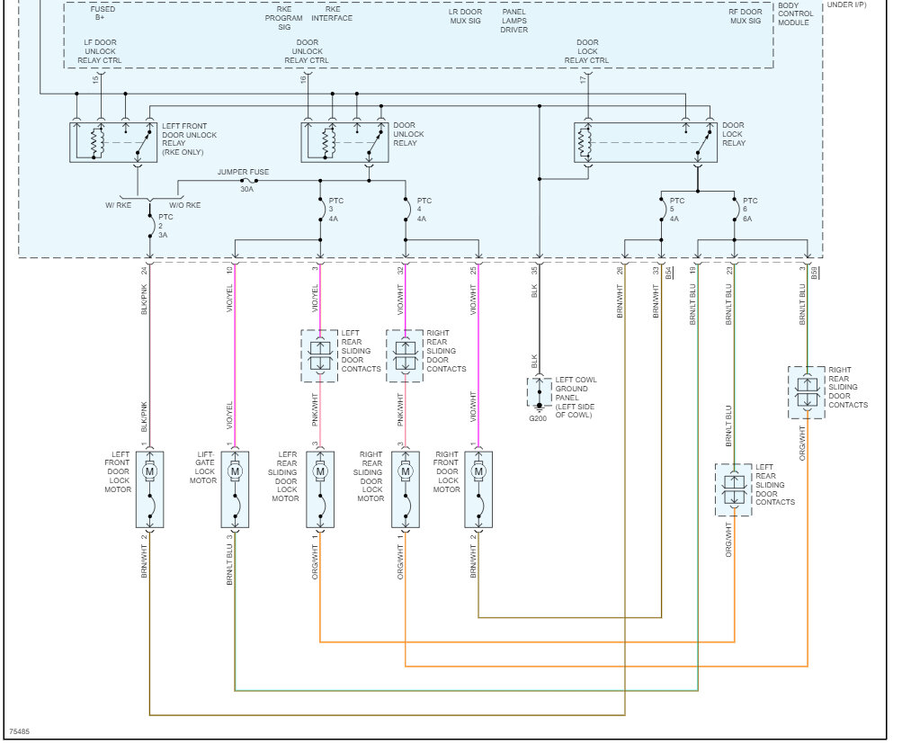

It sounds like the BCM is going out or you have a loose connection to ground, here is the system wiring diagrams so you can see how the system works and which wires to check for ground. This guide can help you test the connections. Also, we should do a CAN scan which can help tell us if this is the problem as well. You can get a CAN scanner (Controller Area Network) which will work on most cars from Amazon.

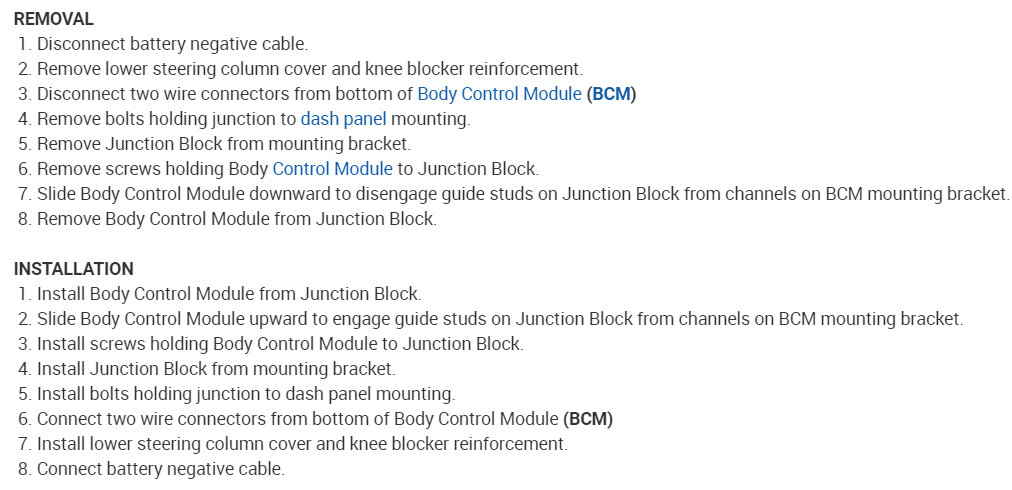

Here is how to change out the BCM, you can get a preprogrammed unit by searching Google or Ebay. Check out the images (below). Please let us know what happens.

Thank you for the info. I cannot go purchasing that expensive test equipment or removing the BCM. I'll probably risk more damage doing the latter. However, I focused on the lock relays in the diagrams you sent as they are in the junction block attached to the BCM. I reseated the driver door relay E and bingo the driver door key problem went away - so far. Passenger and tailgate still have the problem. I haven't tried reseating the other two door lock relays A and B yet, but hope reseating them will resolve the passenger and tailgate key prob.

I reseated the other two "lock relays" (A & B) in the junction block today and again -Bingo! The passenger door and tailgate locks no longer "forcibly bounce back" when the key is used. The key now unlocks and locks the three key locks normally. After all these years I finally have my three key locks back to normal. What a sad situation that the dealer could not figure out the problem so long ago. Perhaps this relay "tip" will help others at no cost should they encounter this problem.
If it helps others with (96 and probably 97-2000 Caravans): Relays A and B are the two relays on the left in the top row. Relay E (driver door) is the relay on the left in the next row down.
