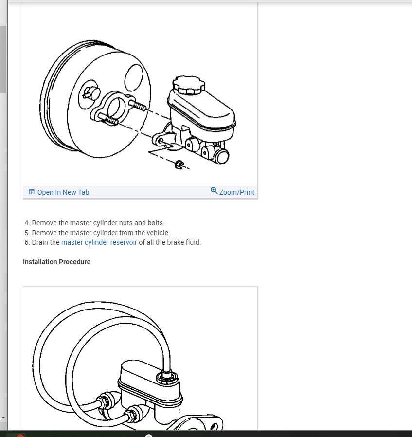

When i bought my truck the ABS and brake light stayed on anytime the vehicle was running, after sitting for over a year and being repaired to some extent (new battery, fresh fuel, fuel pump, front wheel speed sensor, camshaft position sensor, distributor cap, plugs and wires, exhaust with catalytic converter delete.} Now the ABS and brake light will turn off sometimes when i push the brakes and will stay off for the duration (even after turning truck off and back on after several minutes). When the lights turn off the brakes have a strange popping sensation/grinding noise only at the final bit of a complete stop, not when slowing or even when starting from a complete stop or new start, only when i actually get to a complete stop and start to release the pedal to stop slowly does this happen. It doesn't seem to happen if i continuously press the brakes with steady pressure with no slight release as i come to a standstill. Please help me understand what the issue is and how to fix it.
Jun 13, 2022 at 10:23 AM

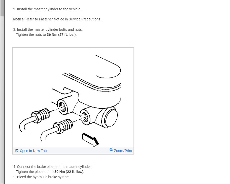

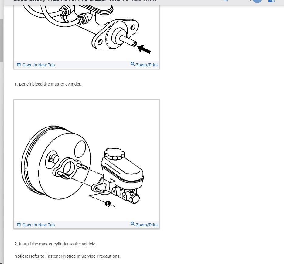

This sounds like the master cylinder is the issue. There clearly could be more issues but the brake pedal feel and noise sound like a master issue.
Here is a guide that will help with this:
https://www.2carpros.com/articles/how-to-replace-a-brake-master-cylinder
Before you replace it, we need to check and make sure you have no external leaks. If you don't then I would replace the master and then recheck the operation of the rest of the system.
I attached the process below from the manual.
Let me know what questions you have. Thanks
