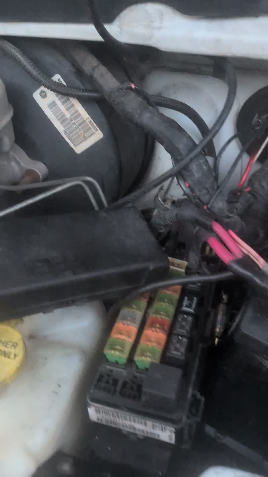

Okay so I wasn't paying attention and it overheated and ever since I've gotten home this constant humming is going on and it won't start. Trying to figure out exactly where it's coming from

To me it seems like the humming is coming somewhere from underneath the battery tray, but there's a metal tray underneath the plastic one and so I really can't get access to there very easily. But to me it kind of seems like maybe that's where the sound's coming from. I'm really not sure

It cranks but won't start ,and the humming noise is constant.Iv changed relays around and even with all of the relays out the hood humming continues.It starts as soon as it gets power even with key out of ignition.

We need to see if we can find where the humming noise is coming from, also is the engine cranking over (starter working)? Can you upload a short video of the noise. Here is the ABS control module, you can try unplugging it to see if the noise goes away.

Okay so yes it seems like it's coming from the ABS module. When I looked at the wiring I did see one red wire that the insulation was rubbed off of so going to try typing that up. The connectors are kind of confusing the two red bits on each side that you have to push those in or do anything with those in order to get the plug off. I'm trying to disconnect it to see if it stops the humming but yes when I put my head on the ABS module that seems where the like. It's where the humming vibration is coming from

Okay so I figured out the connectors got got it unplugged and the humming stopped.finally not humming anymore but will still only crank won't start I'm not positive if it's supposed to start with the ABS module unplugged or not. Was hoping it would but it's still just cranky not starting and the ABS lights on of course. Where should I go from here? Get another module?
