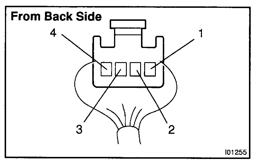

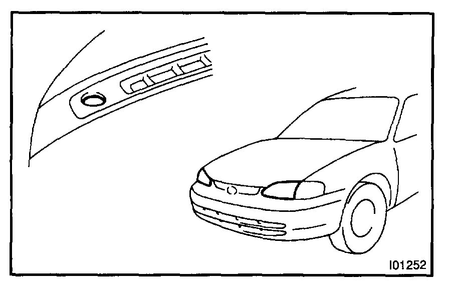

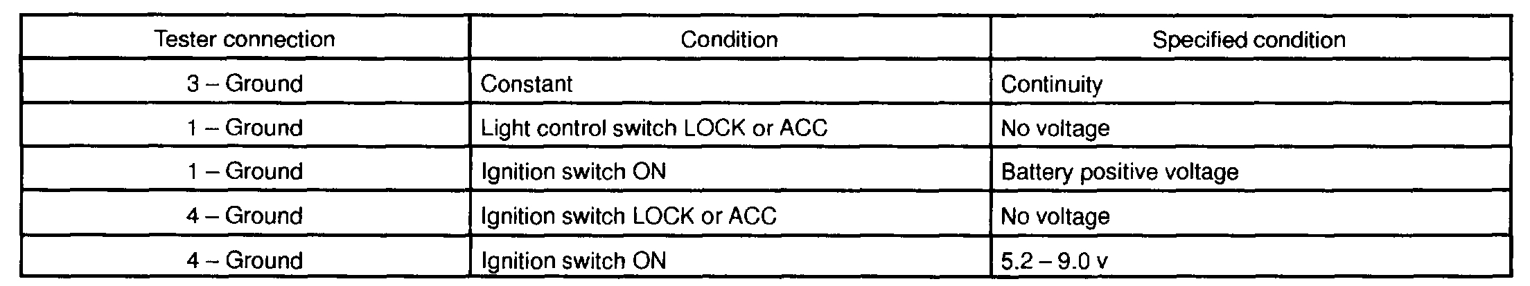

My car's instrument panel light bulb isn't turning on. The warning lights (seat belt, etc) still work but not the light behind the gauges. The headlights work normally for the first 10 or so seconds the car is on, switching between the DRL's and the low beams. After those ten seconds, only the low beams work, and I can't shut the lights off at all. I checked all fuses and they're all fine. Could this be a headlight relay? Thanks.

The idea that the relay could be an issue doesn't see logical for me because the relay doesn't power the instrument panel as you described. I have to be honest, I feel the switch is bad. However, even the light sensor could be causing the headlamps to turn off.
Here are directions for testing both. Let me know what you find. The attached pictures correlate with the directions.

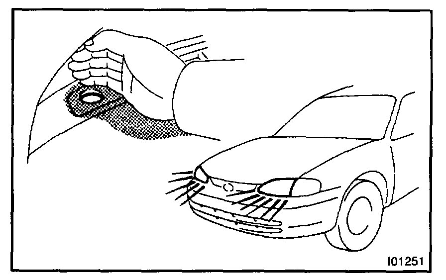

INSPECT AUTOMATIC LIGHT CONTROL
a. Turn the ignition switch ON.
b. Turn the light control switch to OFF.
c. Parking brake lever released.
d. Gradually cover the top of the sensor.
e. Verify that the lights should turn ON the accessory lights and the headlights.
pic 2
d. Cover the top of the light sensor.
e. Head and tail lights turn ON.
f. Gradually expose the light sensor.
g. Tail light turn OFF and DRL light turn ON.
INSPECT LIGHT-OFF CONDITION
d. Lights auto ON:

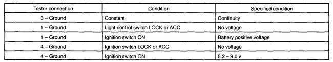

INSPECT AUTOMATIC LIGHT CONTROL SENSOR CIRCUIT
pic 3
pic 4
a. Disconnect the connector from the sensor and inspect the connector on the wire harness side, as shown in the chart.
If circuit is as specified, perform the inspection on the following.
If the circuit is not as specified, inspect the circuit connected to other parts.

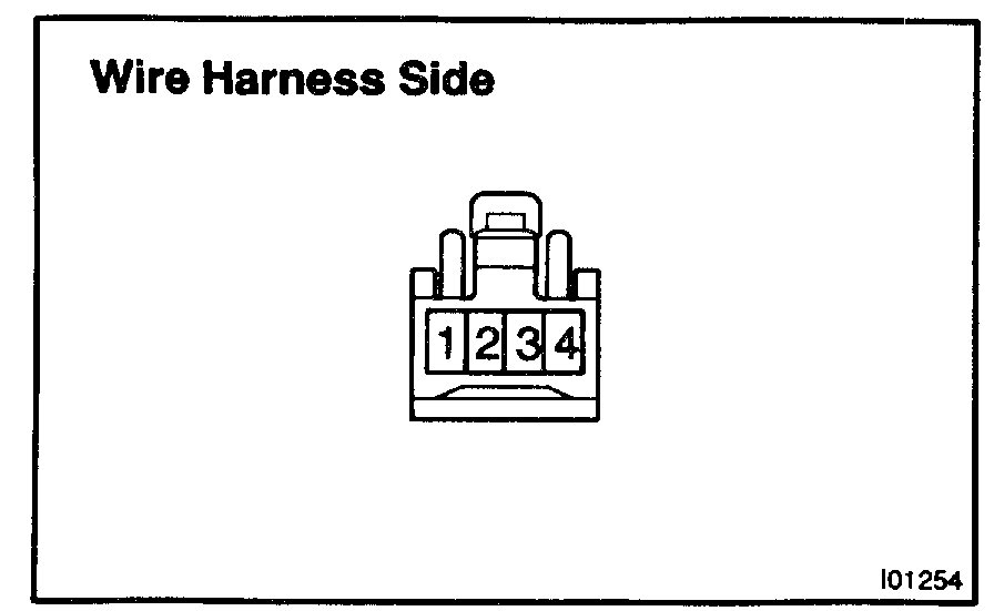

pic 5

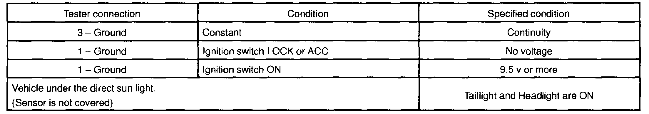

pic 6
b. Connect the wire harness side connector to the sensor and inspect wire harness side connector from the back side, as shown.
HINT:
- Ignition switch ON.
- Light control switch AUTO.
- Vehicle's surroundings are bright.
If circuit is as specified, try replacing the sensor with a new one.
