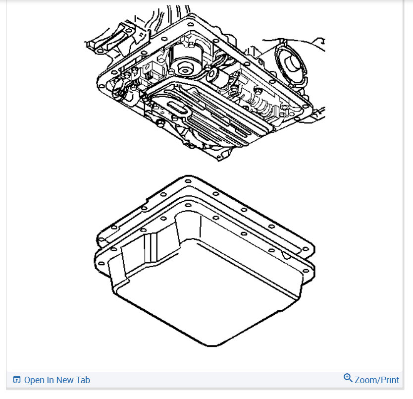

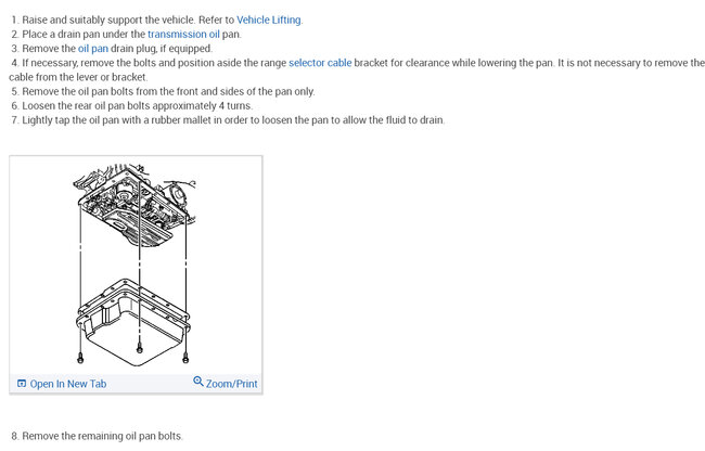

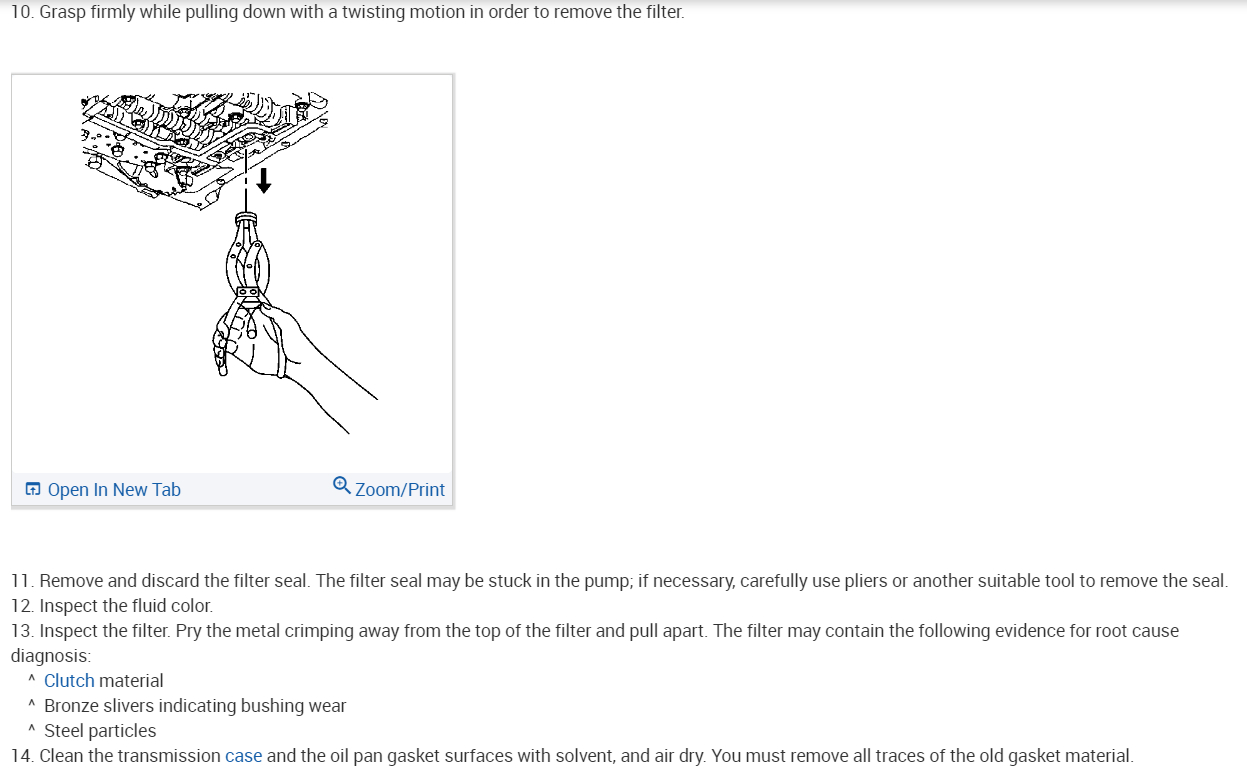

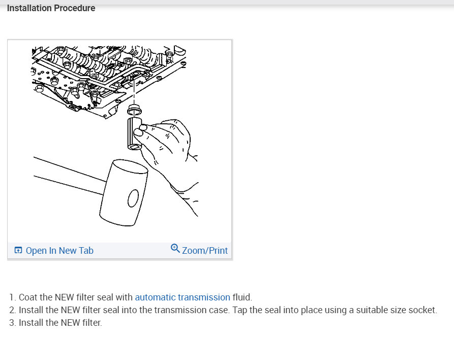

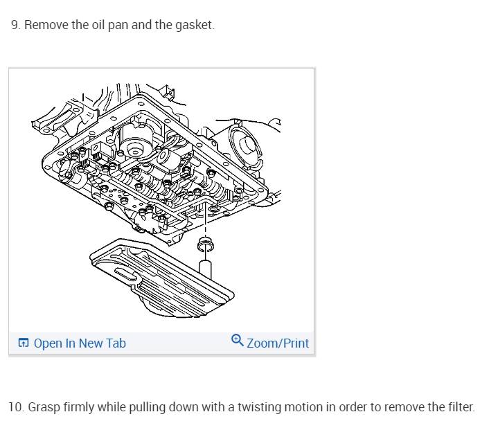

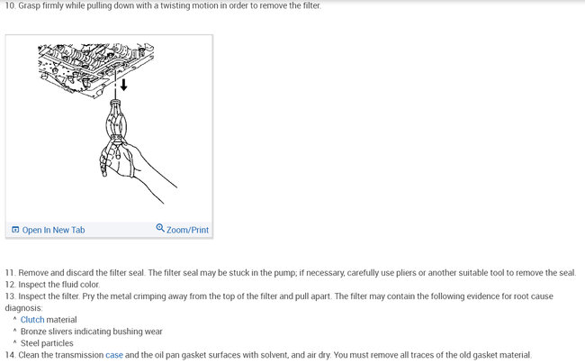

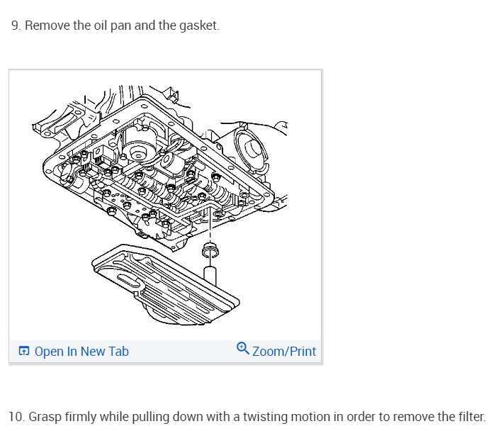

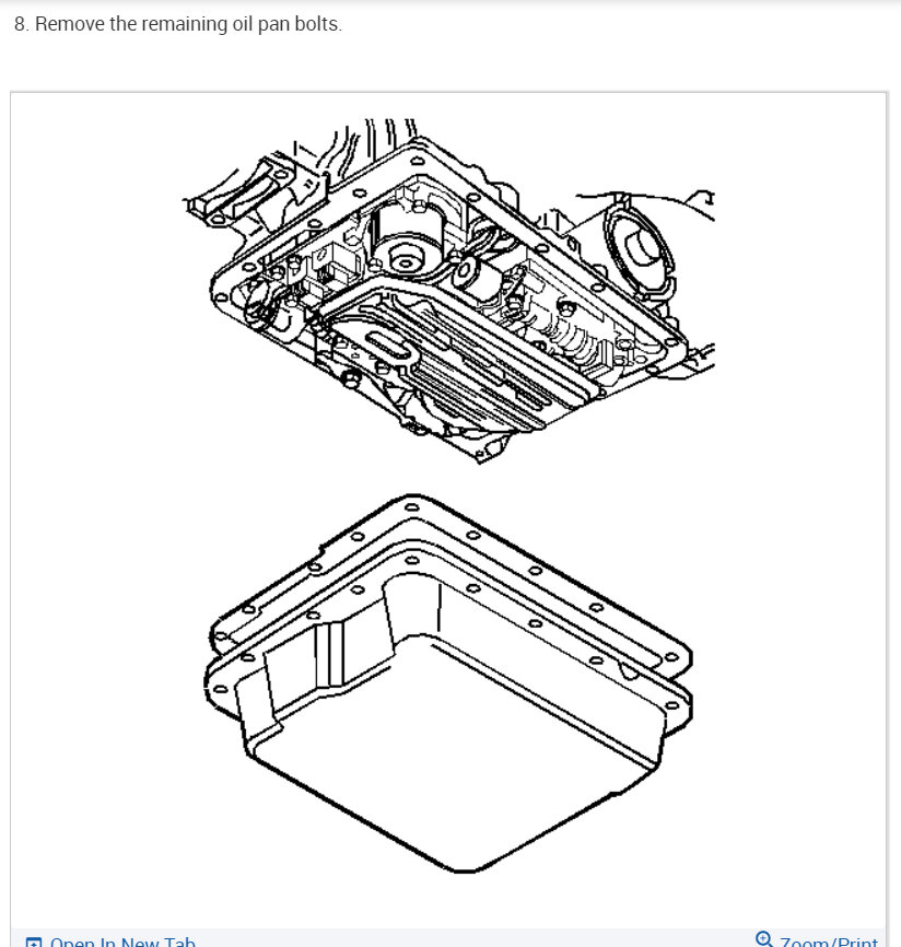

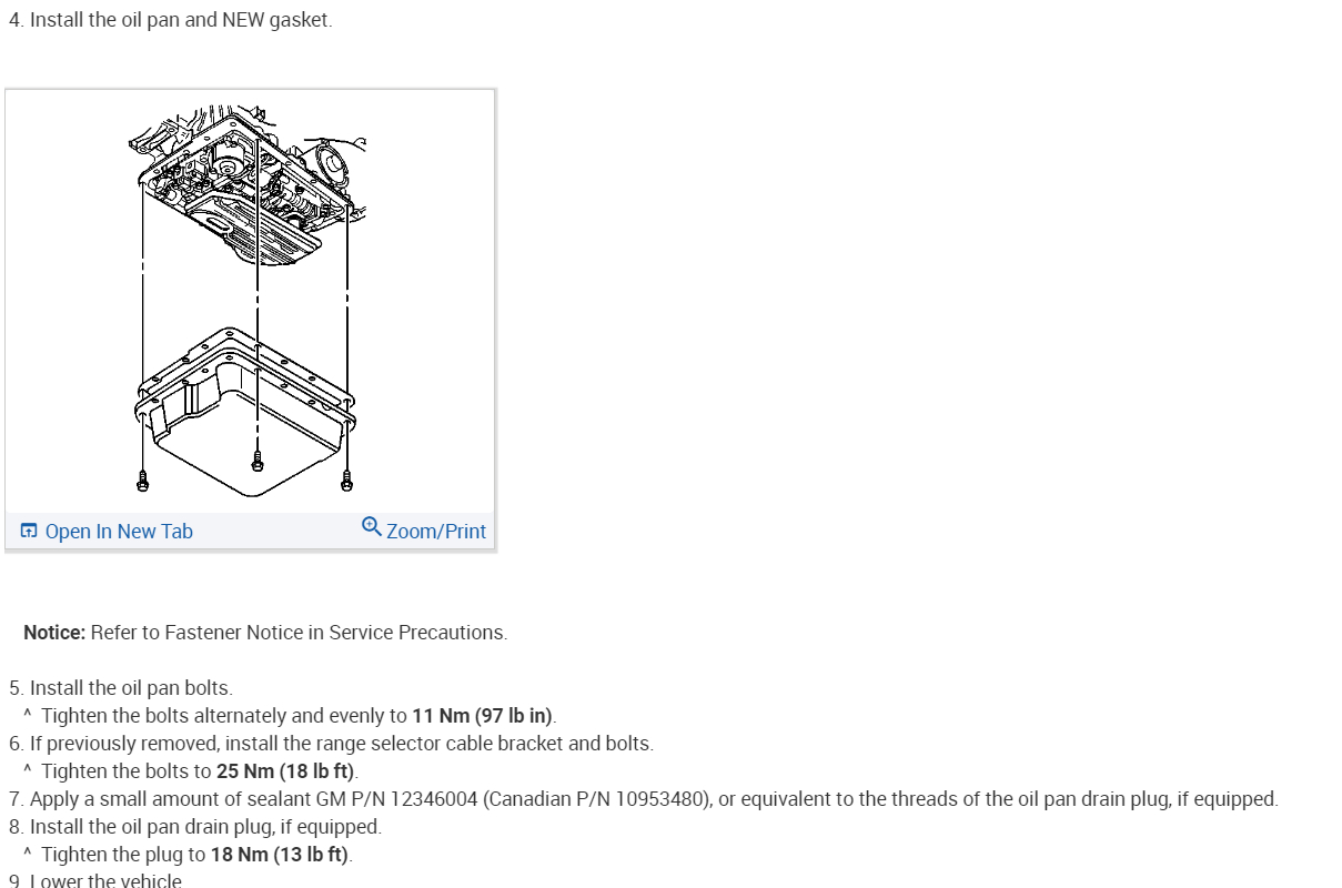

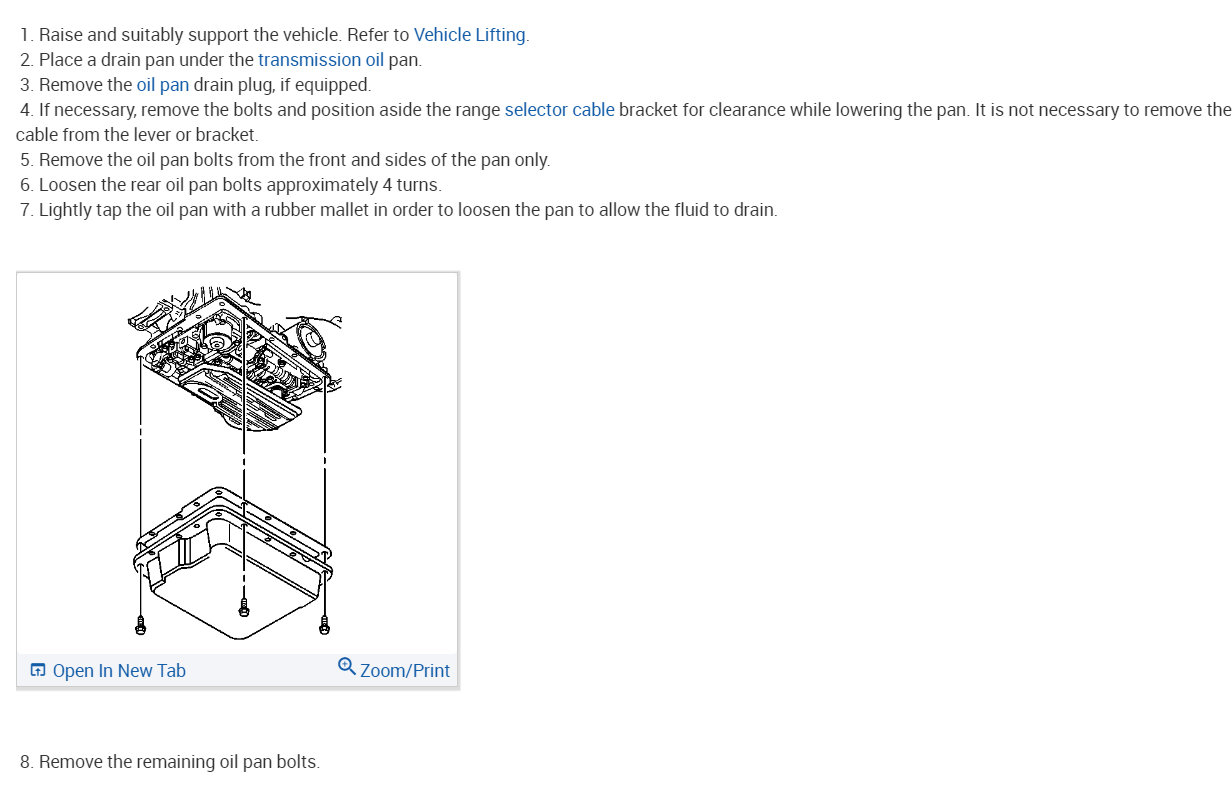

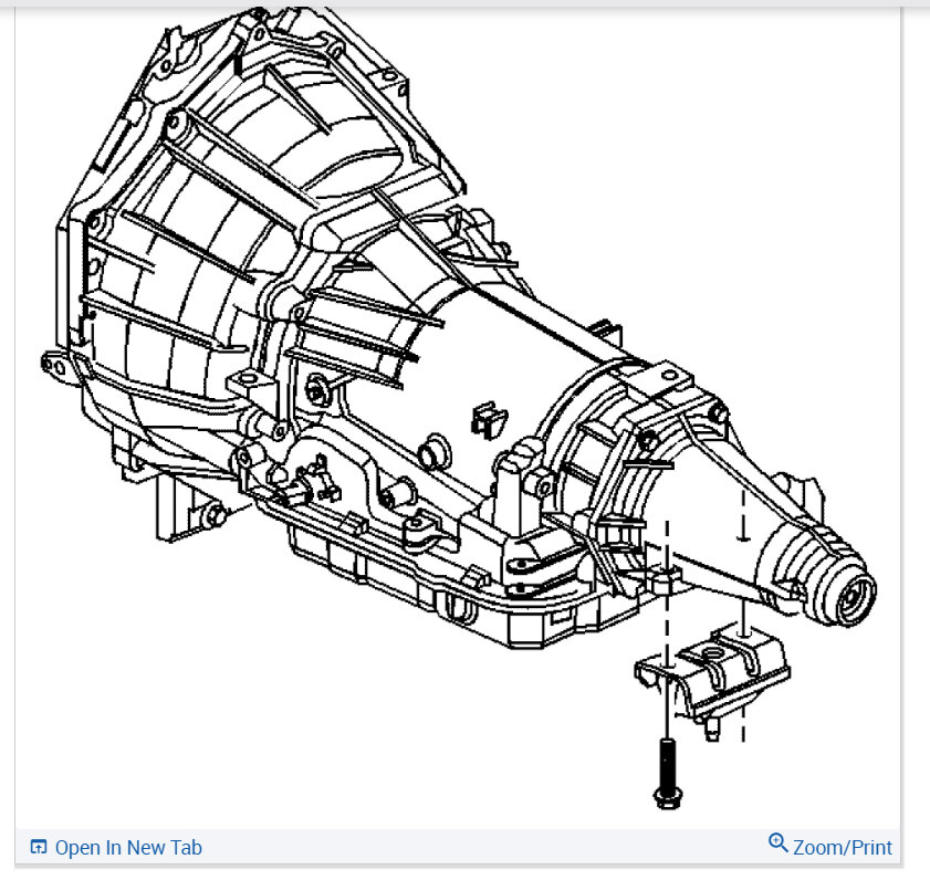

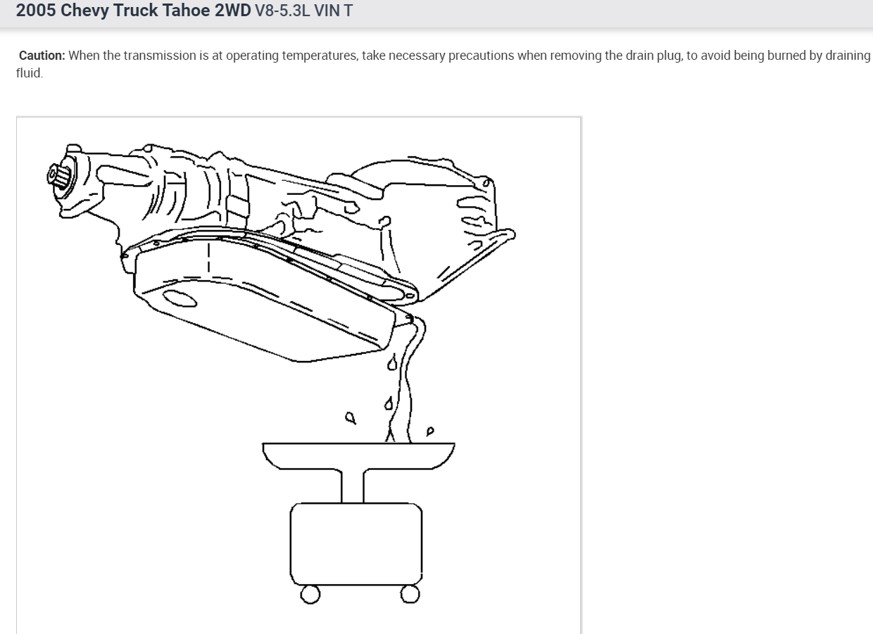

Yes, it does sound like this could be the problem, I would try to service the transmission and I would run the codes to see if anything is stored. Here are two guides to help and I have included instructions in the images below for your car:
and
Fill the transmission to the proper level with DEXRON III transmission fluid.
Check the Cold fluid level reading for initial fill only. Inspect the oil pan gasket for leaks.

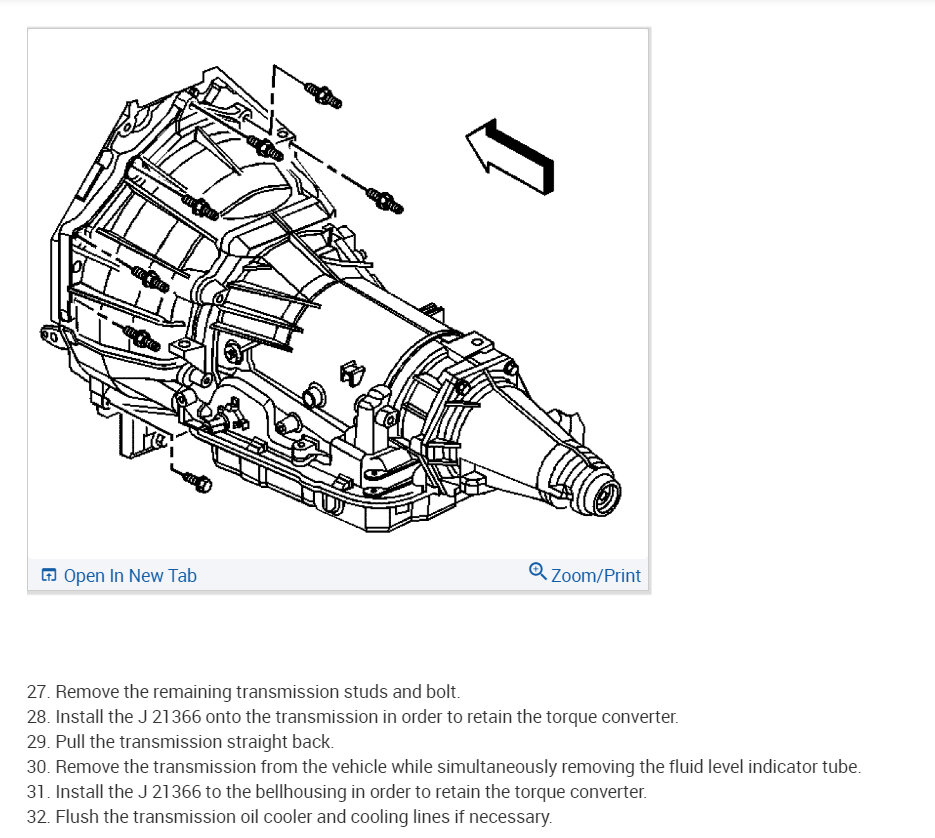

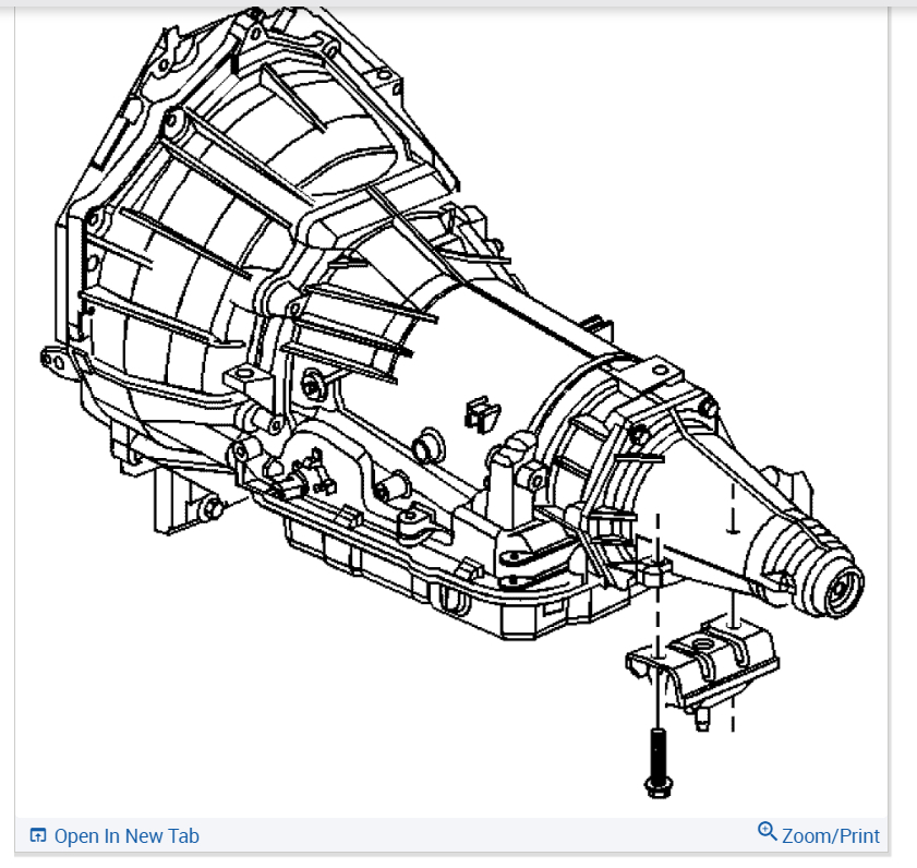

I guess I spoke too soon. Transmission gave out on me last night. Making bad grinding noises, won't go in to reverse and seems to have no 1st gear. Looks like it's replace it or find another vehicle. Thanks for your help anyway.
Sep 26, 2023 at 3:36 AM
  • 55,748 POSTS

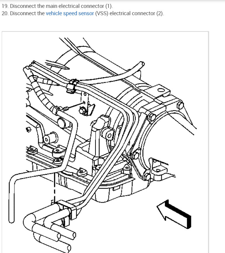

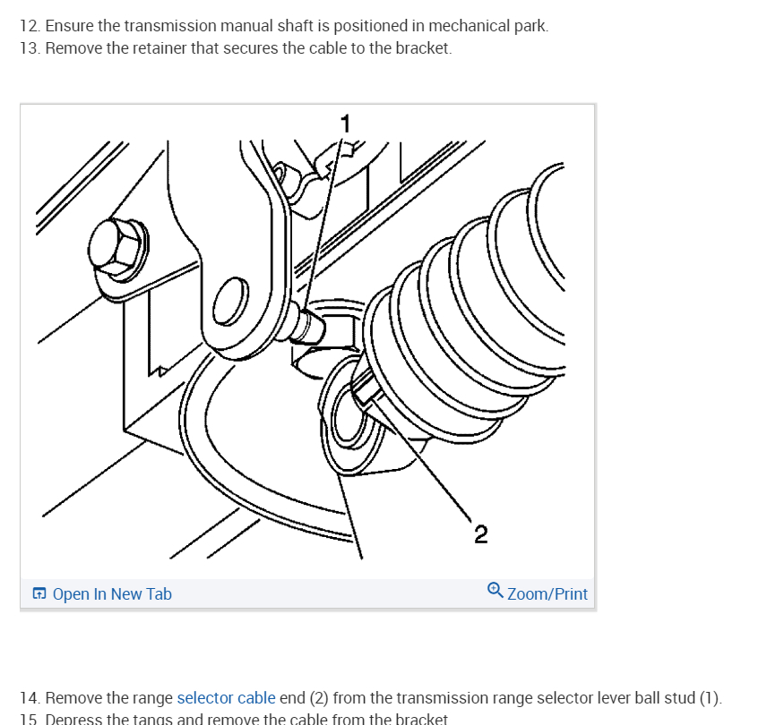

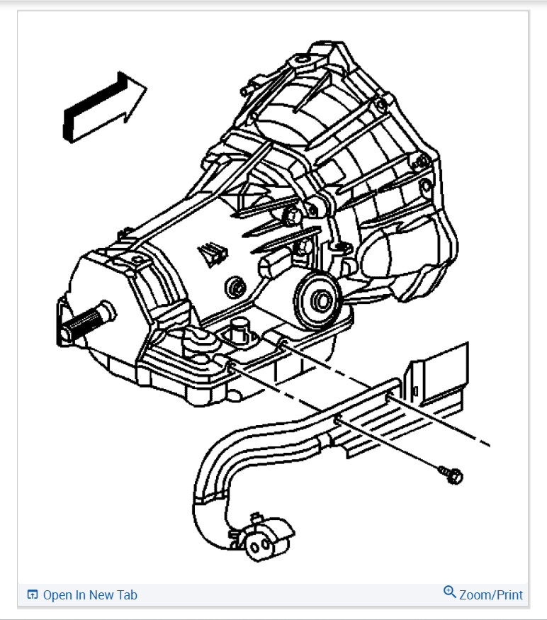

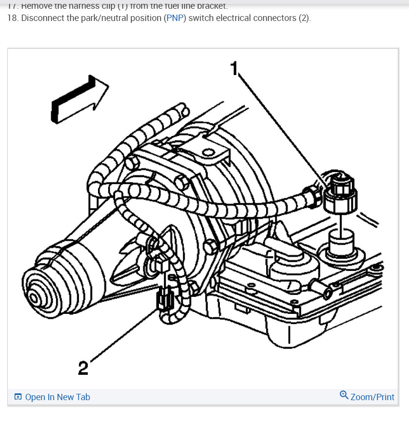

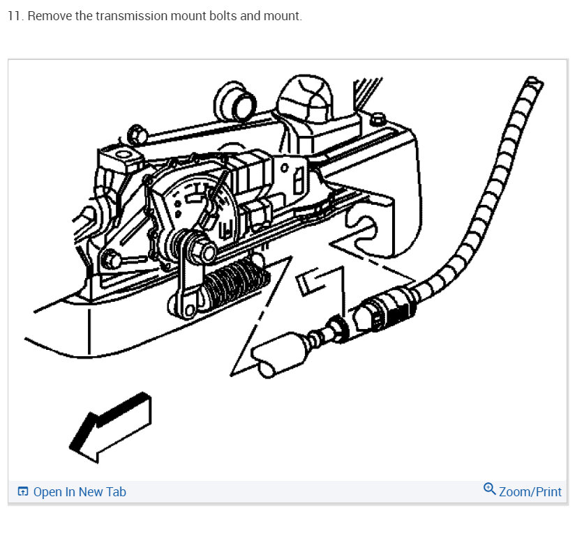

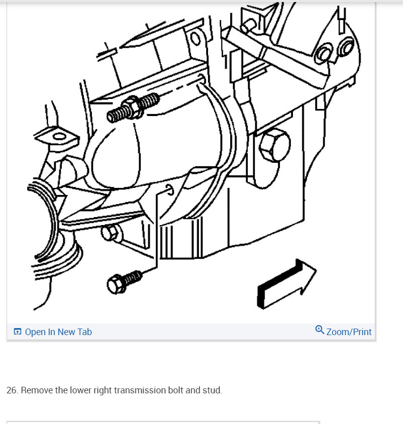

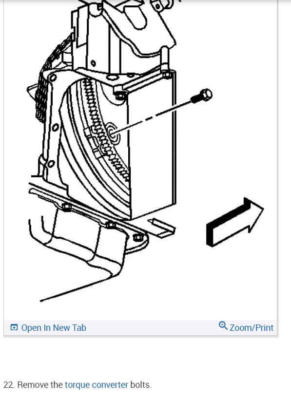

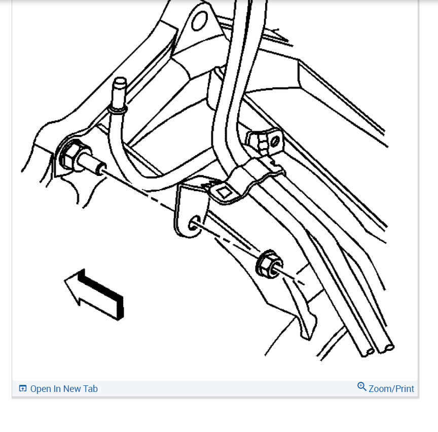

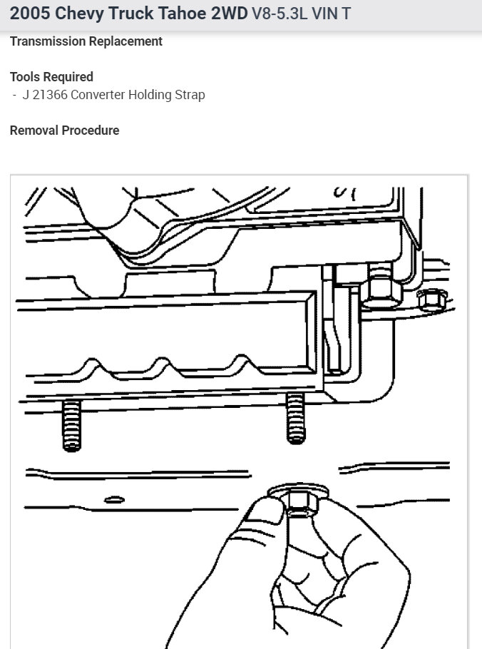

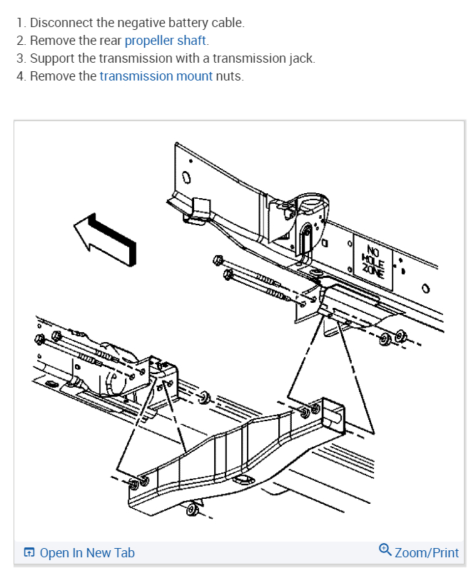

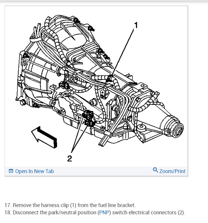

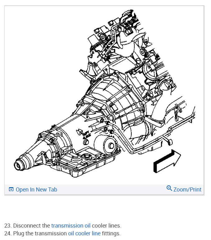

Yep, noises are a bad sign, it sounds like you need a rebuilt unit. Here is how to R&R the unit in the images below. This video shows the job being done on a similar car, but the procedure is the same.
https://youtu.be/3vJAojsrfuU?si=aZW6hR6dQO6xjMO6
Check out the images (below). Please let us know how it goes.
