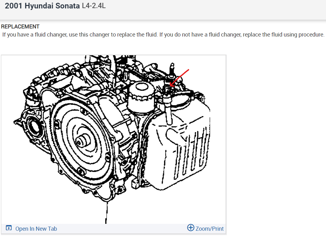

I bought my vehicle listed above a couple months back and drove smoothly. Every time I turned it on and went then one afternoon my car decided to start making some loud revving sounds and completely will not go faster than twenty-five miles per hour. Go about 3 blocks and it completely stops moving. No drive forward no drive backwards nothing turns on like a dream still and sounds like everything is okay, but it obviously is not. Oh, I got it to move forwards for a brief second before it never moved again. Please anyone, I could use help because a mechanic I am not. And will take all the advice I can get from anyone who is knowledgeable.

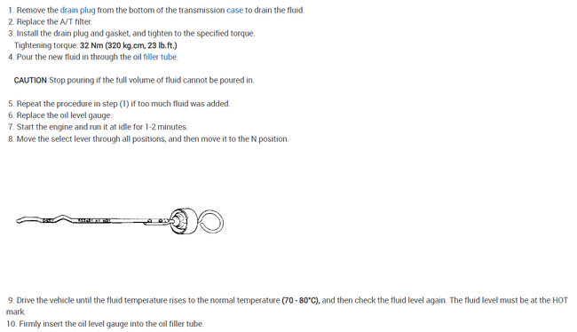

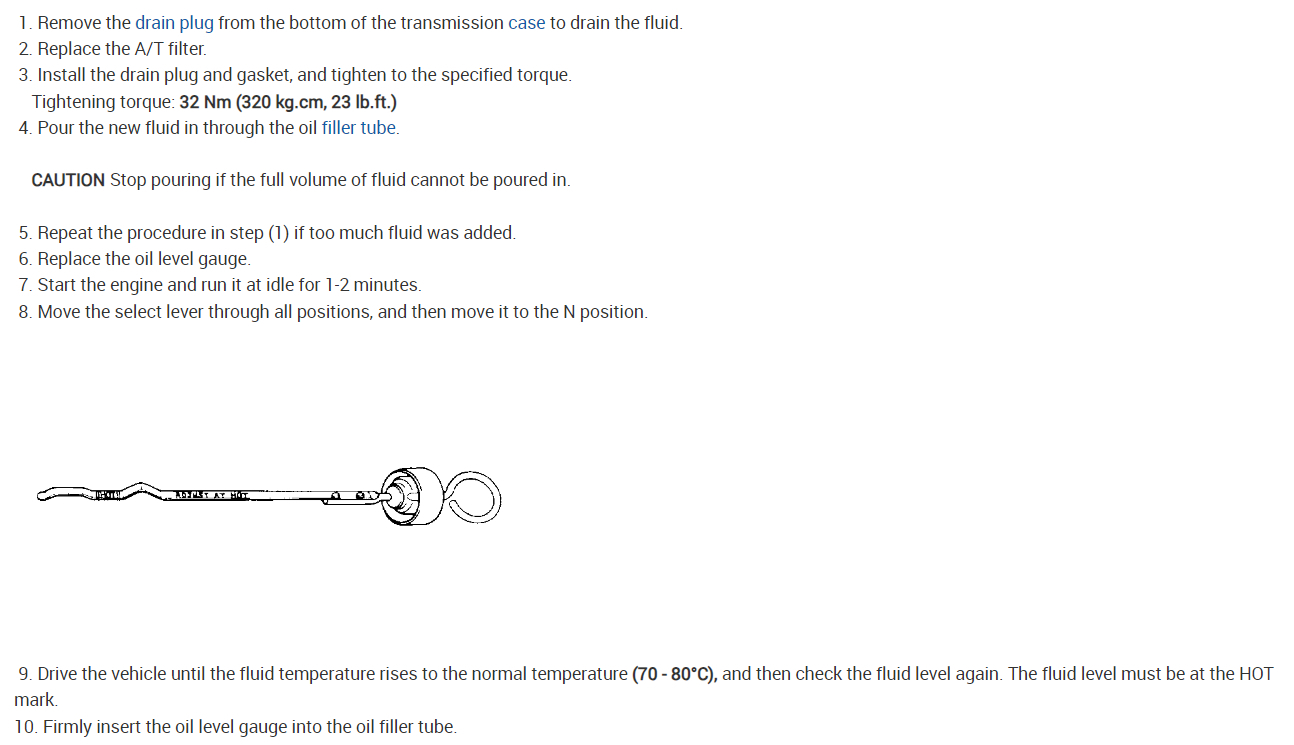

Sure, I can help you, the first thing I would do is check the transmission fluid level. here is a guide to help and I have included instructions in the images below for your car.
https://www.2carpros.com/articles/how-to-check-and-add-transmission-fluid
Fluid Types
Updated by TSB 13-AT-011
Fluid .................... SP-III
Capacities
Transmission Fluid .................... 7.8L (8.2 Qt)
Check out the images (below). Please upload pictures or videos in your response of any problems so we can see what to help you with.
