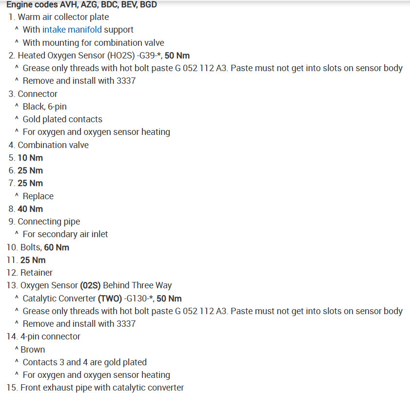

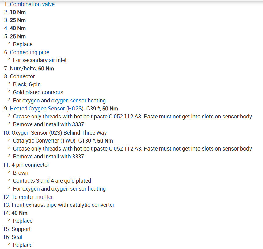

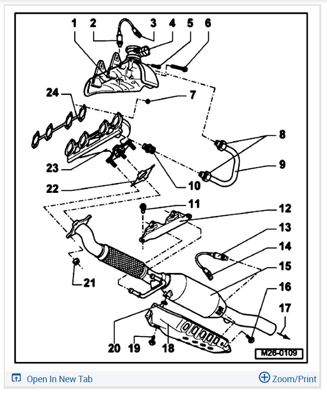

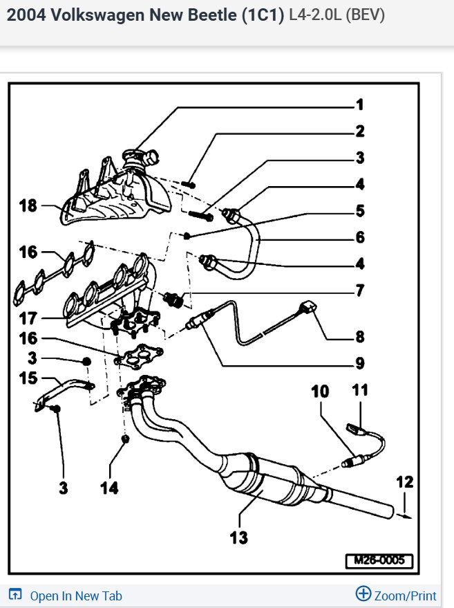

What parts should I order to repair this?
Feb 11, 2025 at 4:55 PM
CANNON1349
  • 861 POSTS
Hello, I am sorry to hear about this. We will need to know the engine size and at what point the exhaust was cut. If you can provide pictures that would help also.
Please let us know,
William
Feb 12, 2025 at 4:11 AM
  • 54,837 POSTS
This video can help:
https://www.youtube.com/watch?v=1Hh12_mWw8k
Check out the images (below). Please upload pictures or videos in your response of any problems so we can see what to help you with.
