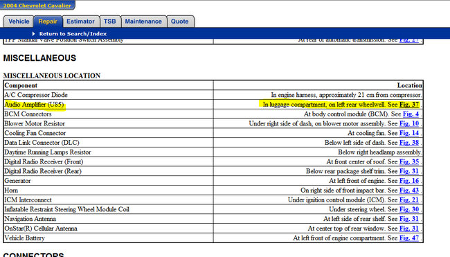

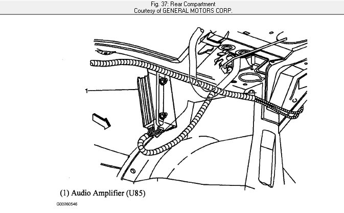

Where is the stock amplifier located on my car? Three speakers quit working was trying to find the problem.
Mar 24, 2019 at 3:32 AM
SEVAG P
  • 405 POSTS
Hello thanks for using 2CarPros.
Amplifier is located in luggage compartment on left rear wheel well check figure 1 and 2.
Problem can be water leak inside the luggage compartment. check amplifier and its connector for any sign of water traces or corroded wires.
