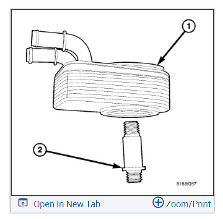

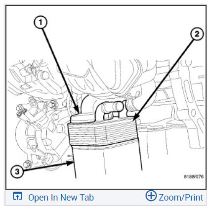

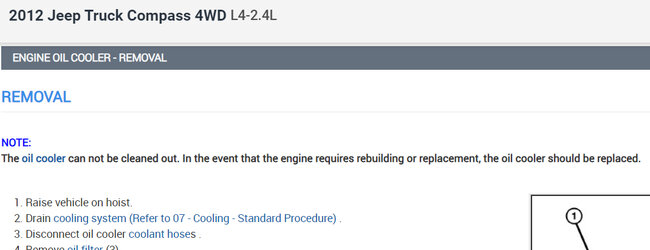

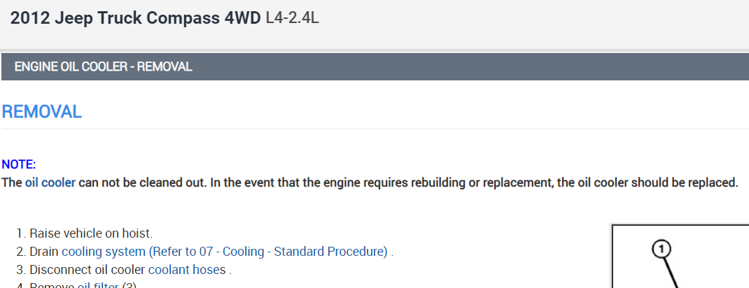

Did the vehicle listed above come stock with an oil cooler? I don’t believe I have the tow package and the engine is shot from a previous owner. Doing a swap on it but not sure if they came stock with a cooler or not. I wanted to make sure before I ordered an engine from lkq.

Yep, it sure did, the engine oil cooler is what you install the oil filter onto, here is what it looks like. Check out the images (below). Let us know if you need anything else.
