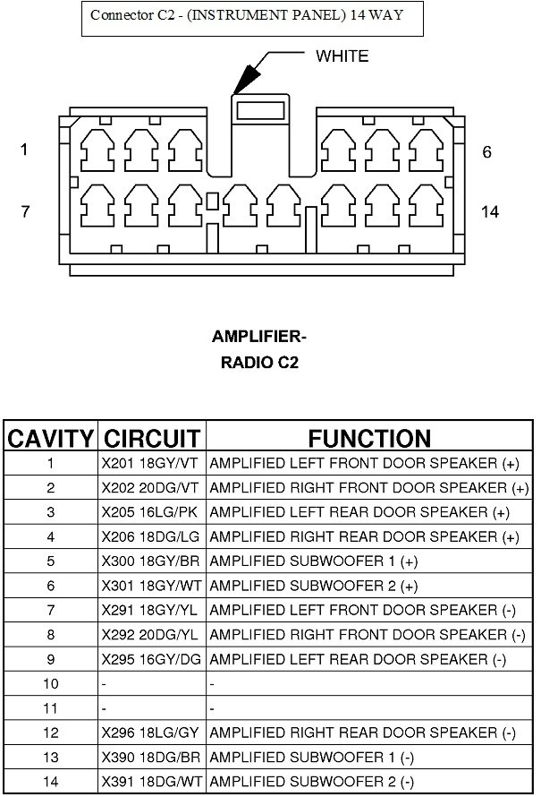

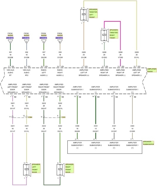

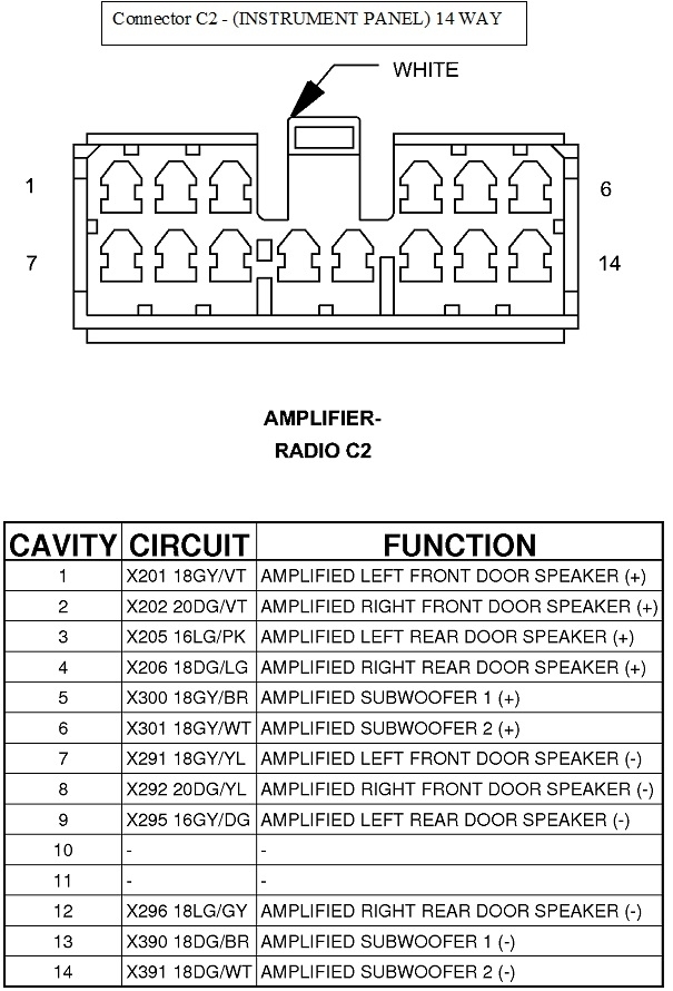

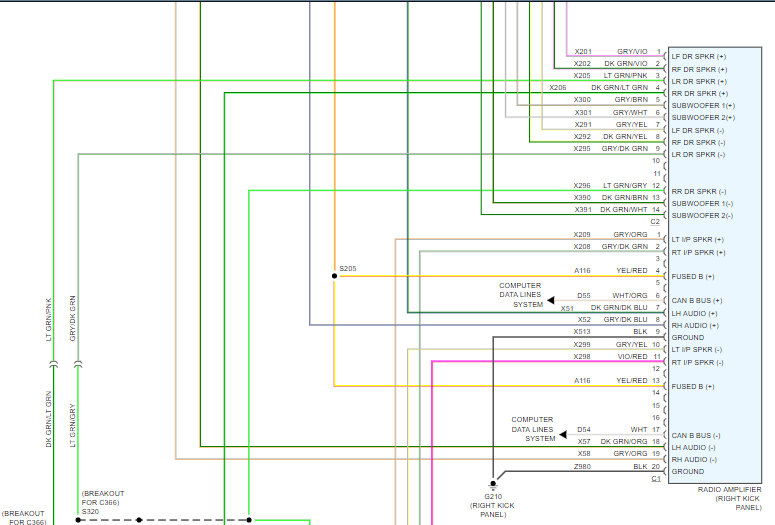

I’m trying add a sub woofer to my car, I can’t seem to fine the wiring diagram for the amp.

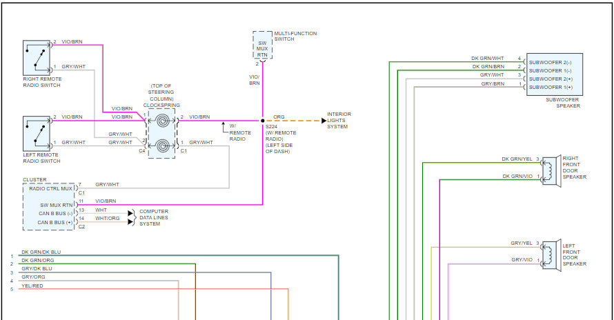

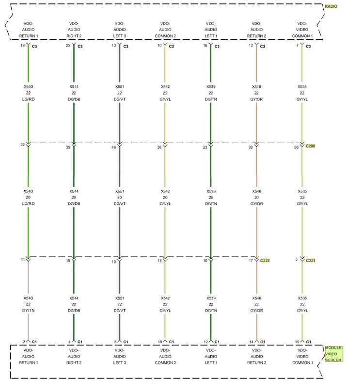

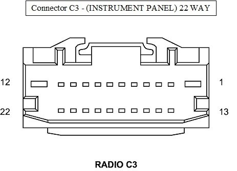

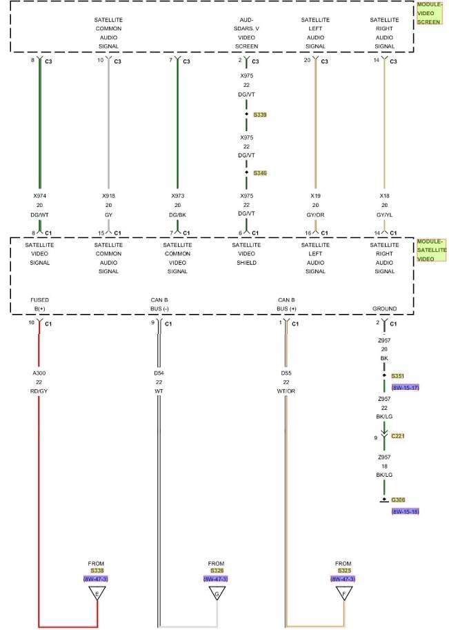

This was a pretty tedious project, and you may find the diagrams too hard to read. If so, let me know which ones you need, then I'll split them up and enlarge them for you.
Jul 3, 2020 at 2:54 PM

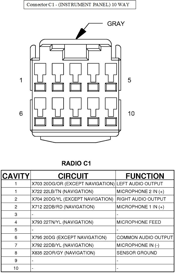

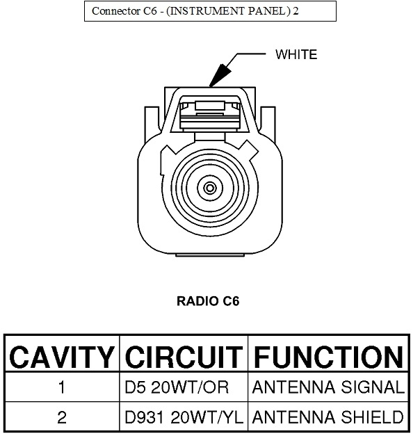

JOEYSKATER16

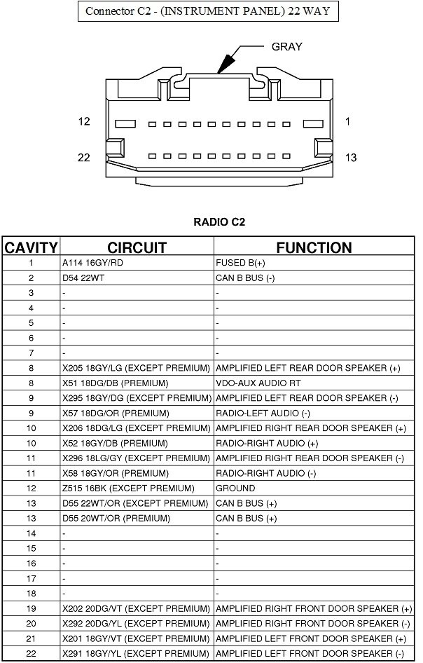

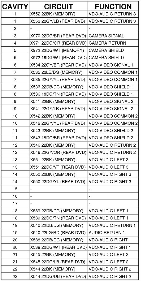

yes pic number 15-16-17 even though i think those are for the radio not the amp.

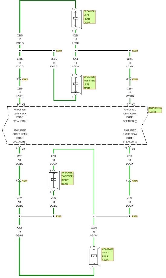

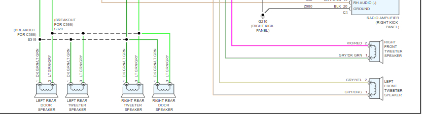

DANNY L
  • 5,648 POSTS
Hello, I'm Danny.

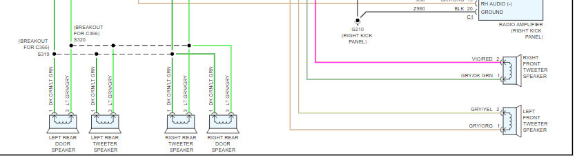

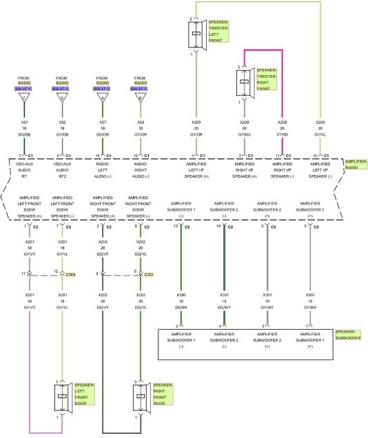

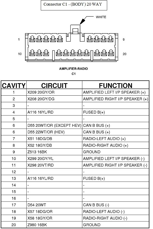

Here is a wiring diagram for your car's premium sound system amplifier which is mounted in the right kick panel. I've cut the picture into 3 pieces so you can view larger.Hope this helps and thanks again for using 2CarPros.

Sorry, that I overlooked the amp connectors. That was the one mistake I was allowed this week!
