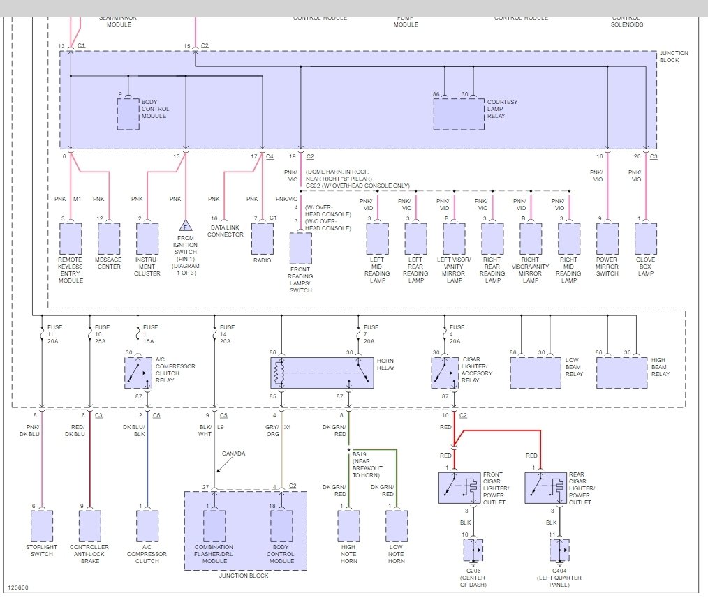

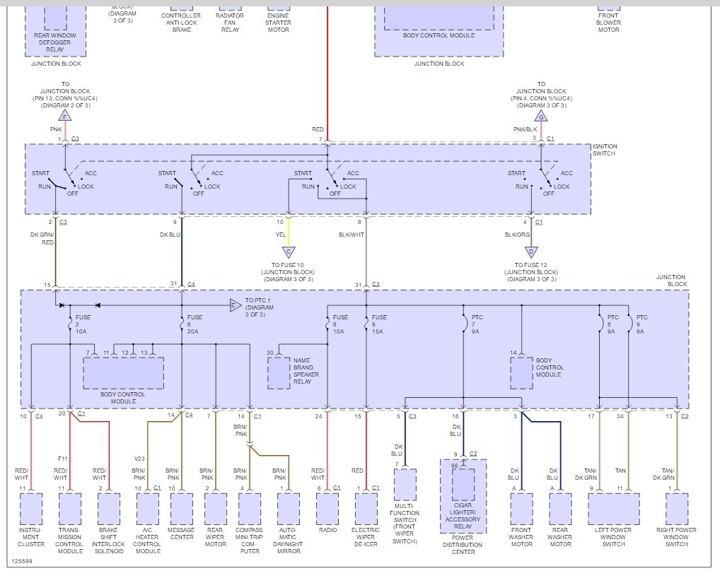

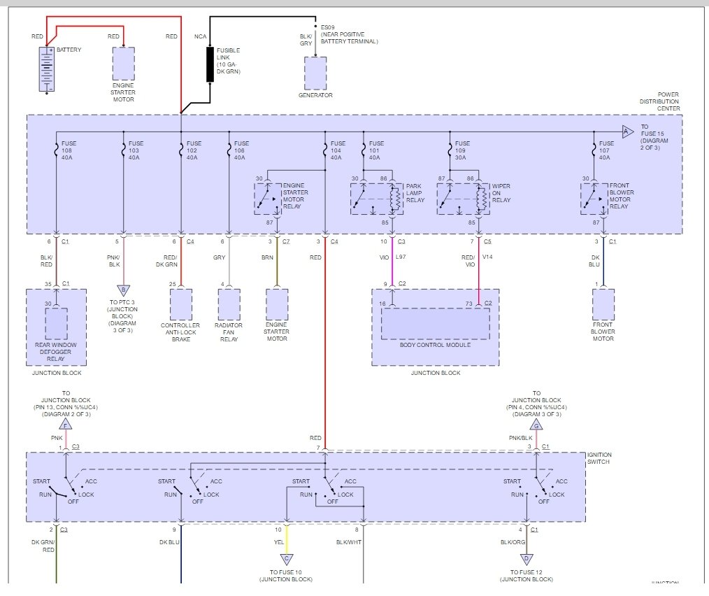

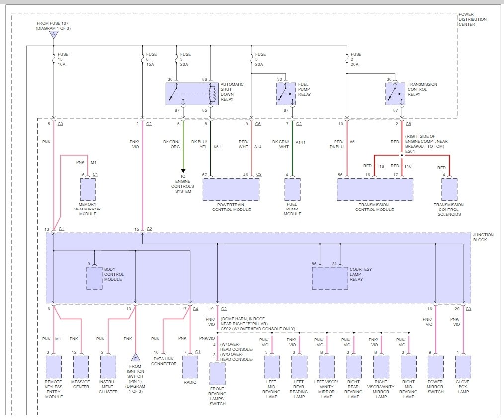

car ran fine last night got up this morning and it wont start. About a month ago I replaced the cam sensor and the crank sensor. I also replaced the computer for the same problem as now no spark. I checked fuses and replaced coil pack this morning. i checked for wiring problems, found none. Any ideas?
Oct 7, 2016 at 5:07 AM
  • 55,743 POSTS
These cars had a big problem with the ignition switch not delivering power to all of the power outputs, here is a wiring diagram and a guide to help you troubleshoot the problem.
One of the wiring diagrams shows the auto shut down relay which they also had problems with
Please let us know what you find so it will help others.
