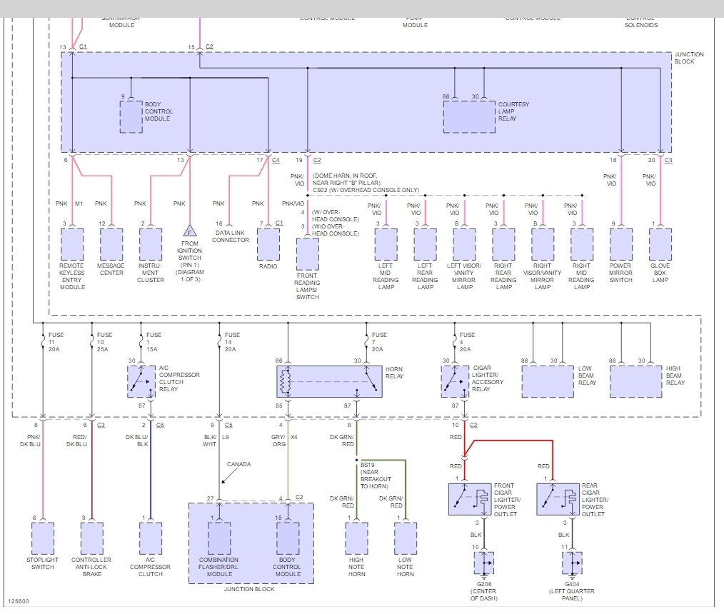

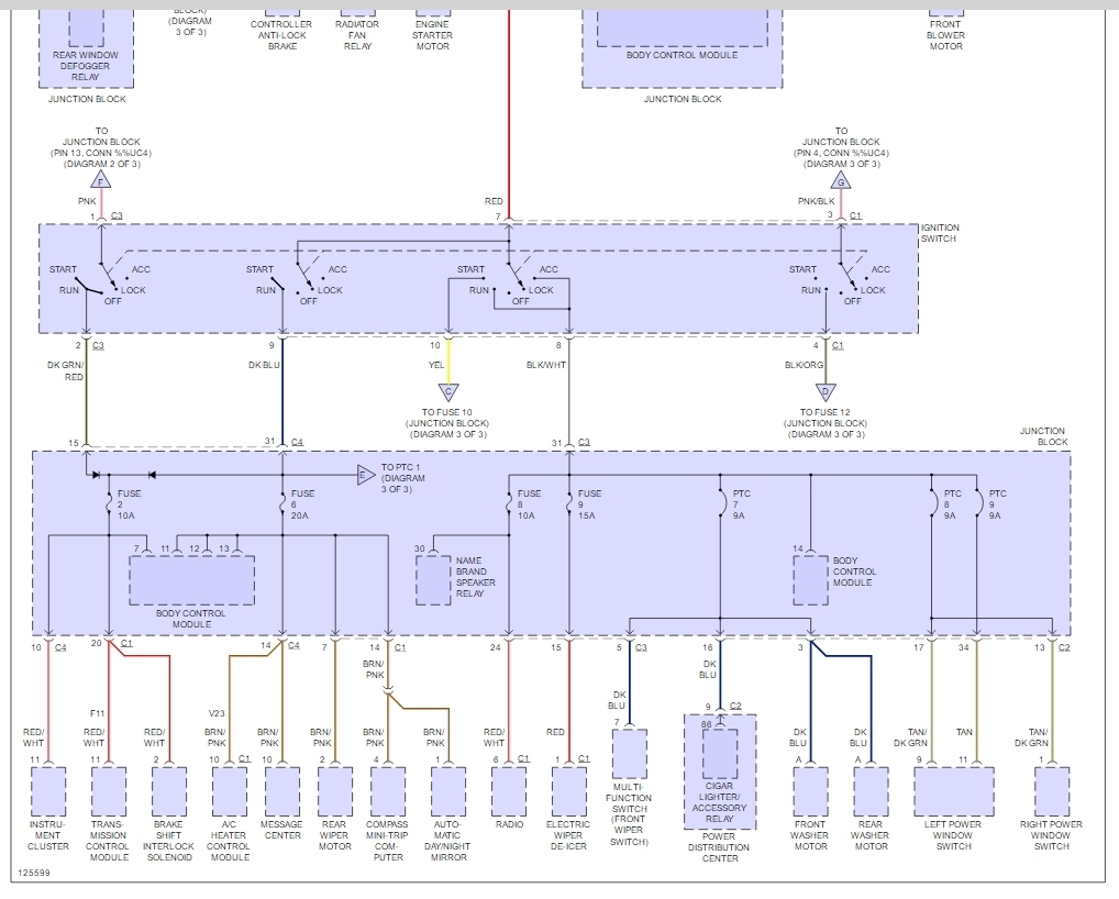

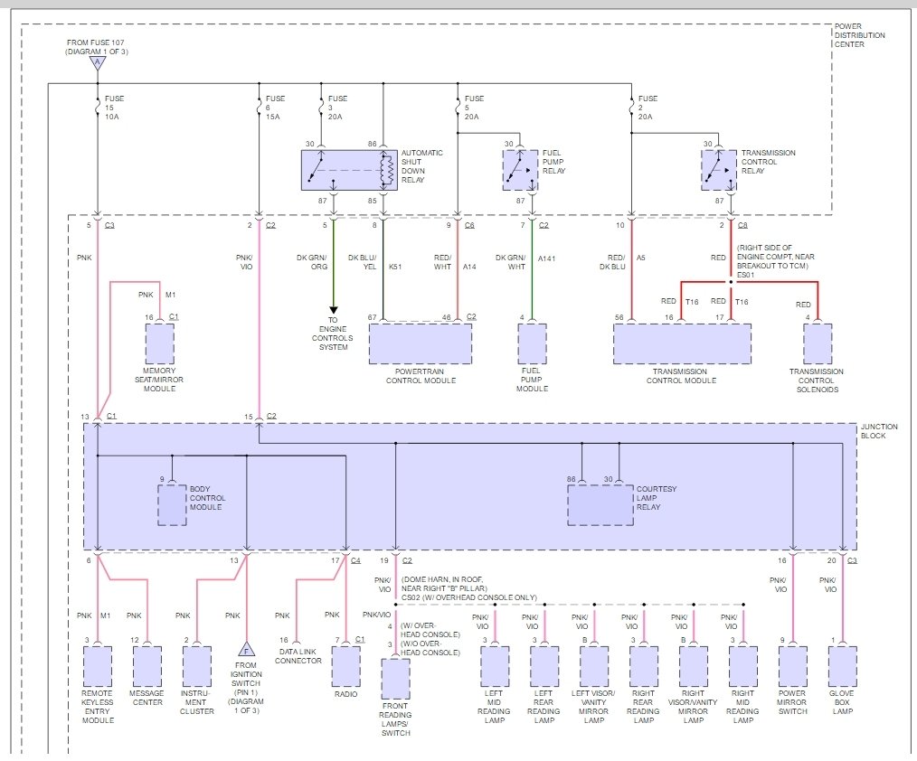

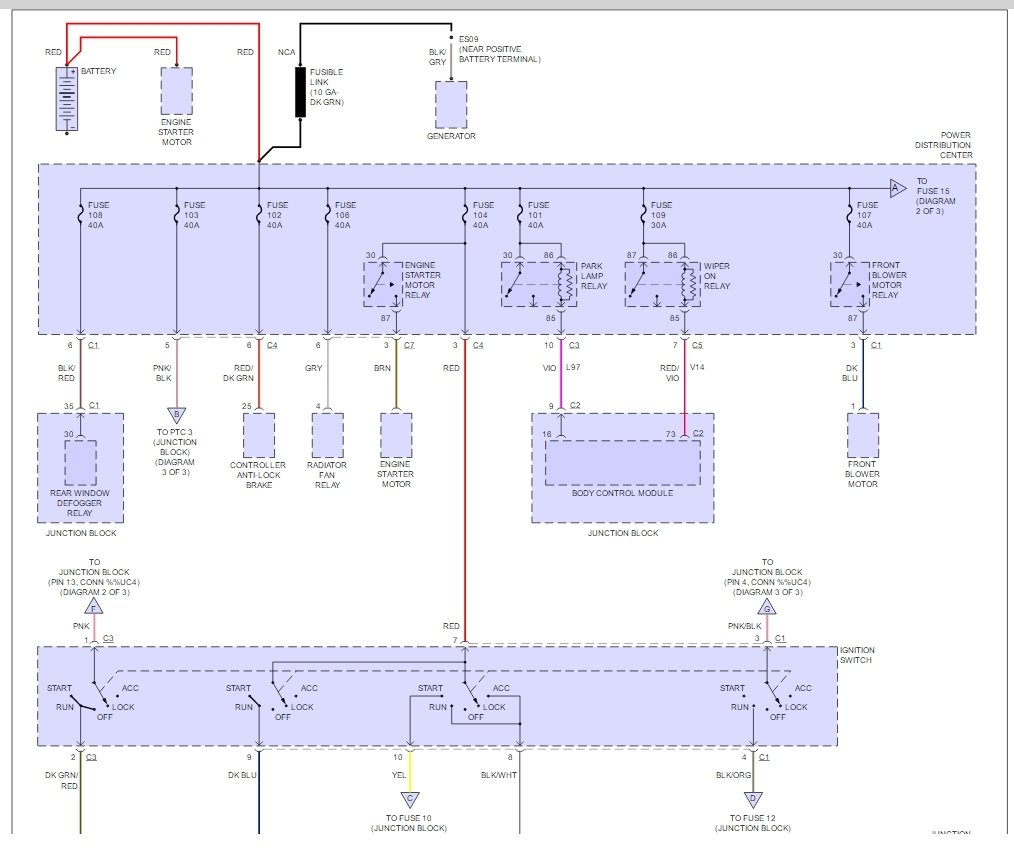

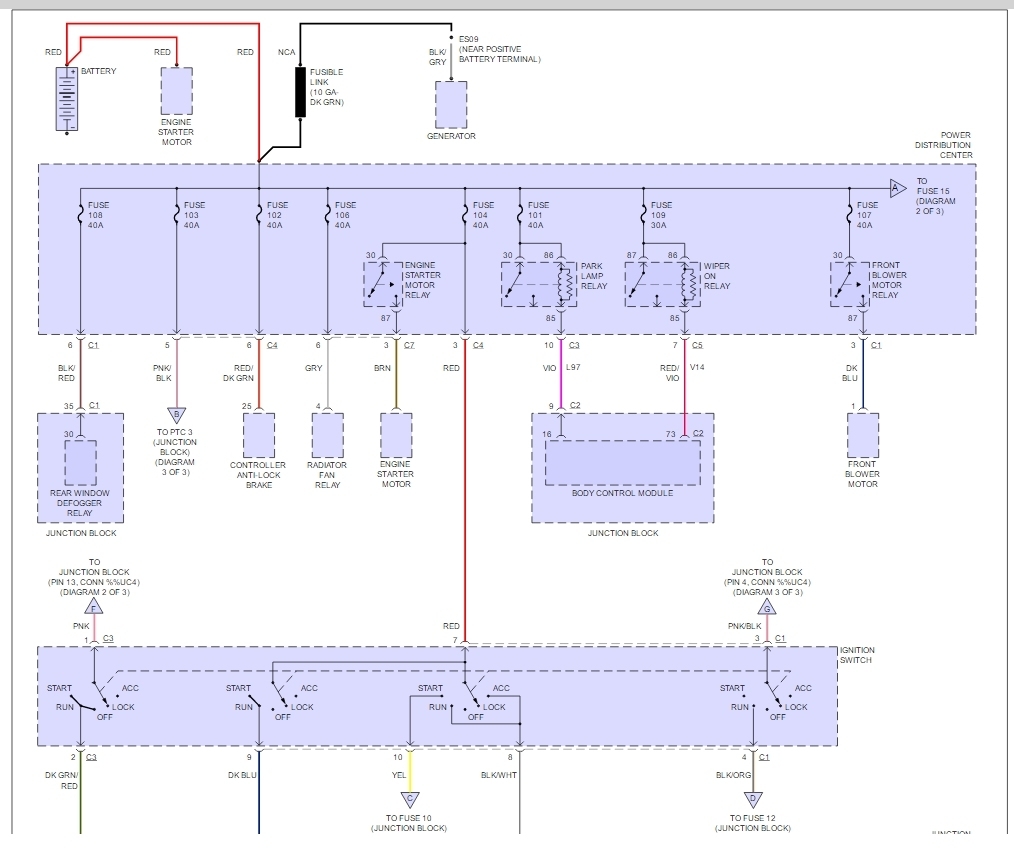

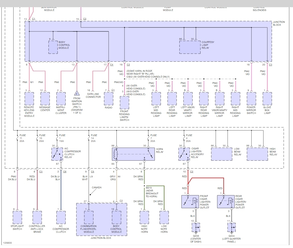

These cars had a big problem with the ignition switch not delivering power to all of the power outputs, here is a wiring diagram and a guide to help you troubleshoot the problem.
One of the wiring diagrams shows the auto shut down relay which they also had problems with
Please let us know what you find so it will help others.
Best, Ken
