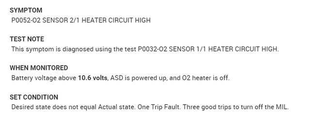

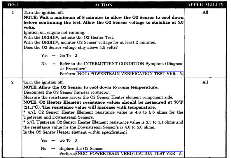

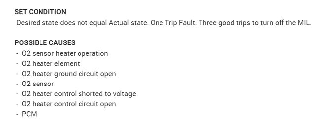

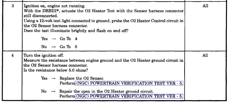

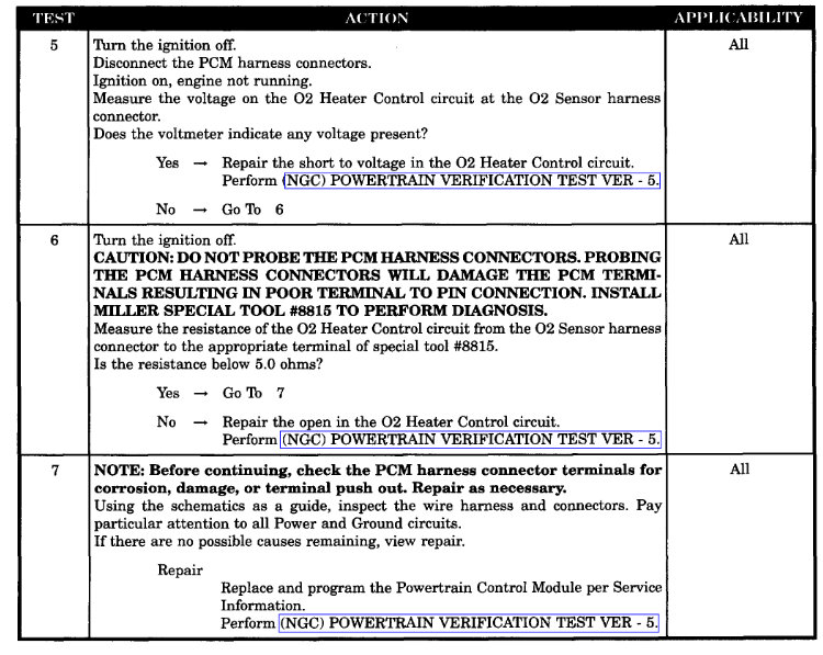

Two of the codes are related to a misfire and one is bank 2 sensor 1 heated oxygen sensor. What color smoke are you seeing? Are there any exhaust leaks present at the exhaust manifolds? Also, is it possible for you to check the short-term fuel trims at operating temperature? You may not be able to do that if your scanner doesn't have live data.
Also, the oxygen sensor code information is below. It includes the description of the code as well as the diagnostics. Take a look through them and let me know if you are comfortable performing them.
