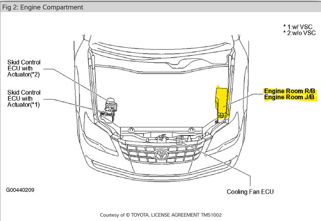

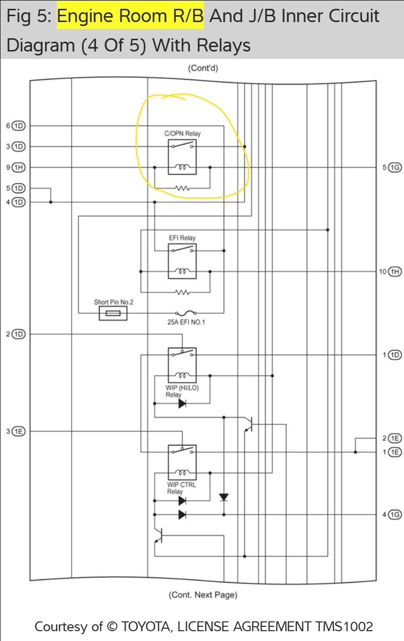

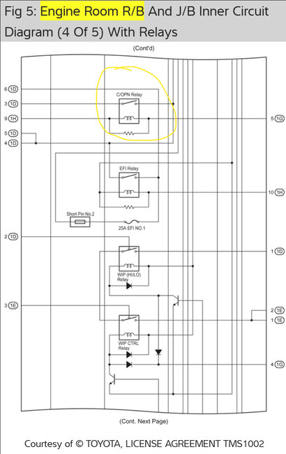

The Circuit/Opening Relay that powers fuel pump, and sends fire to camshaft sensors.

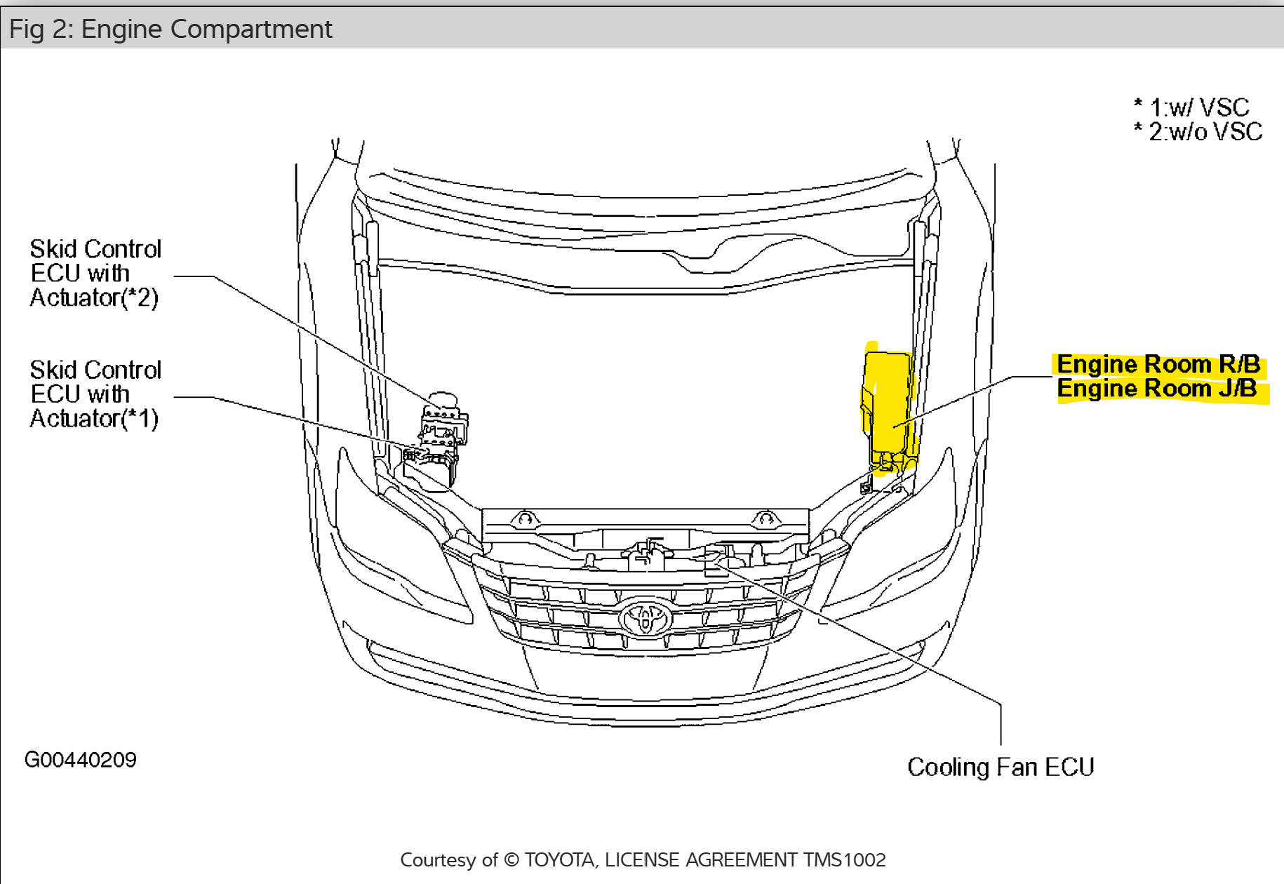

It is inside the engine room junction block on the driver's side fender. It is internal and non-replaceable.

Do you know if there is an image of it?
Jun 9, 2023 at 10:19 AM
JOSHUABITNER
  • 8 POSTS
The C/OP relay that is.
Jun 9, 2023 at 10:20 AM
BRENDON S
  • 653 POSTS
Hello JOSHUABITNER,
No. This is best I can find for it.
