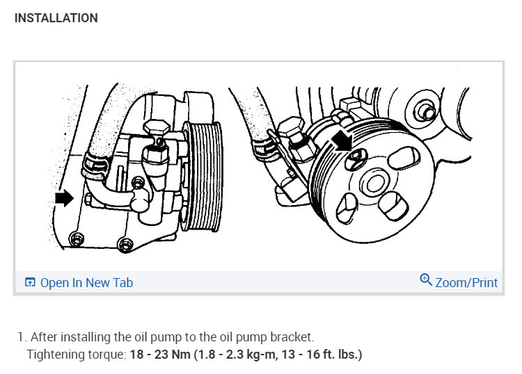

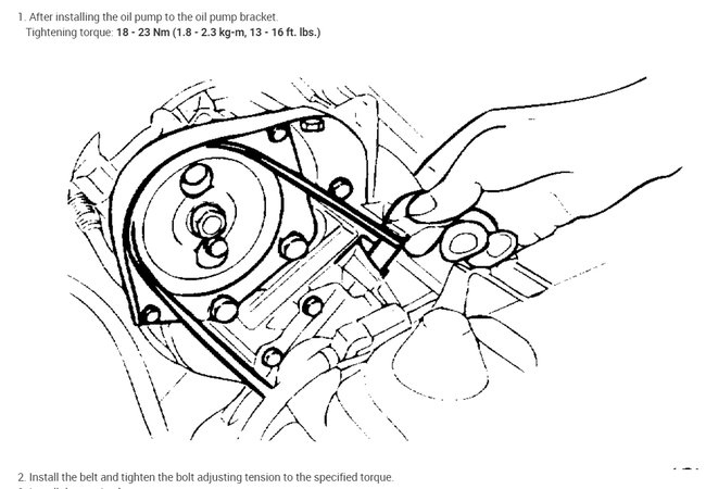

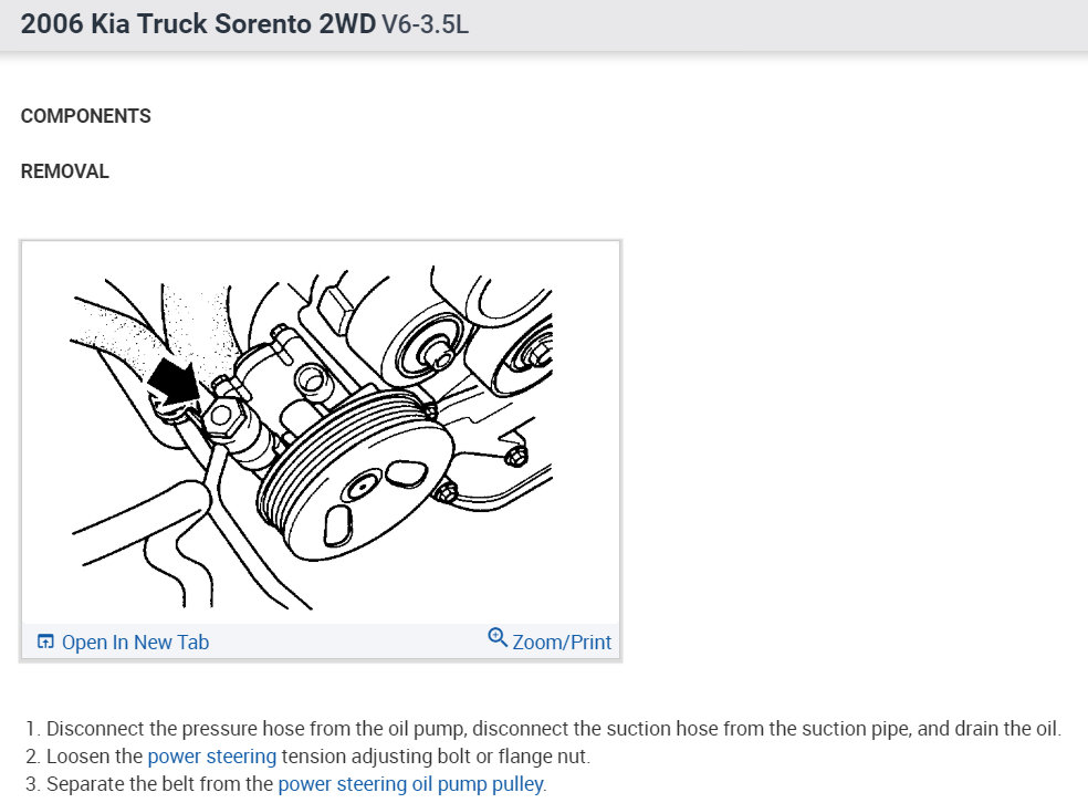

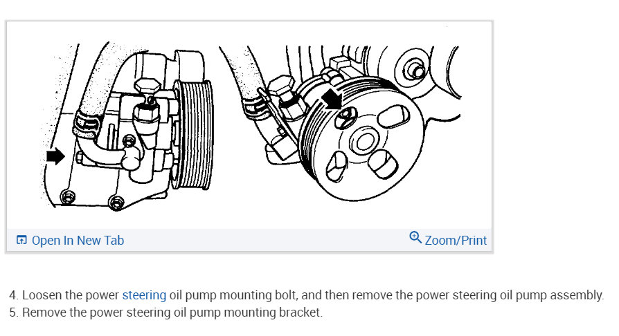

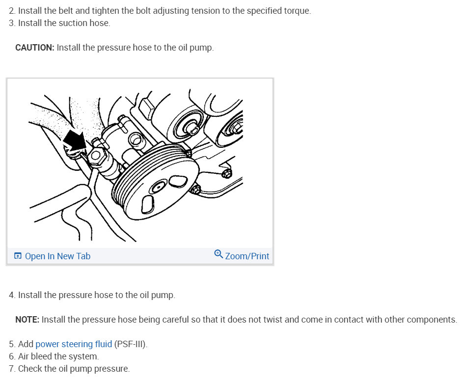

The stiffness is problem due to a failing power steering pump which is low on pressure. Here are instructions on how to change the pump in the diagrams below. Check out the diagrams (below). Please let us know what happens.
May 4, 2020 at 5:36 AM

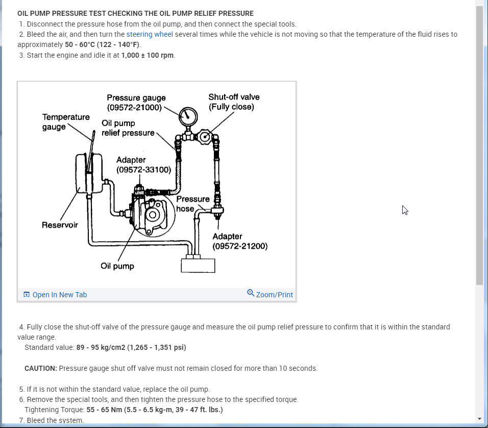

More than likely we have a power steering pump issue. The only way to know is to monitor the pressure to see if it is low.
I included the testing process for this. Also, here is a guide that runs through the basics of power steering issues as there are other possible causes. However, with low assist and no noise, it is most likely just a weak pump.
https://www.2carpros.com/articles/power-steering-problems
Let me know if you have questions after running through this. Thanks
