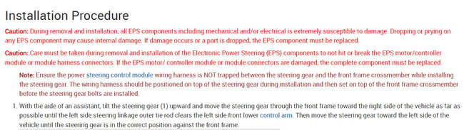

Usually when this happens it is the electronic power rack, but it could be the steering angle sensor as well. We should run a CAN scan on it to see what's going on. You can get a CAN scanner (Controller Area Network) which will work on most cars from Amazon.
https://youtu.be/u-4syLc-ifQ

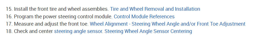

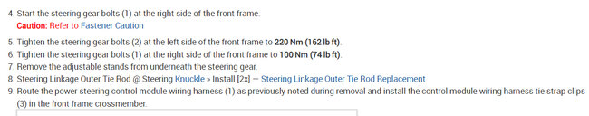

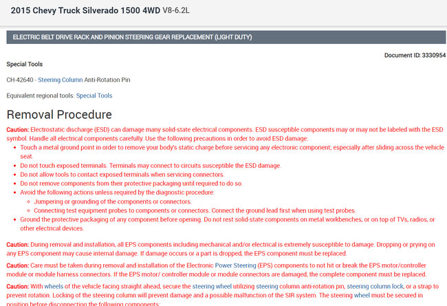

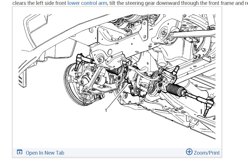

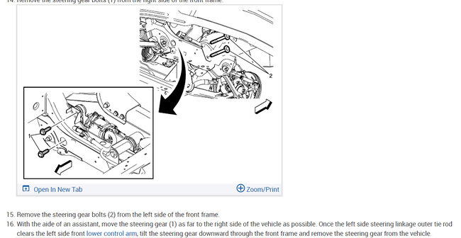

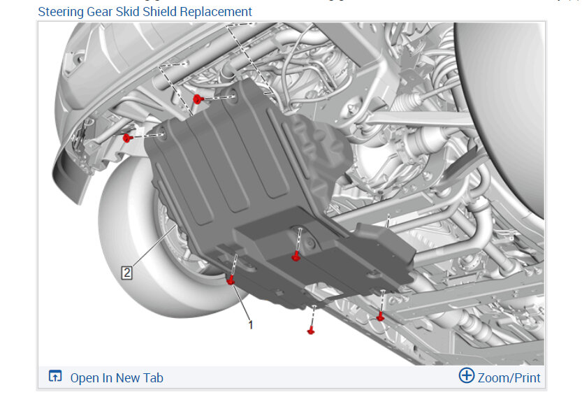

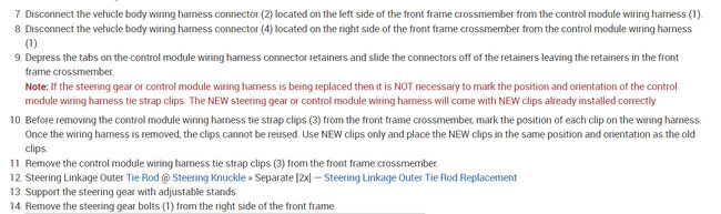

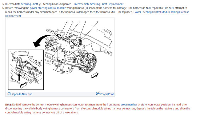

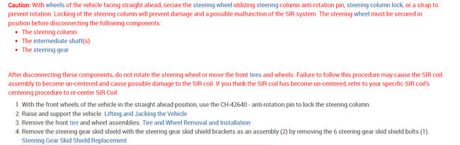

If a code comes up for the rack like I think it will here is how to change the steering rack out. Check out the images (below). Please let us know what happens.

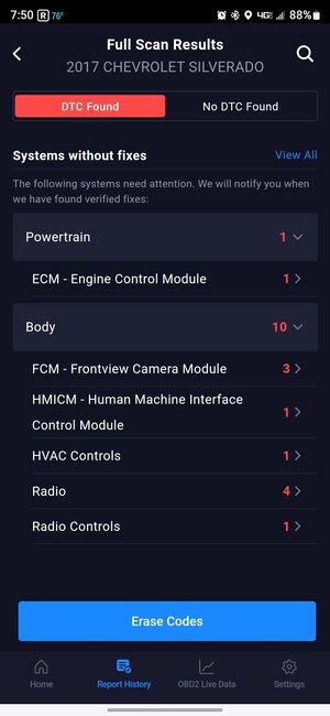

Would a normal obd 2 scanner work? Also there is check engine light or warning.
Jul 31, 2024 at 11:30 AM
HORIZON7991
Here is the scan.
Jul 31, 2024 at 10:53 PM
  • 55,732 POSTS
It looks like no codes pertain to the steering system, so it looks like the electronic power rack needs to be replaced. To be sure you can take it to the dealer and have it diagnosed.
