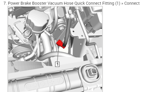

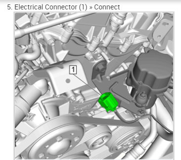

If there is no vacuum, either the hose has come disconnected from the vacuum pump, the electrical connector at the vacuum sensor is disconnected, or the hose is broken.
I attached a pic below showing the hose. Check to see if it is connected and confirm there are no cracks or damage to it.

No picture attached but I will check the hose and connection. checked vacuum hose and grommets. No leaks and Elec, connection seems good. Got a friend coming today and we plan to bleed the master cylinder and brake lines, to assure no air in lines.

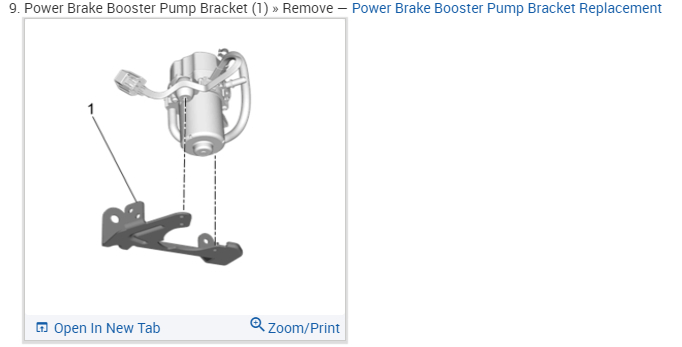

"SERVICE BRAKE ASSIST" is the message that I get.. How to check the vacuum? Does the 2018 Colorado have a mechanical vacuum pump? If so. where is it located?
Jun 14, 2023 at 3:56 AM

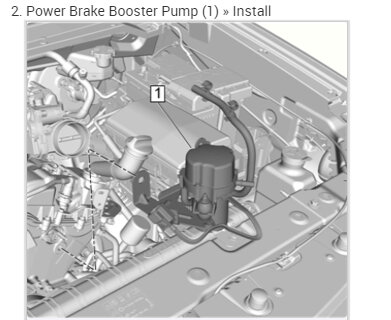

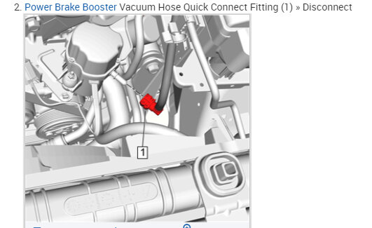

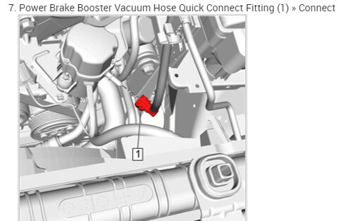

  • 110,244 POSTS
It does have a brake booster pump. It's located at the front of the engine. Take a look at the pic I attached below and let me know if you can locate it.
Note, there is a quick connection on the vacuum supply hose to the booster. Make sure it is connected and not damaged.
See pic below.

After much frustration, have changed vacuum control valve, master cylinder and booster. Down to replacing vacuum pump. Removed the 3 10mm bolts and wouldn't budge. Removed all valve cover bolts and got the cover loose but the pump will not come off the cam. Please advise on how to remove vacuum pump, please.
Jul 21, 2023 at 9:14 PM

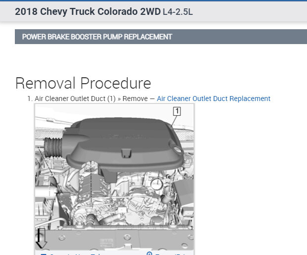

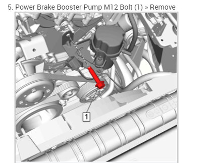

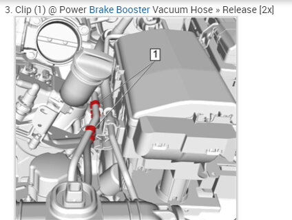

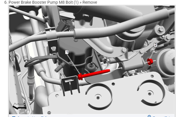

  • 110,244 POSTS

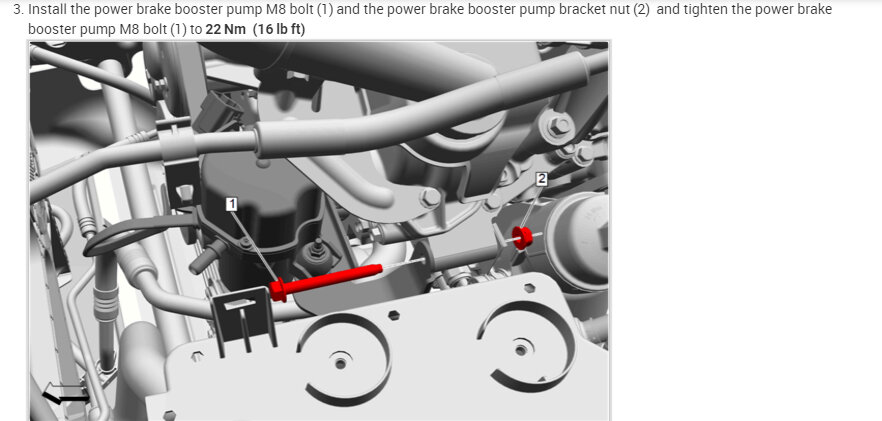

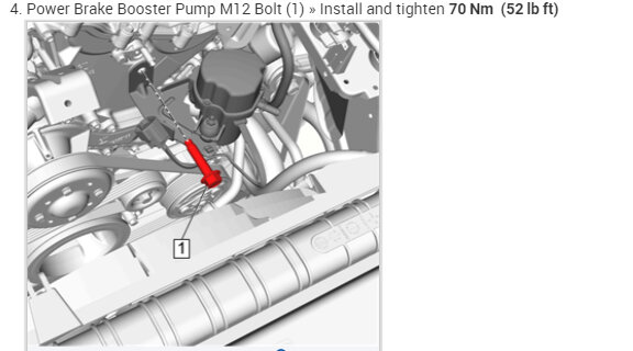

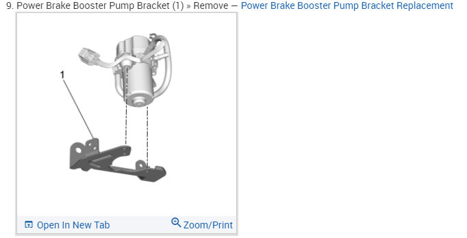

It sounds like you've been busy. I'm not sure why the valve cover was removed. The pump is removable without doing that.
Regardless, I attached the directions below for the removal and installation of the power brake booster pump.
Let me know if this helps.
Jul 22, 2023 at 2:29 PM
BIGMAX
  • 18 POSTS
The vacuum pump was Seized at the valve cover opening. That is why I removed the valve cover. Once removed, one side of the slotted connector on the vacuum pump was broken off. Looked and looked for that piece with no result, Awaiting new vacuum pump.
seal to install the new OEM pump. Thanks for the pics however, the vacuum pump on 2018 Colorado is on the back of the valve cove next to the firewall with about 3 inches of working room. That is the reason for removing the valve cover. lol. Will follow up once new pump is installed. Again, thanks for your help!
Jul 23, 2023 at 7:10 PM
  • 110,244 POSTS
Thanks for the update. It sounds like you have the same kind of luck as I do. LOL Also, I double checked my manual and apparently, it's wrong. The pics I attached above are what it provides.
Regardless, I hope things start getting easier. Take care and I look forward to hearing the results.

Well, parts finally arrived, got the new OEM vacuum pump installed. Test drive proved positive, and the brakes are now working properly. It was a real pain but I'm glad it all worked out! Can't remember when I've had so much fun, Thanks again for the assistance. After replacing the vacuum check valve, booster, master cylinder and vacuum pump it had better have worked. At least I have completely new brake system, lol.
