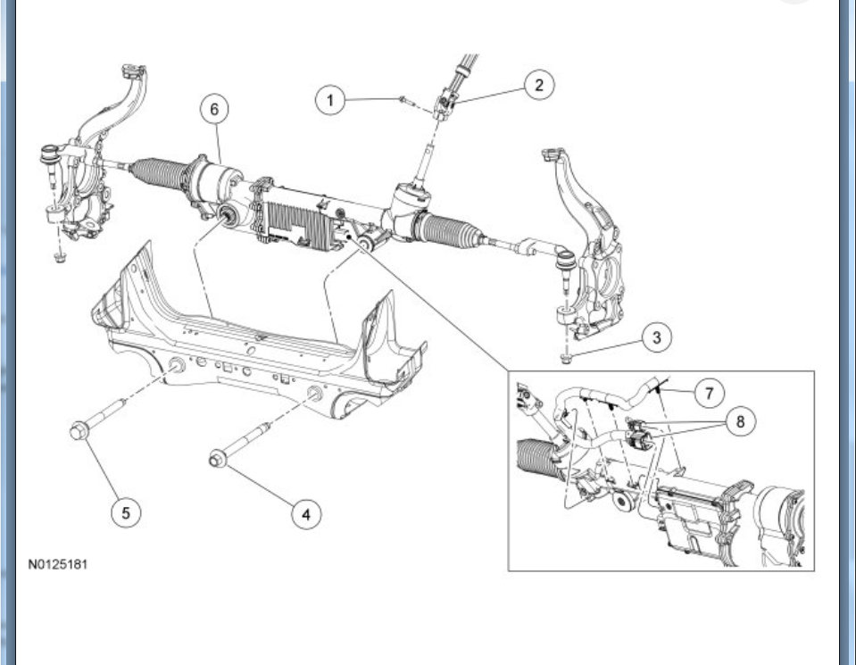

Well, this truck has electronic steering.
Oct 13, 2020 at 5:47 AM

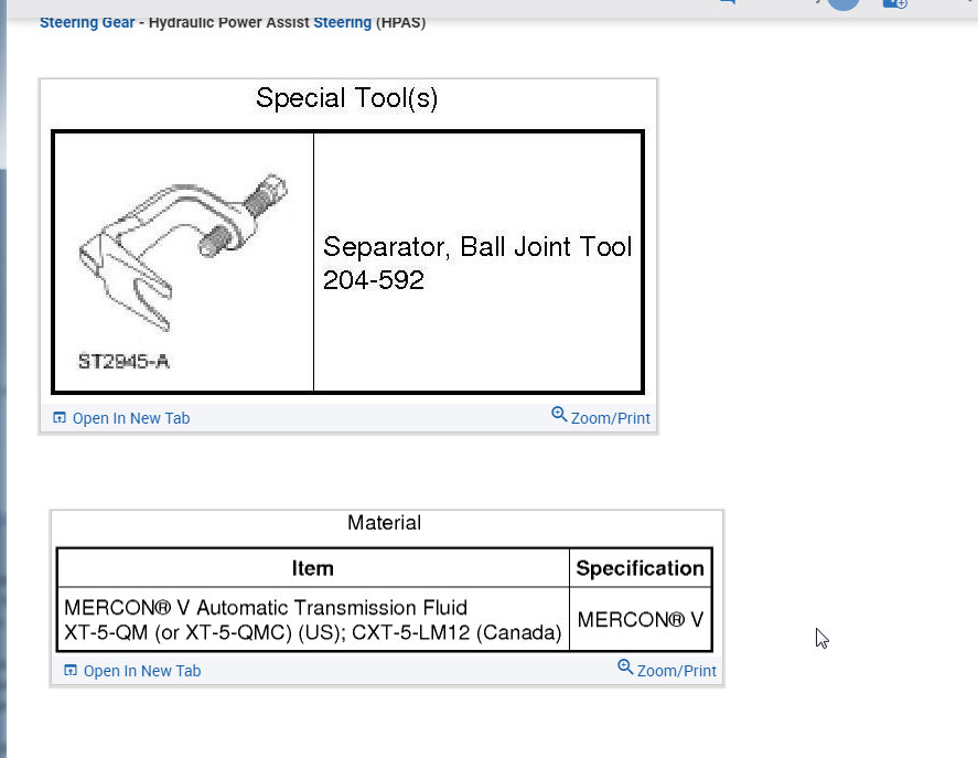

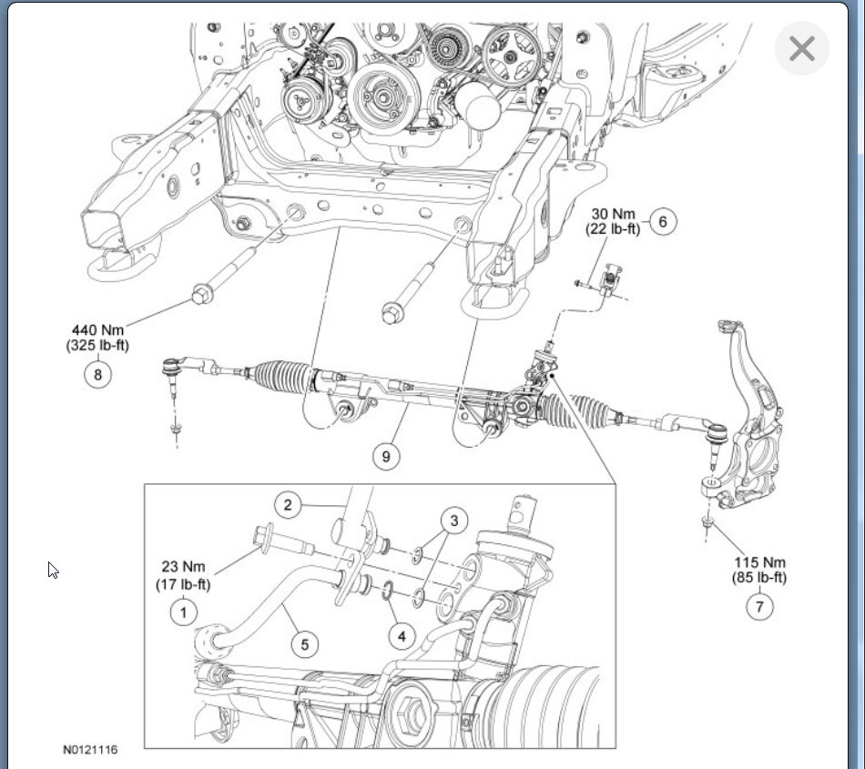

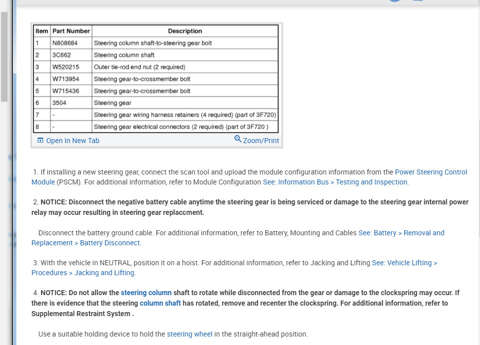

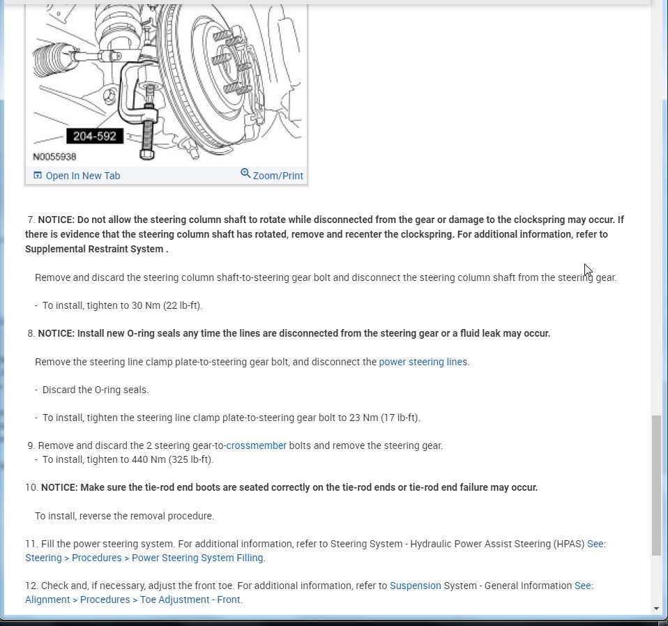

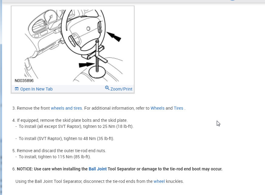

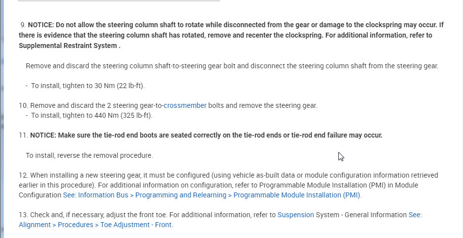

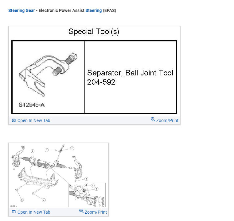

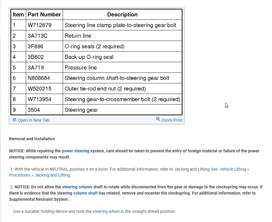

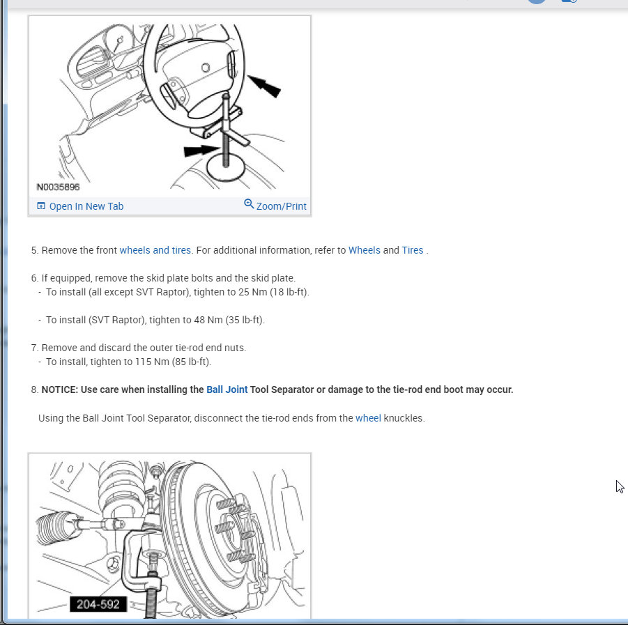

Okay. That is good information. Here is the process for the electronic gear. It does not change much as I suspect something is binding internally to the gear. Clearly the binding and then the pop points towards this.

The procedure looks fairly simple, but good god are these racks expensive, and I don't know how to reprogram it.
Oct 13, 2020 at 11:42 AM
You need a scan tool capable of performing the configuration. Yeah. They are not cheap which is why we need to confirm there are no other components binding. I would recommend trying to duplicate this on jack stands so that you can get better access. At the very least does it do it sitting still?
