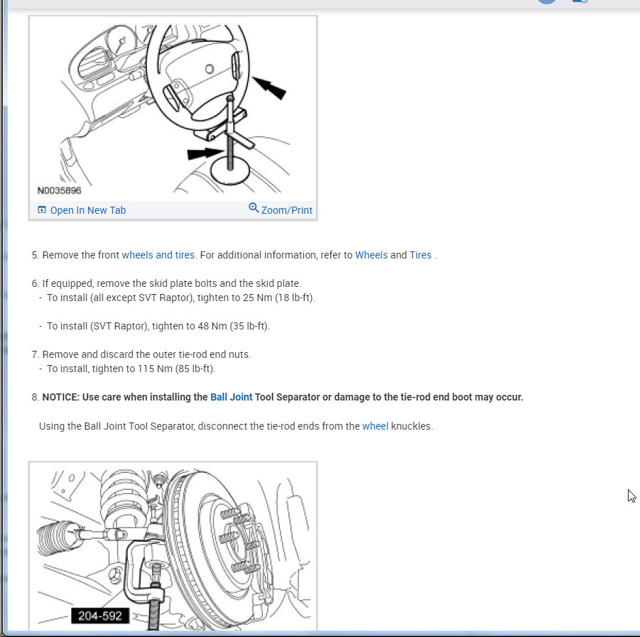

Typically left turns. Will have to lightly "pop" the wheel out of the stuck position. No audible sounds or anything. I replaced the intermediate shaft , and it made the steering a little tighter, and made the issue feel worse. I guess because of it being tighter. Is there a way to grease these?

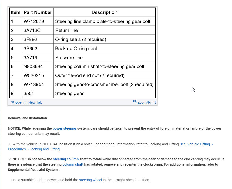

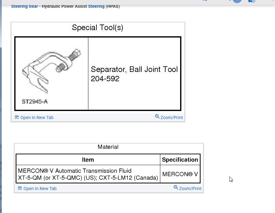

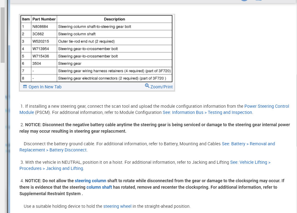

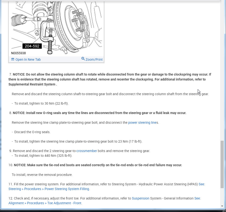

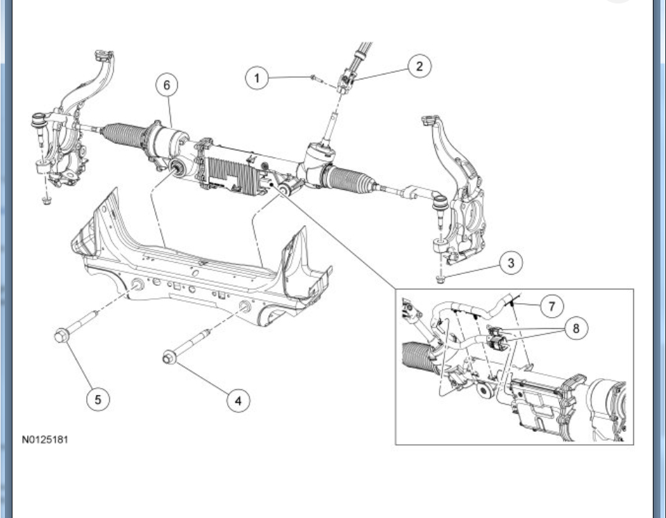

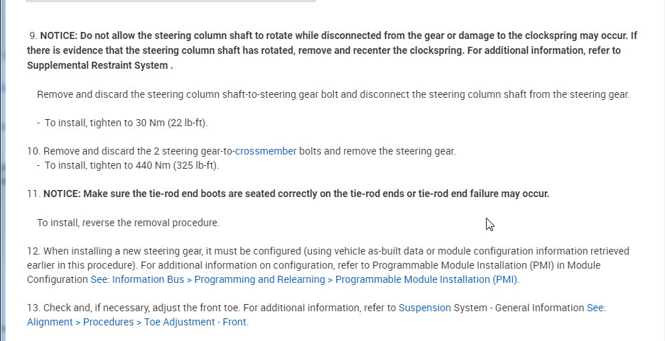

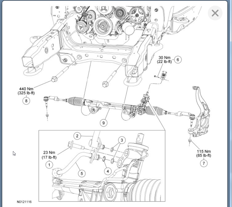

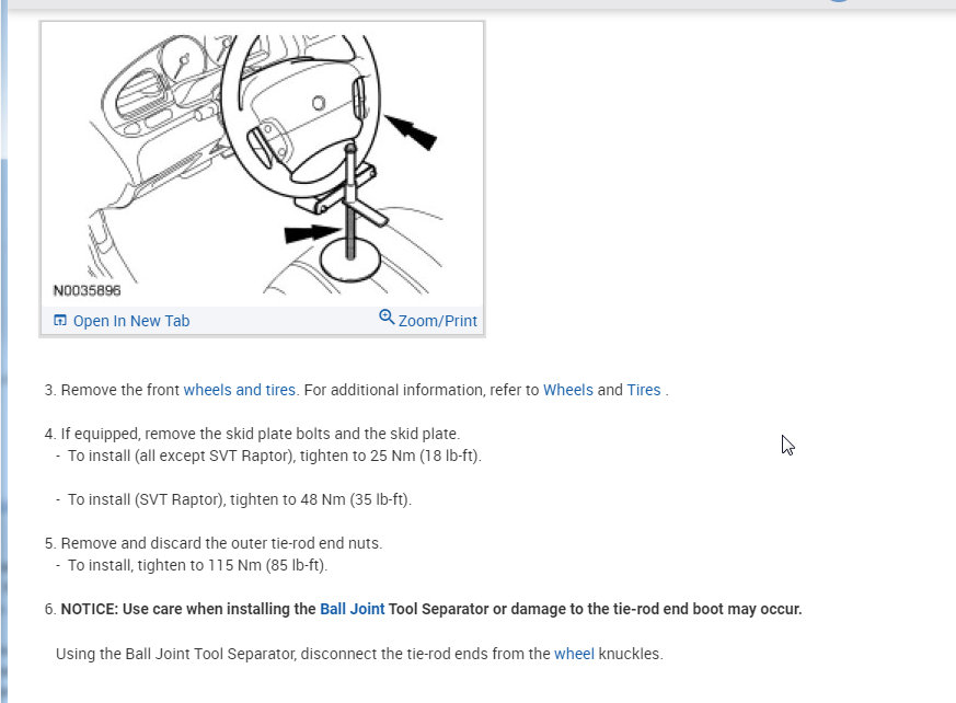

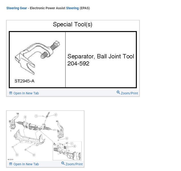

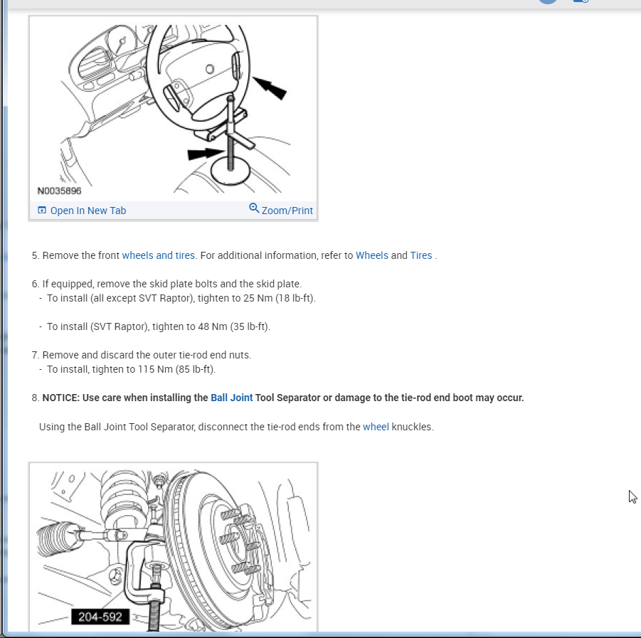

Okay. That is good information. Here is the process for the electronic gear. It does not change much as I suspect something is binding internally to the gear. Clearly the binding and then the pop points towards this.
Oct 13, 2020 at 11:38 AM
CANNON1349
  • 861 POSTS
The procedure looks fairly simple, but good god are these racks expensive, and I don't know how to reprogram it.
Oct 13, 2020 at 11:42 AM
You need a scan tool capable of performing the configuration. Yeah. They are not cheap which is why we need to confirm there are no other components binding. I would recommend trying to duplicate this on jack stands so that you can get better access. At the very least does it do it sitting still?
