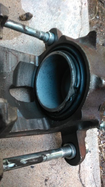

I've replaced calipers, brake shoes, speed sensors, brake hoses, brake booster, master cylinder, rear metal brake line, both front bearings. My front brakes will stick and get hot and cause truck to shake at high speeds. Still have problem. No lights no codes.

They drag , I let it sit and it frees up.

I noticed when I worked on the truck to do the speed sensors the drivers caliper was harder to push in to make it fit with the brake shoes than the passenger side.

That caliper was already on the truck for awhile and when I serviced the speed sensors I had push the caliper piston In to allow the caliper and shoes to fit over the hub.

If you open the bleeder valve, does the piston push back nice and easy?

I didn't do it that way. I'm going to have to remove it and try it . Would that tell me that if the fluid comes out the bleeder then the hose could be bad.

I just pushed the caliper in and opened the bleeder and fluid came out but still took some force.
Jul 20, 2019 at 6:01 AM
Okay, then the caliper is no good.

Headed to town to pick one up. They have the one that has the metal piston instead of the phanalic coated one.
