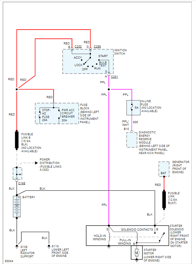

My vehicle listed above EXT won't turn on or start it's like the battery is dead but my head lights work no dash lights no gages come up but it does not crank or start and the battery I tested it and it's at 13Vollts and I replaced the ignition switch and alternator and starter solenoid and checked all fuses and replaced all relays still nothing. could you please give me some advice on this?

We need to see if the starter is getting a signal to the solenoid from the ignition switch.
This guide will help you will need a test light:
Also, see if you are getting power to the red wires at the ignition switch, if not the fusible link is out. Here is the starter wiring diagrams so you can see how the system works. Check out the images (below). Let us know how it goes.

I have done all of that everything checks out good, but van still has nothing. I'm at a loss here I don't know what to do.

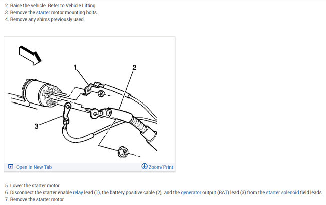

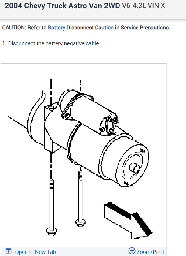

So, the trigger wire gets a signal when the crank command is given, correct? If so, I would replace the starter. Does the engine turn over by hand? This video can help:
https://www.youtube.com/watch?v=oN42gZN6gOE&t=37s
Here is how to change out the starter motor. Check out the images (below). Please let us know what happens.
