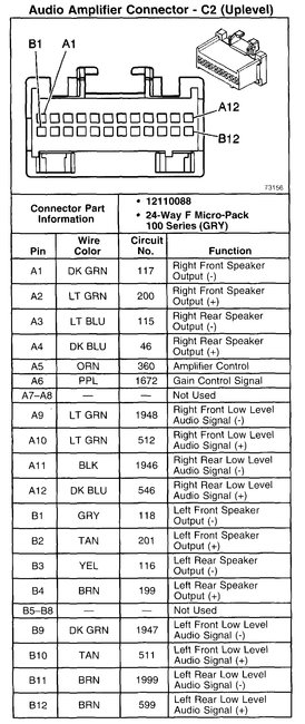

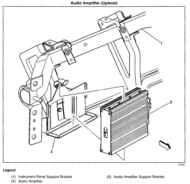

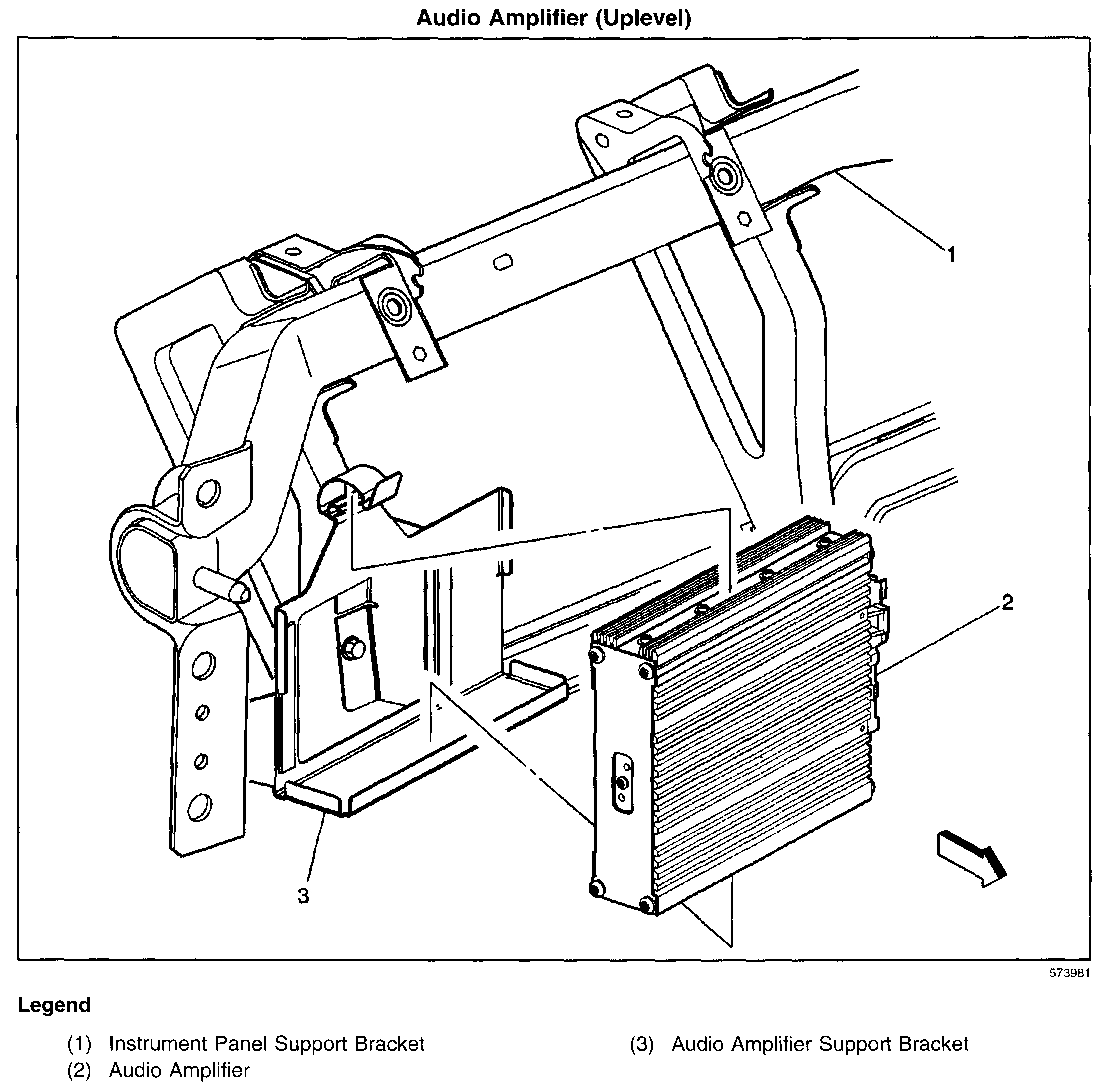

Did you check all connections at the amp? It is located to the right of the I/P behind the compartment box. See picture 1.

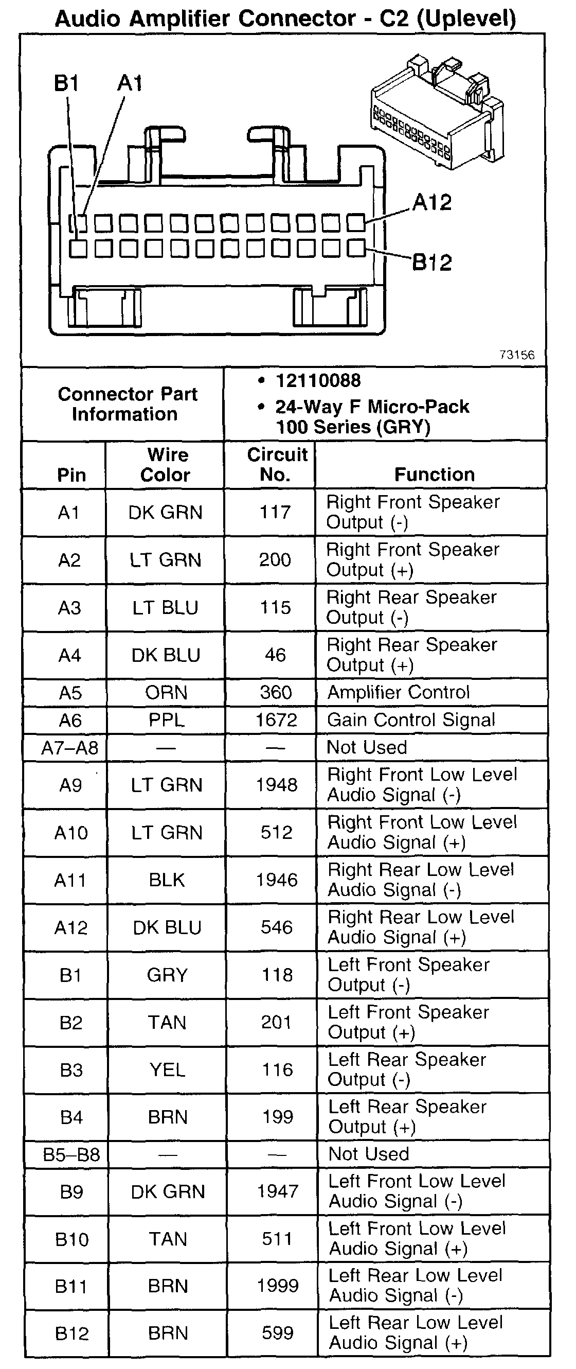

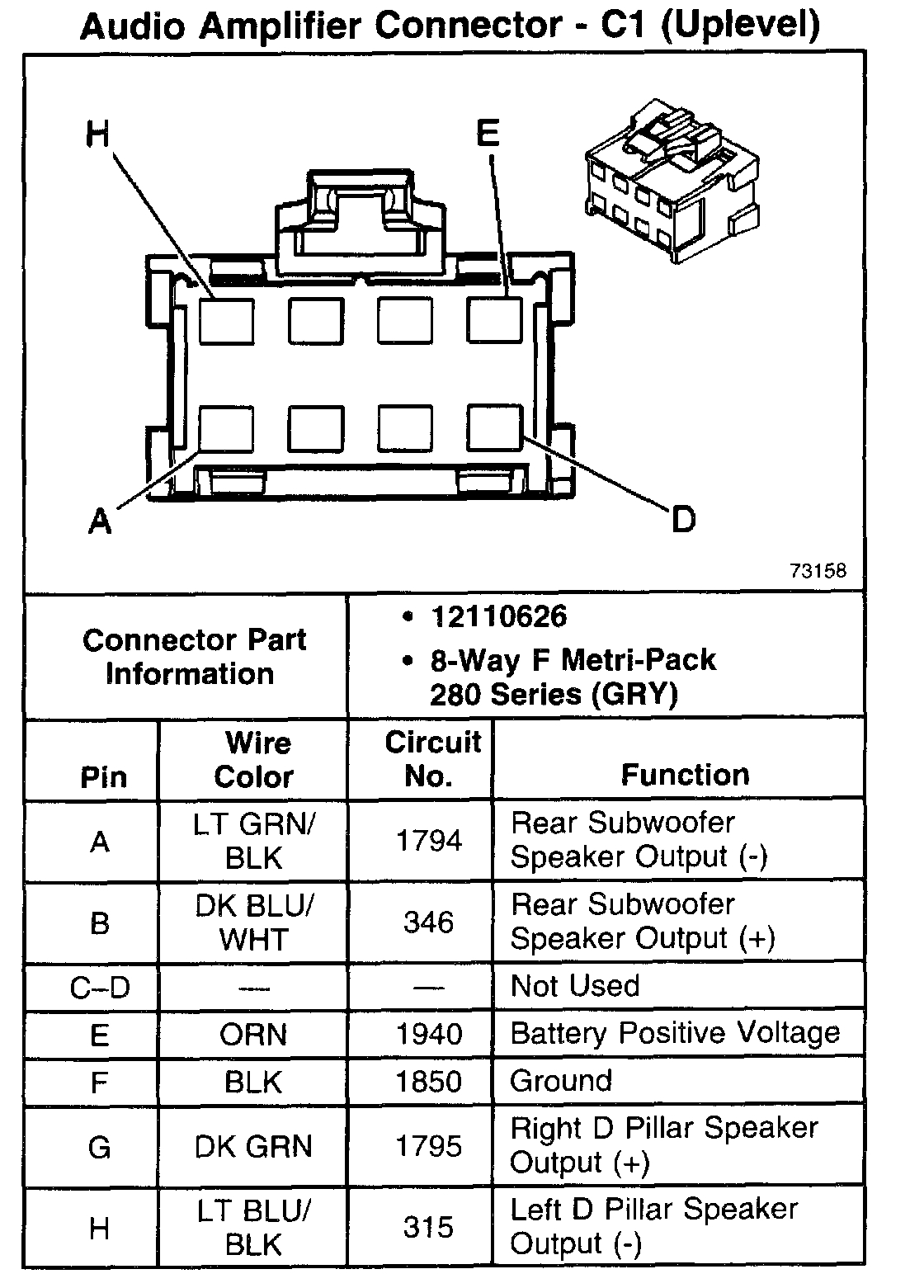

Check to make sure nothing is loose and the plugs are tightly connected. Also, two additional pictures which are of the plugs and what each pin is for.
Let me know if this helps.

I agree with you, but I feel it is more like a loose wire. I would recheck all connectors. Also, disconnect them, inspect the pins to make sure nothing is corroded or pushed in and not making proper connection, and I suggest using dielectric grease on all of them.
Let me know if that helps.
