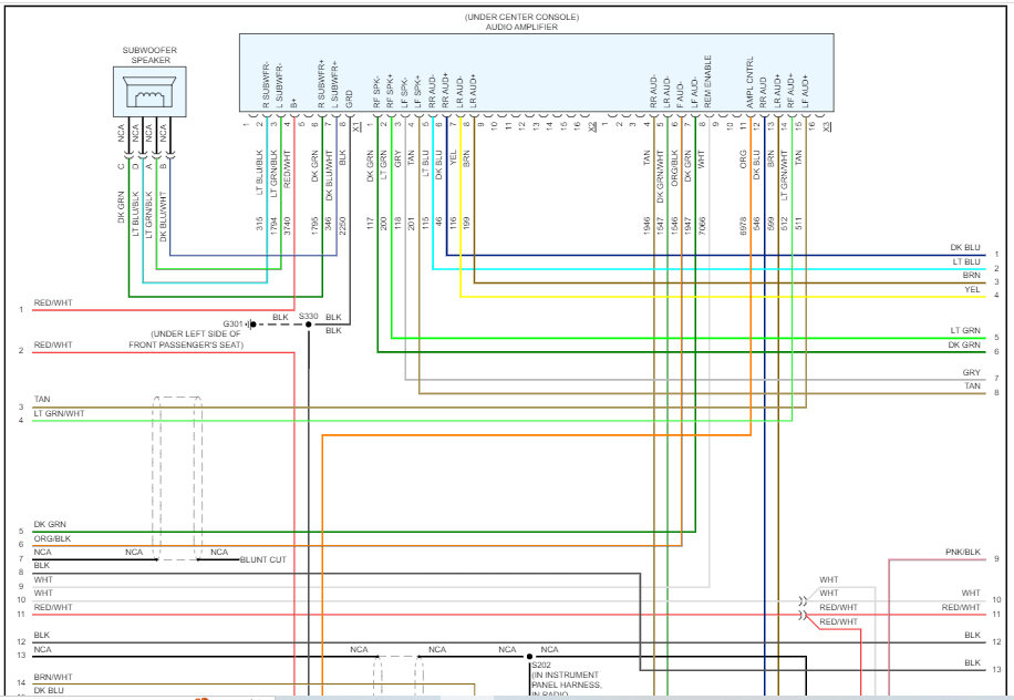

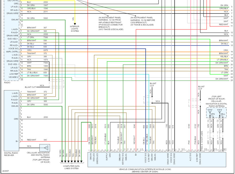

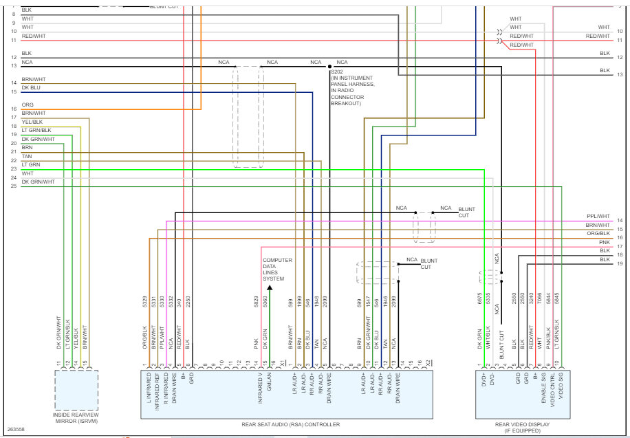

I need the stereo wiring diagram for my vehicle listed above. I have searched endlessly for the one I need. My rpo codes are UE1, UK3, UK6, UQA, US9,U2K. Thank you for any help.
Mar 10, 2023 at 4:11 AM
  • 110,248 POSTS

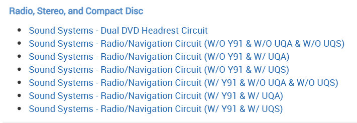

I am trying to find a system with all the RPO codes you indicated and I'm having no luck. Do me a favor. Take a look at the pic below and see if you can identify the correct one.
See pic below.
Mar 10, 2023 at 2:21 PM
KINSEYJAMES
  • 25 POSTS

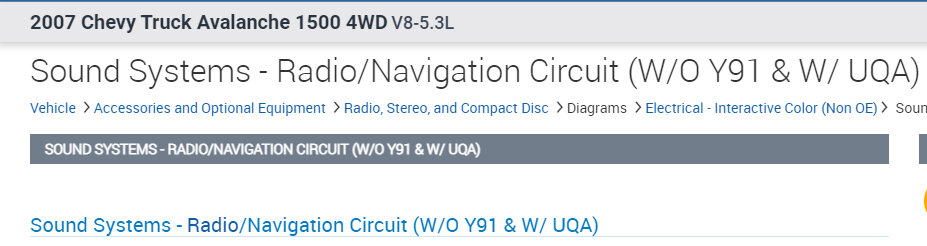

It would be the one W/O Y91 and W/ UQA .
I got the premium Bose with amplifier no navigation and no DVD.
Mar 10, 2023 at 3:33 PM
  • 110,248 POSTS
I'm glad you figured it out. I was getting a headache. LOL

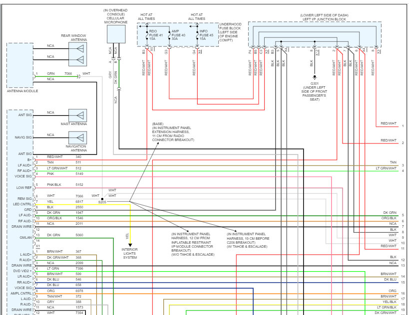

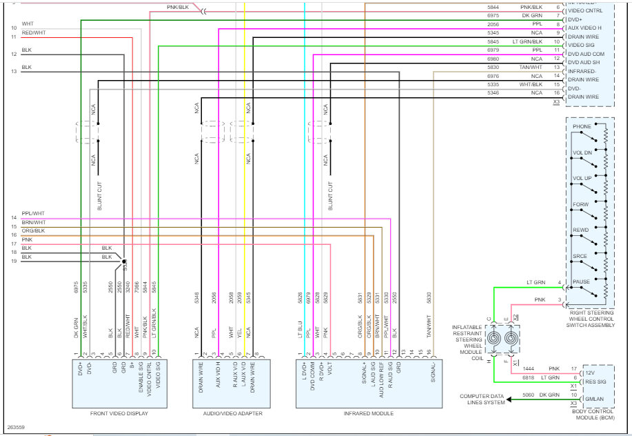

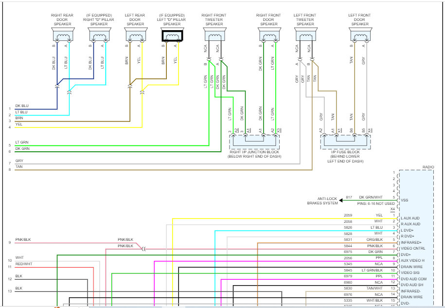

Just so you know, the schematics were three pages long for this option. Ugh! I had to cut each page in half to make them readable for you. I did overlap them so you can follow (in pairs) from one to the next.
Let me know if this helps or if you have other questions,
