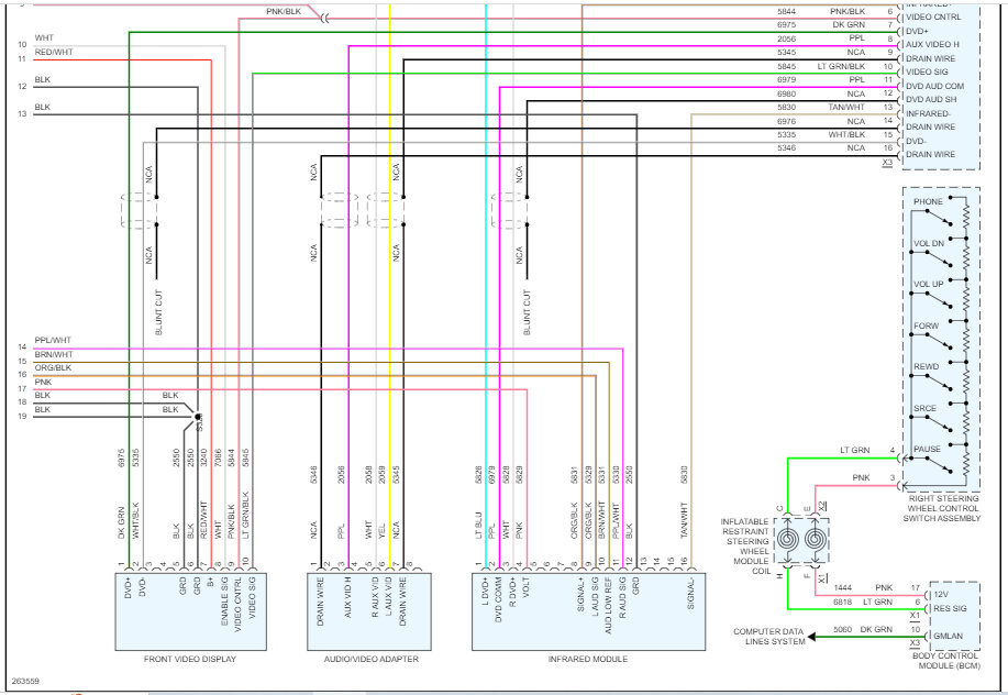

I need the stereo wiring diagram for my vehicle listed above. I have searched endlessly for the one I need. My rpo codes are UE1, UK3, UK6, UQA, US9,U2K. Thank you for any help.

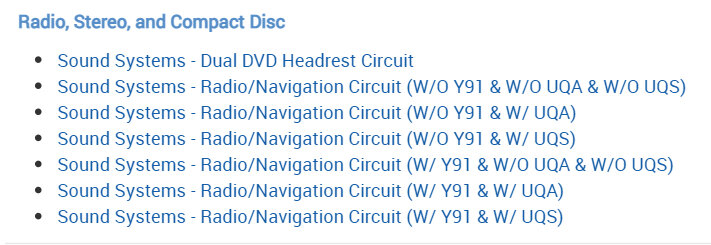

I am trying to find a system with all the RPO codes you indicated and I'm having no luck. Do me a favor. Take a look at the pic below and see if you can identify the correct one.
See pic below.

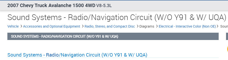

It would be the one W/O Y91 and W/ UQA .
I got the premium Bose with amplifier no navigation and no DVD.

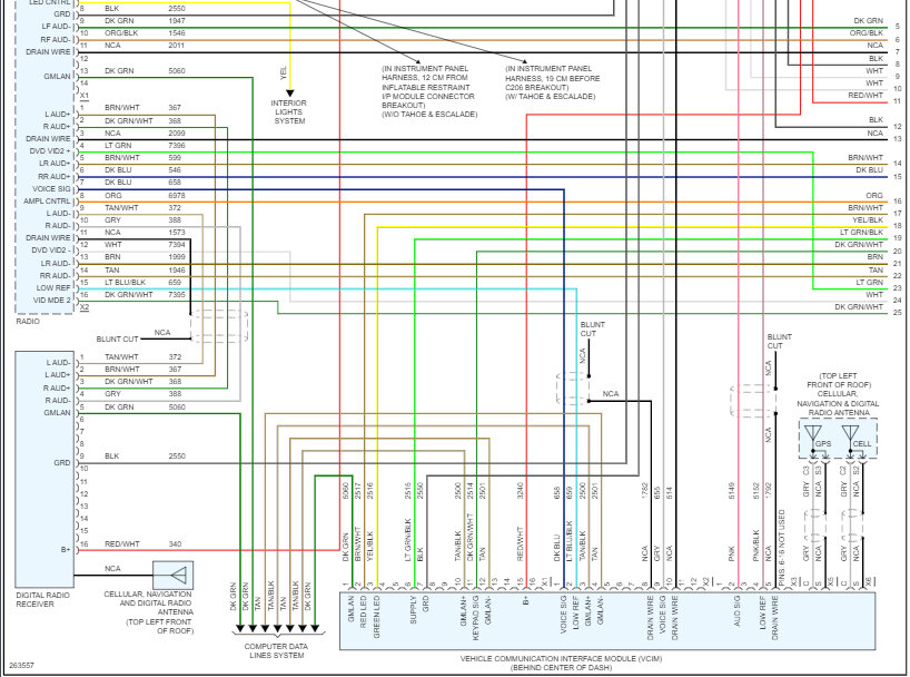

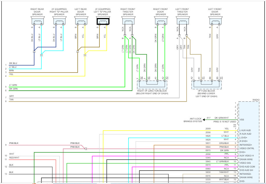

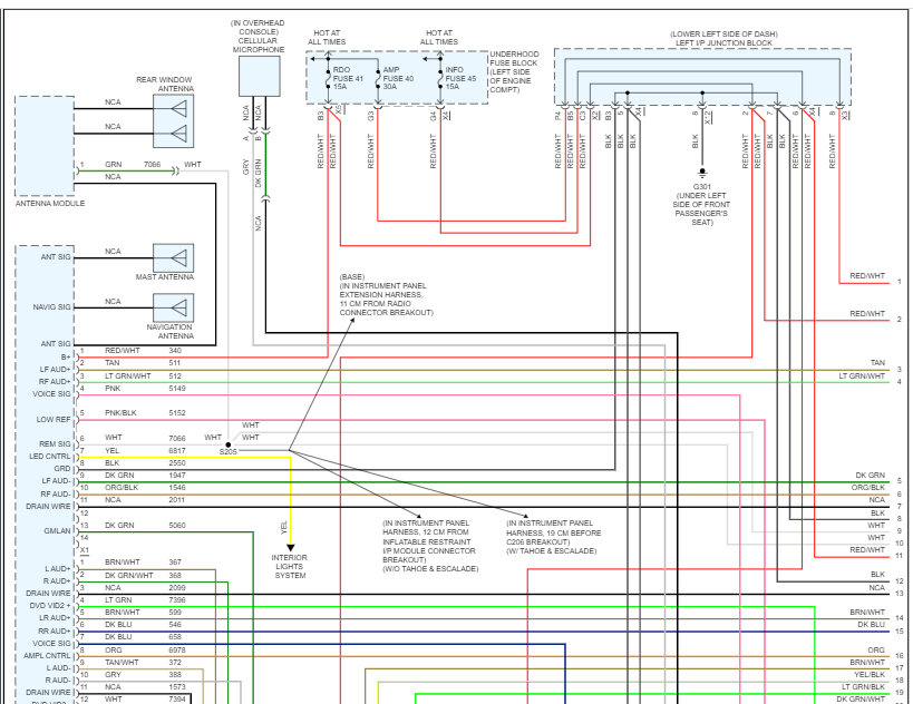

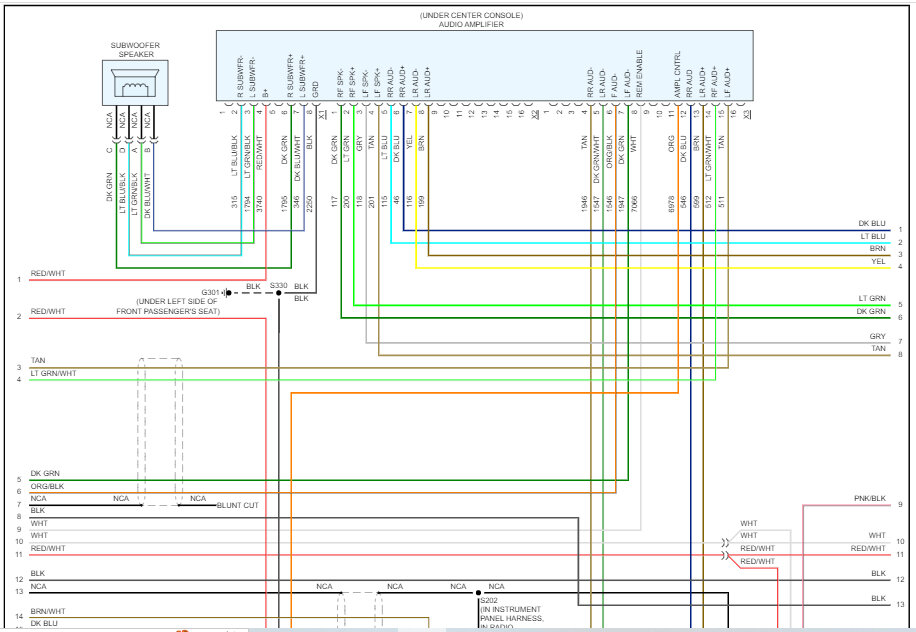

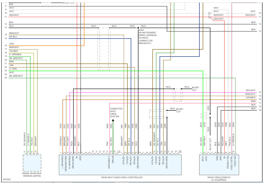

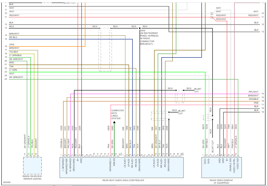

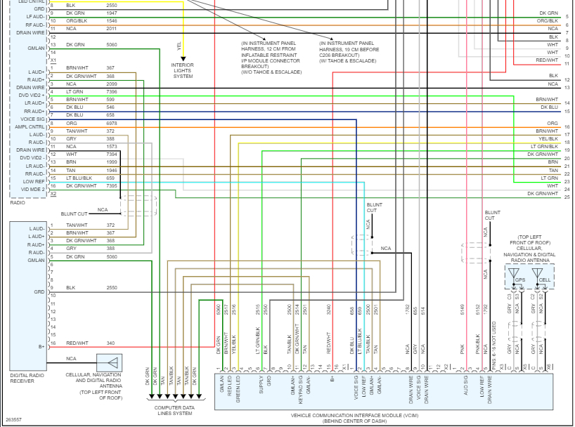

Just so you know, the schematics were three pages long for this option. Ugh! I had to cut each page in half to make them readable for you. I did overlap them so you can follow (in pairs) from one to the next.
Let me know if this helps or if you have other questions,
