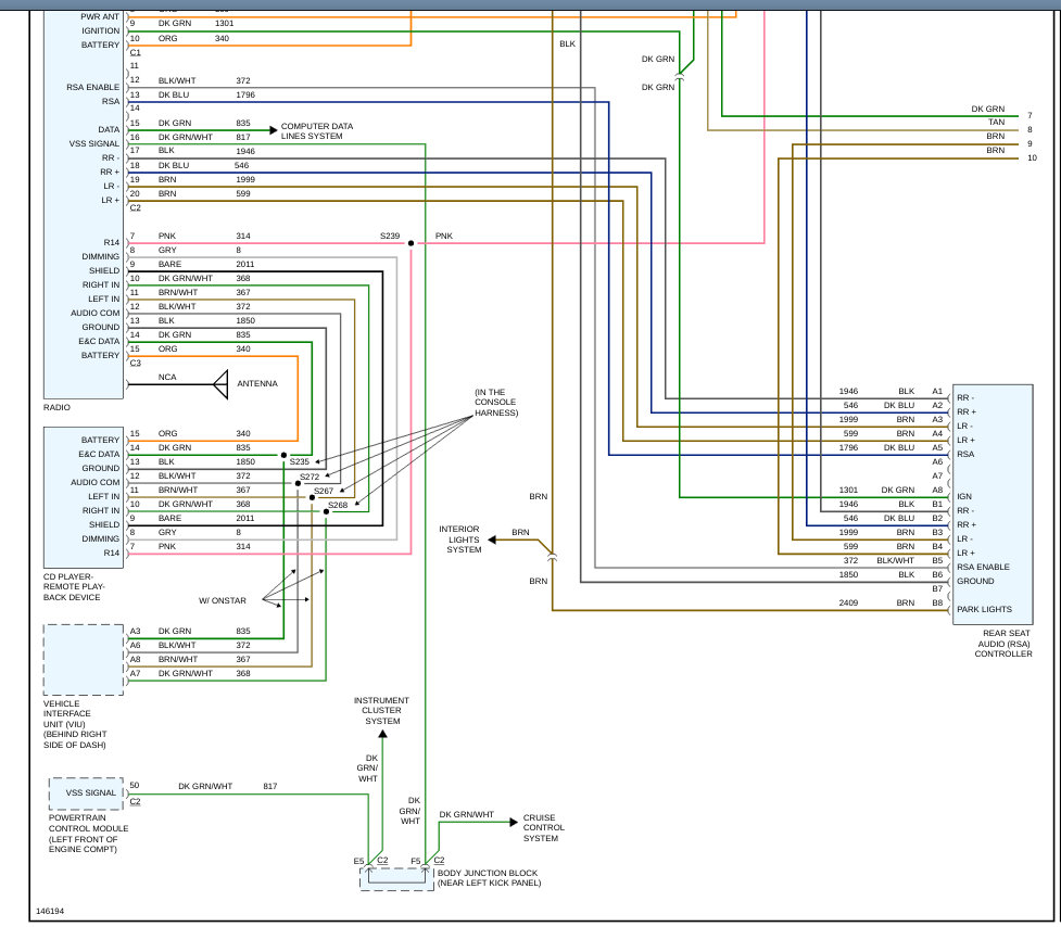

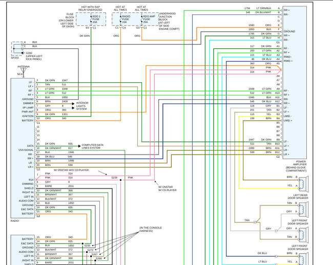

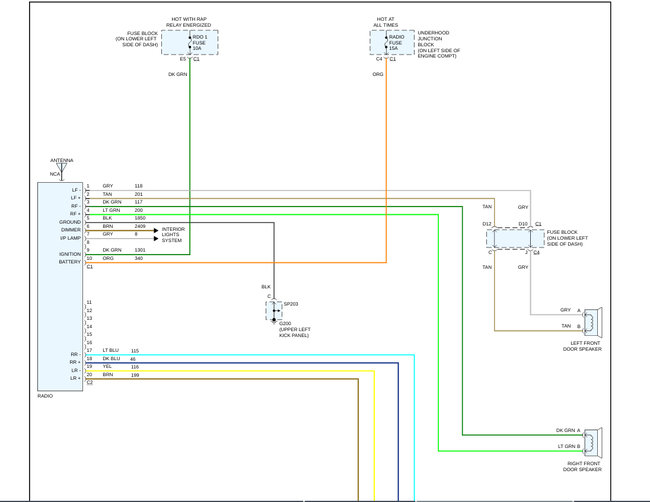

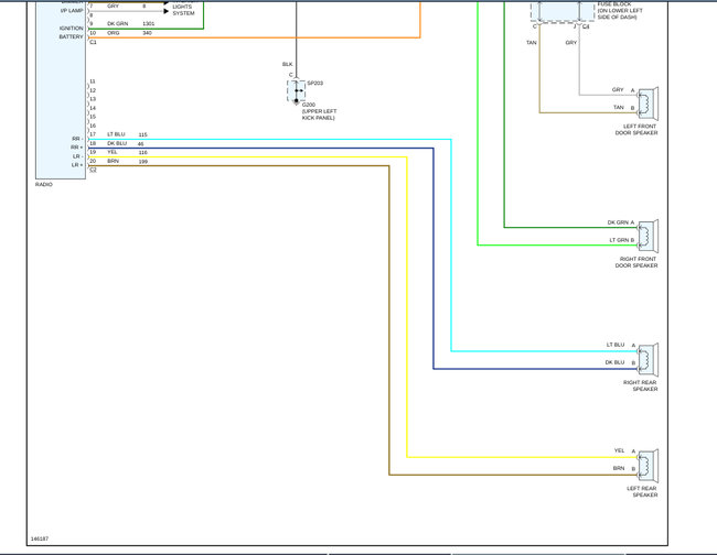

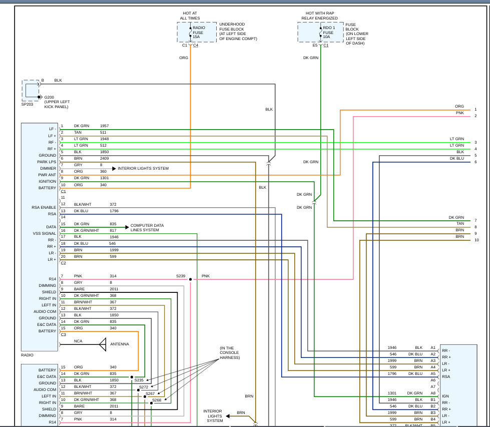

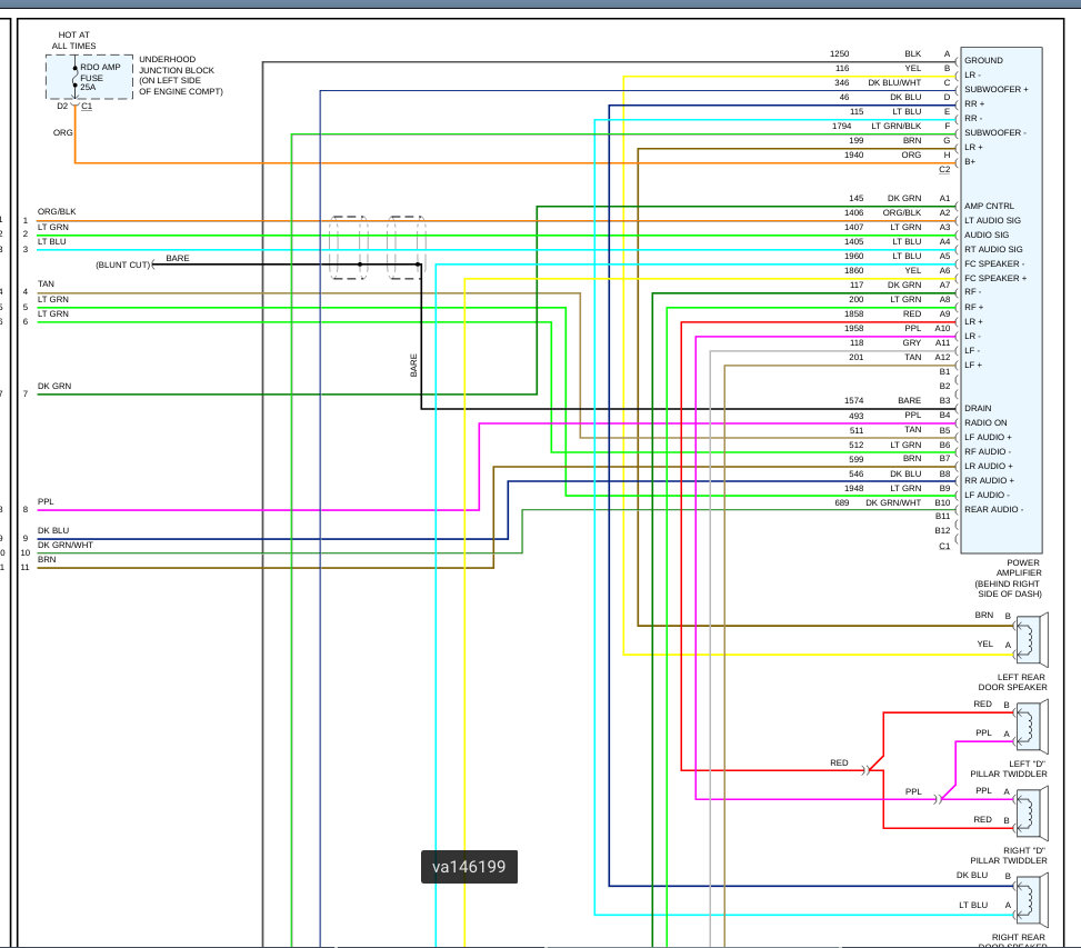

Hello guys, I just wanted to ask if anyone knows which stereo wiring diagram is the correct one for my car. I couldn't find the right one, and I notice that I have several colors that are the same; I have 6 green cables, 3 browns, two orange, one blue, one purple, one black, one that seems to be like yellow. If anyone knows I would appreciate it. thanks.

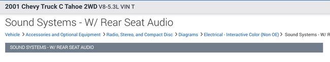

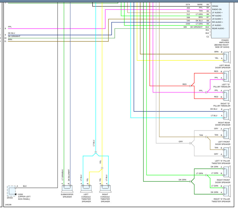

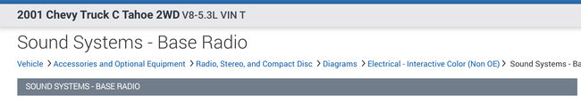

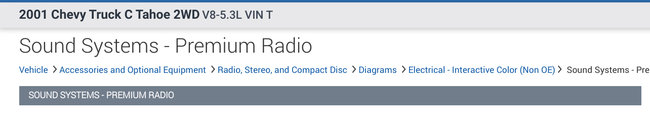

There are four stereo options for your vehicle and I have included all of the four different stereo option wiring diagrams in the diagrams down below. Please go through these wiring diagrams and get back to us with how everything turns out. I hope that these help.
Thanks,
Alex
