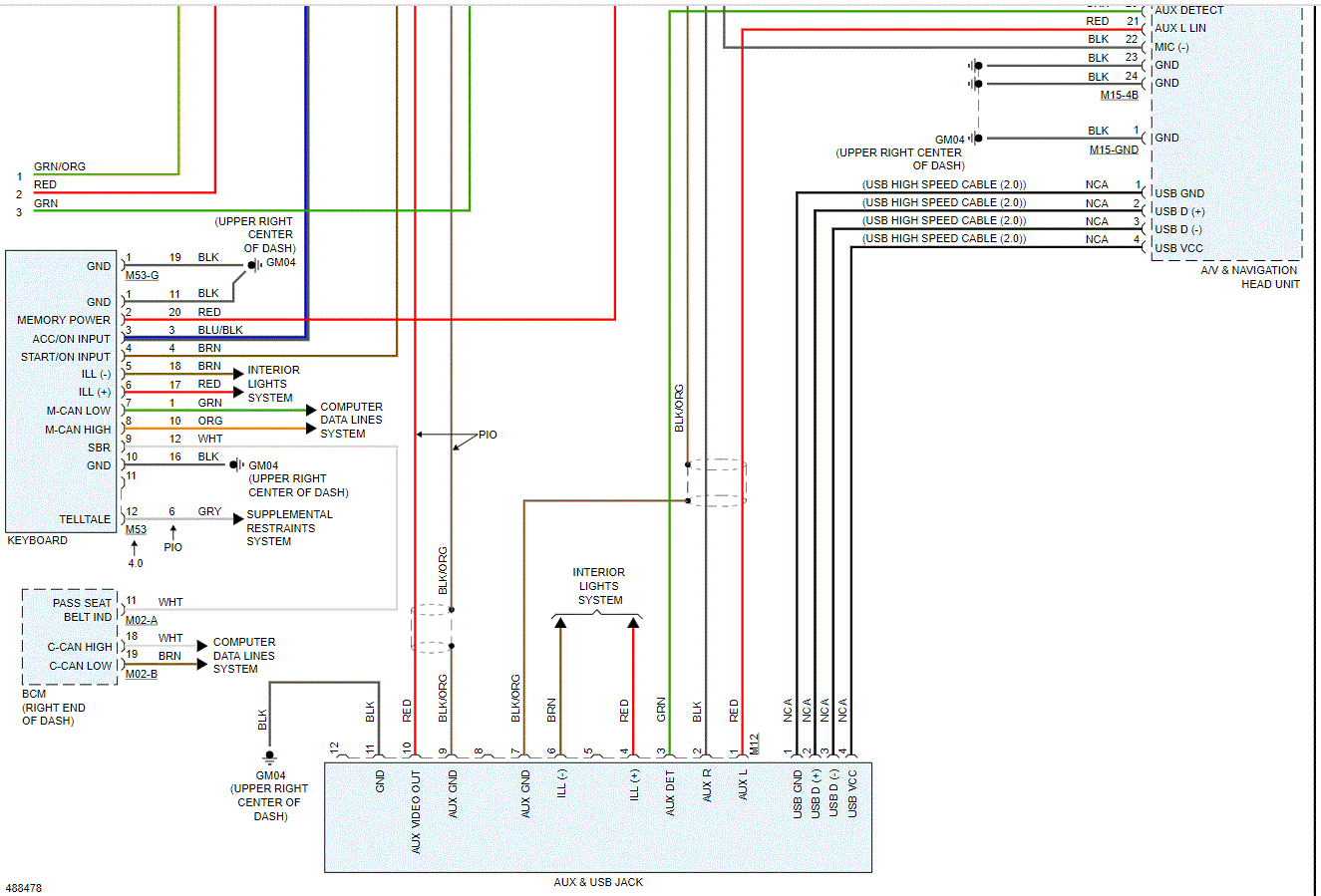

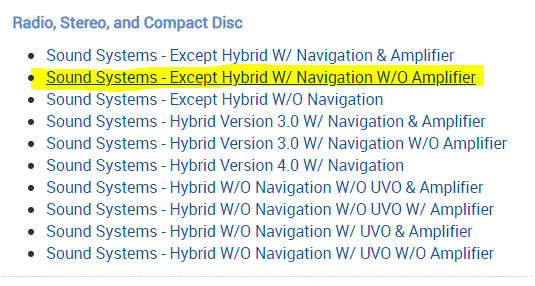

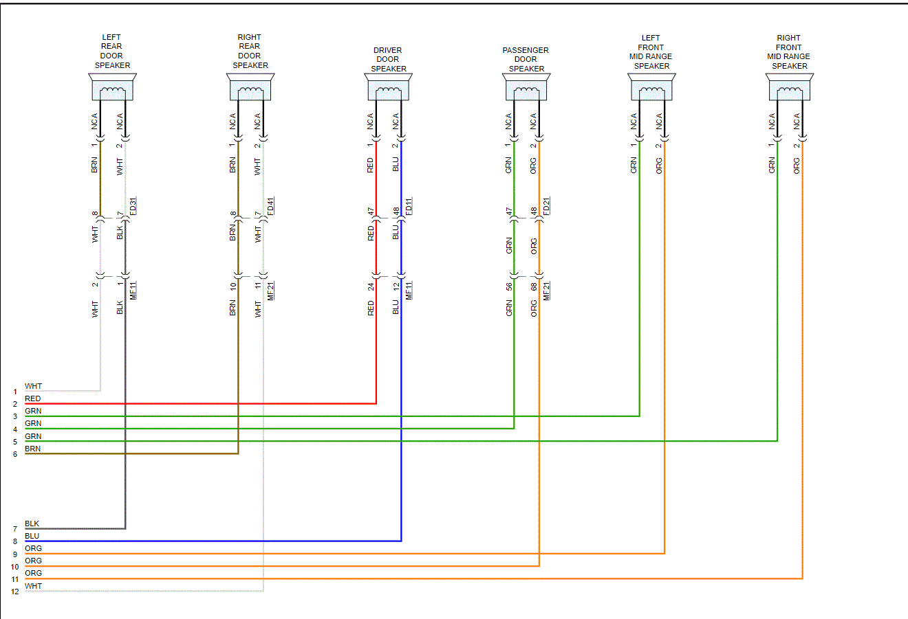

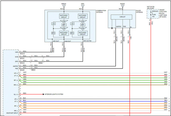

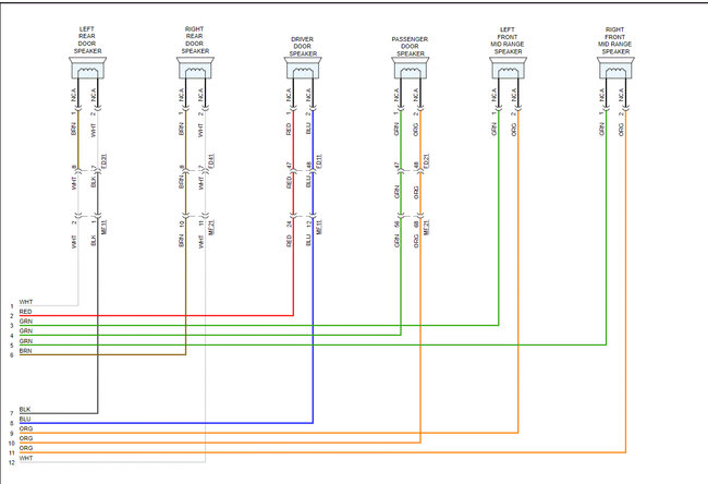

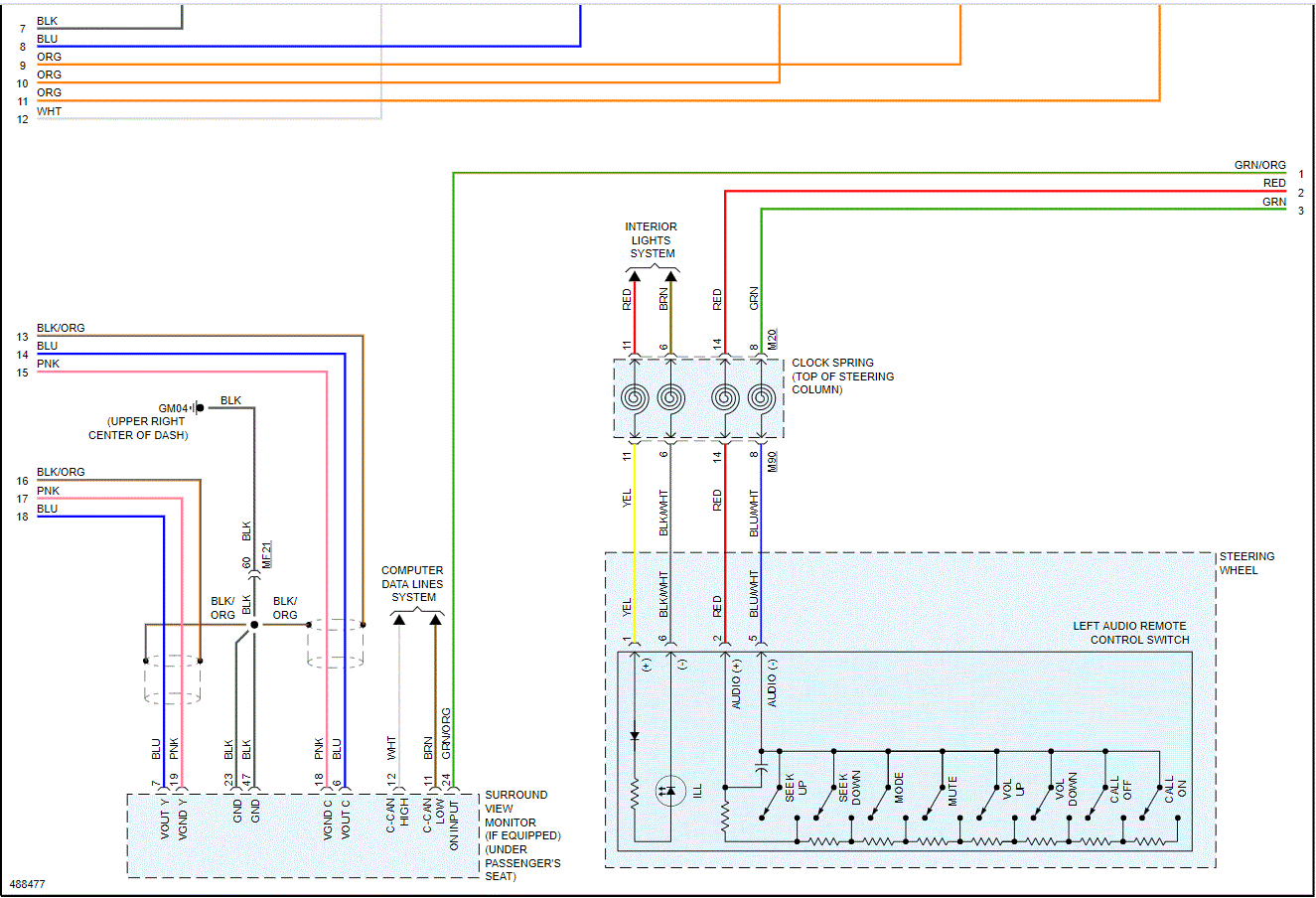

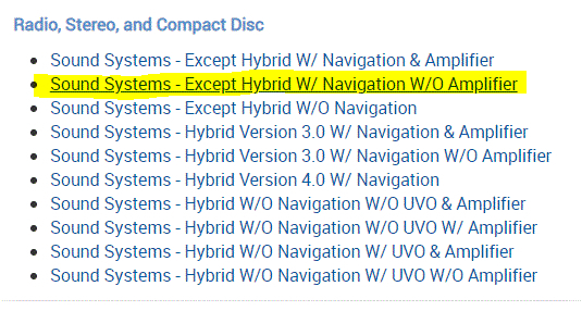

I have two options with nav. Neither indicates Harman Kardom. However, I know that is an upgrade and I believe it has a seperate amp.
If you look at pic 1 below, I listed the options I have and highlighted the one I picked. If that is incorrect, let me know.

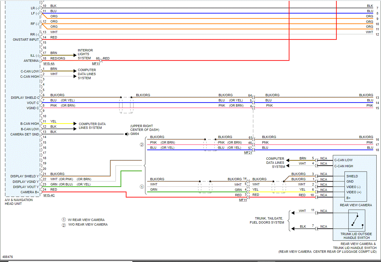

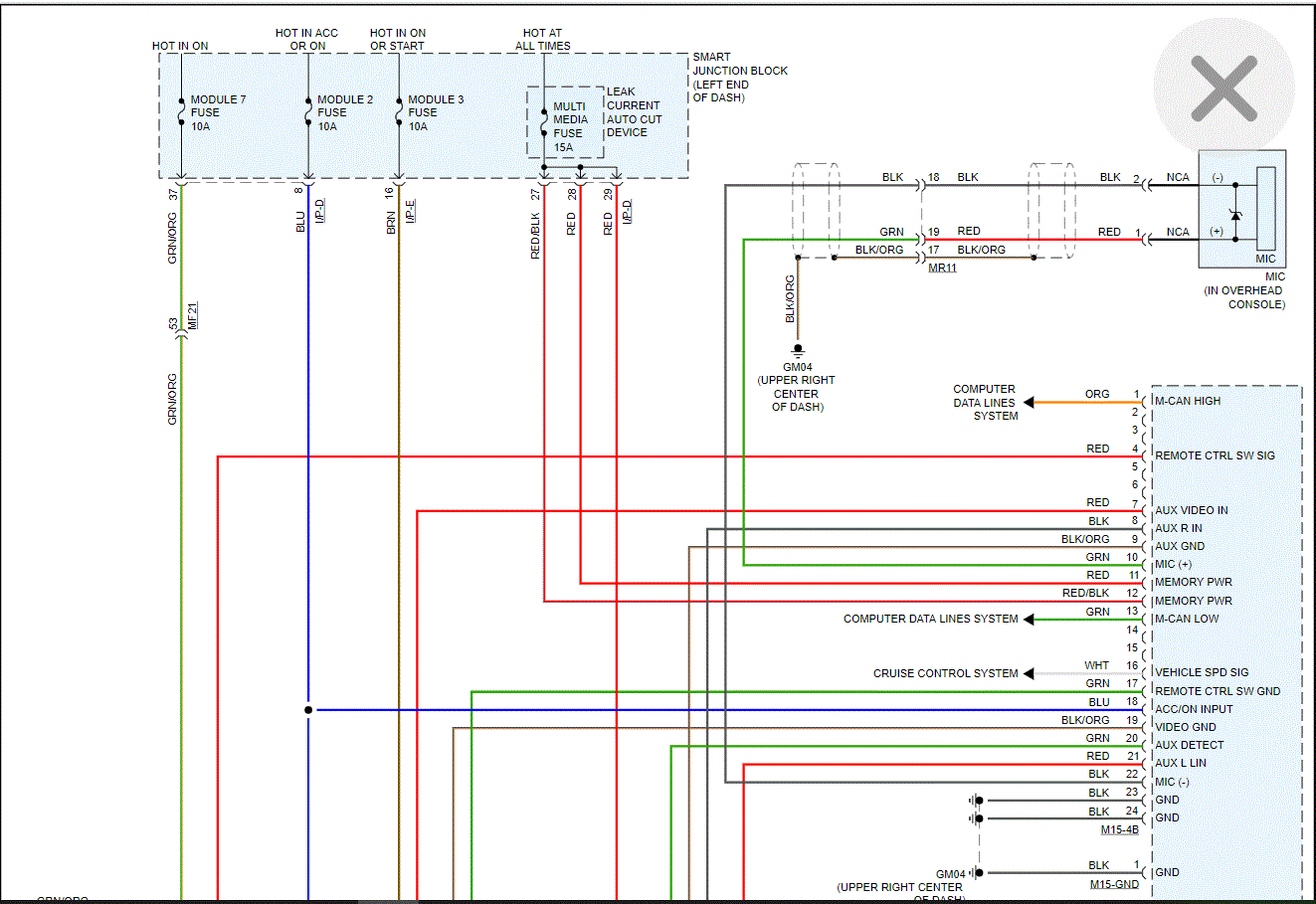

I had to cut the pics in half to make them readable. However, I did overlap them so you can follow from one to the next.
I hope this helps. Let me know if that was the wrong system
