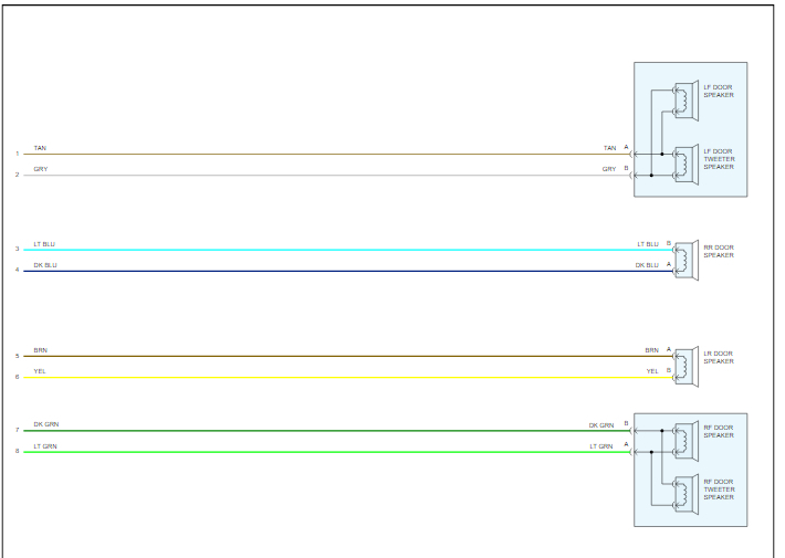

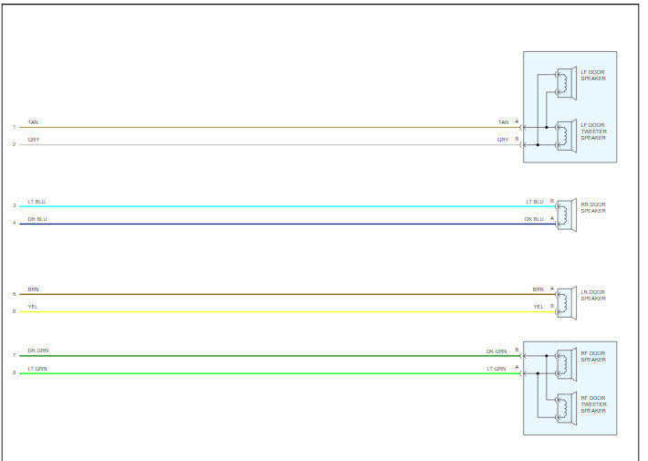

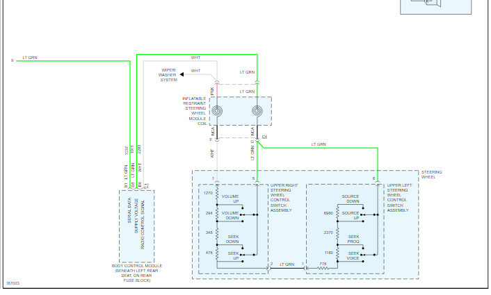

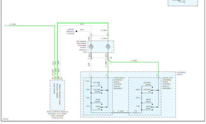

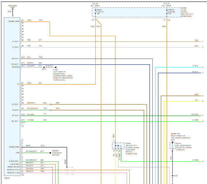

Trying to install replacement stereo but can’t find wiring diagram or color codes
Mar 29, 2020 at 10:22 AM

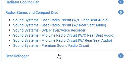

Please see the attachment. There are a number of options. Can you let us know which radio group you have and I will provide the complete diagram for it.
Thanks
Mar 29, 2020 at 10:42 AM
CHRIS3004
Where can I find the radio group?
Mar 29, 2020 at 10:57 AM
I am sorry. I did not attach the options. Take a look at these and see if any match what you have.
Mar 29, 2020 at 11:02 AM
CHRIS3004

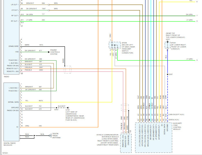

Base radio circuit with rear seat audio.
Mar 29, 2020 at 11:10 AM
DANNY L
  • 5,648 POSTS
Hello, I'm Danny.
Here is the stereo wiring diagram you requested. I've cut the 2 pictures in half so they can be viewed larger..Hope helps and thanks again for using 2CarPros.
