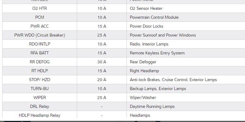

There is no power to the head unit I just installed and I do not know why.
Jul 15, 2018 at 5:45 AM
  • 110,241 POSTS

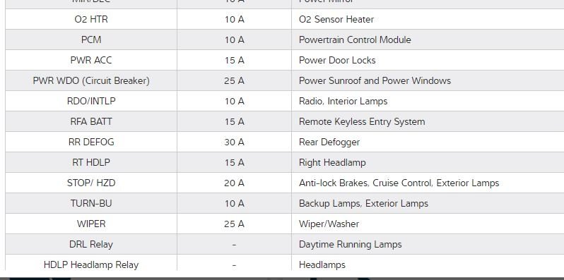

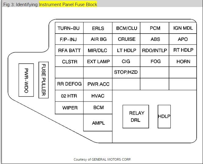

First, make sure the inline fuse which most likely came with the new unit is correctly installed and not blown. If it is good, then you need to check the radio fuse. I have attached a picture of the interior fuse box and a list of components. Check that fuse and let me know what you find. Also, make sure the radio is grounded. The fuse you need to locate is identified as RDO/INTLP.
Hope this helps.
