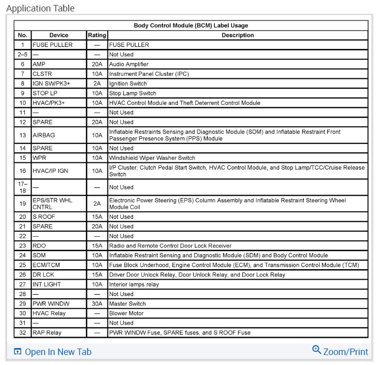

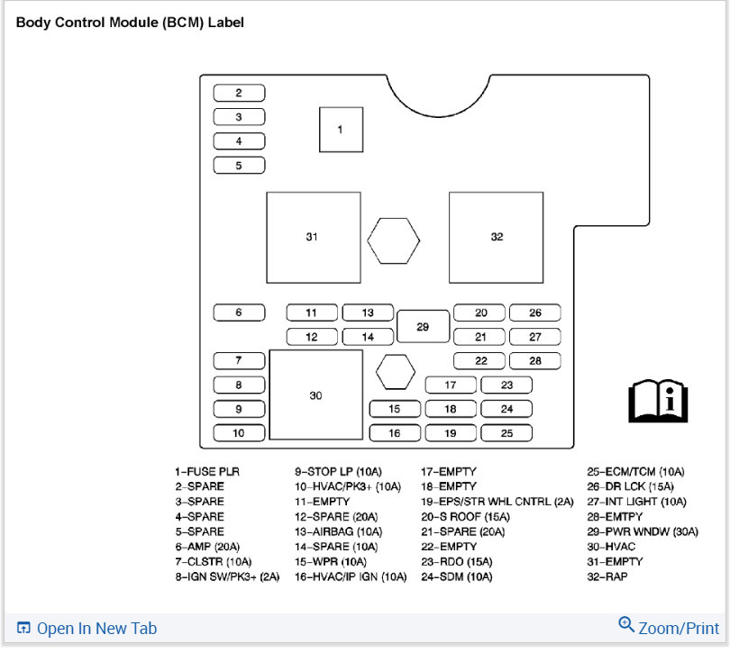

My battery died and when I got a jump start the stereo did not work after that. It does not turn on at all. I checked fuses and their all good. What is wrong with it and how can I fix it?
Dec 12, 2018 at 6:04 PM
  • 55,732 POSTS
It sounds like you had a voltage sure which popped the RDO fuse here is a guide to help you test the fuse and the fuse location in the diagrams below. The fuse is on the BCM module

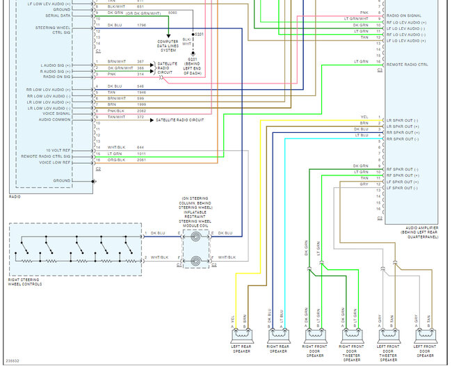

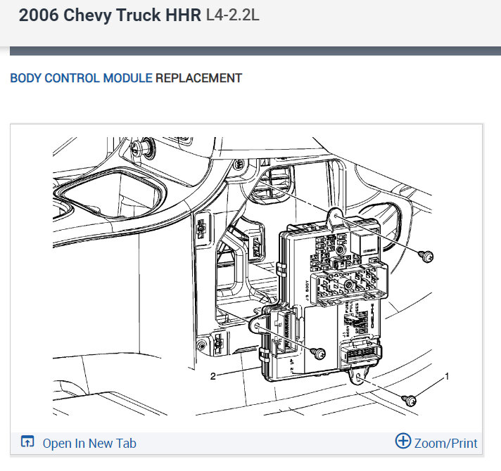

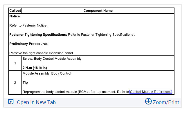

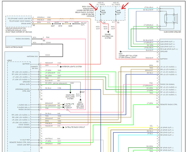

You need to check the RDO and AMP fuses, but it sounds like to me that the BCM is out, to be sure, let's do a CAN scan. You can get a CAN scanner (Controller Area Network) which will work on most cars from Amazon.
https://youtu.be/u-4syLc-ifQ
Here are the radio and amplifier wiring diagrams so you can see how the system works. Also, I have included how to swap out the BCM for a preprogrammed unit for easy installation. Check out the images (below). Please let us know what happens.
